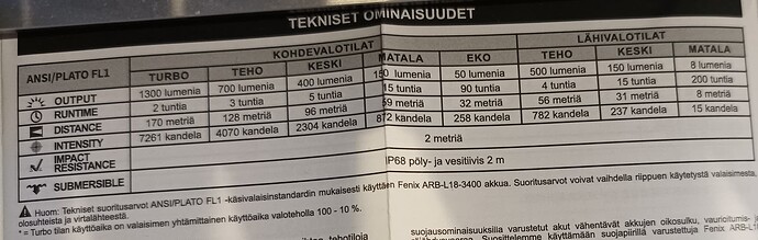

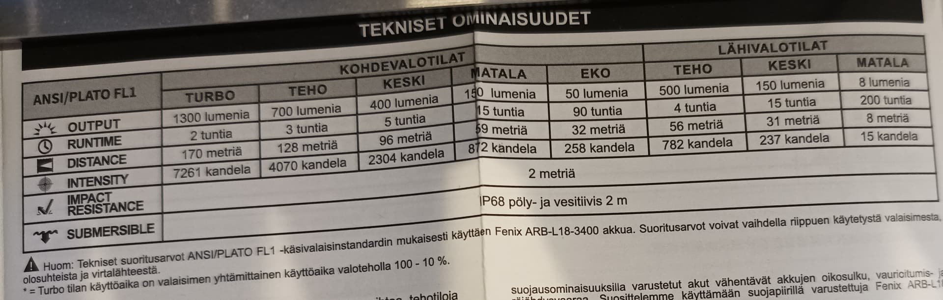

The Superraptor 2 has already arrived from Finland. Immediately I can tell that this is a much better light than the original: it has the rotating tightening system of the HM65R-T, but the strap is black with an anti-slip material on it. It also comes with an overhead strap, and both are removable.
Funny, the box and the instructions are only in Finnish. There are 5 levels for the spot beam and 3 for the flood. All are memorized after turn-off. The flood is much cooler white than on the HM65R-T.

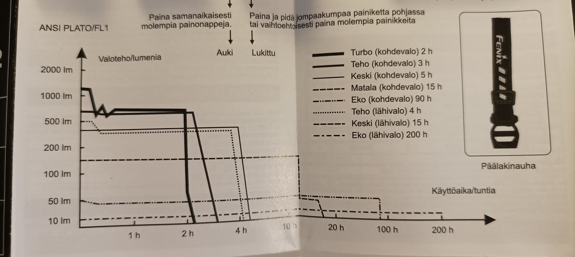

Based on the runtime graphs it looks like it can maintain around 700 lumens continuously. I will try to make measurements and compare all three.
Update: I’ve run some tests, but could only estimate actual output based on Lux measurements - (assuming that the second highest setting is 700 Lumens after 30 sec):
Turbo starts at 1235 (30s), decreases to 730 in six minutes and maintains it.
Second highest starts at 700, decreases to 555 in 10 minutes, very linearly and maintains it from there.
The instructions also say that it will decrease output once the temperature exceeds 65 celsius… Looks like reselecting the mode puts it back to max again, but I don’t want to accidentally damage the light.
