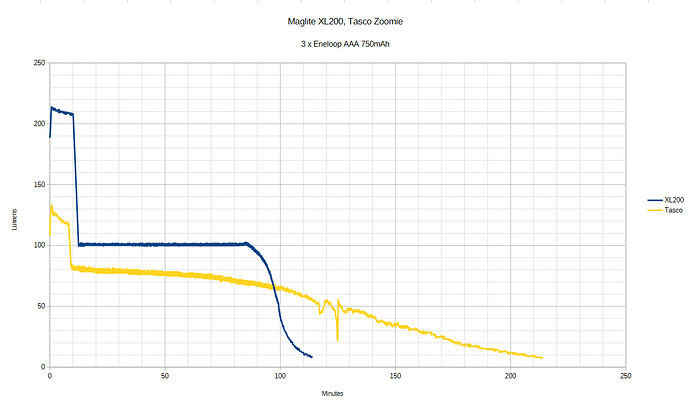

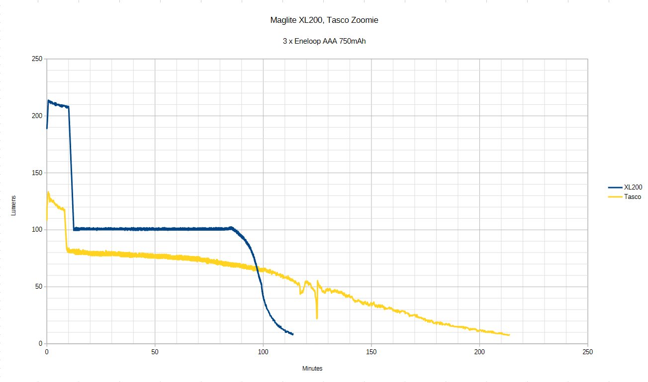

I have these lights so I may as well test them. The reason I say these were a pain to test is that both ramp up the output for like 30-60 seconds and then start falling off. I use the ceilingbounce app to record runtime, and I turn the light on in a Texas Ace lumen tube before the test so I can scale the recorded output. But when a light quickly changes output this becomes more difficult. Testing a light on turbo that drops off, usually just pulling one data point later after it stabilized is enough to feel confident in the graph scaling. I often do this near the end because just moving the light can change the ceilingbounce reading a bit. But a light that is always increasing or decreasing, it’s tougher. So the Tasco run likely has a wider margin of error than other tests I do. If the light was interesting enough to bother, basically doing two timed runs where I spot check several times with one run, and one where it isn’t moved would give more confidence. I sometimes do this with other lights, I might only record 20-30 minutes and I’ll spot check where the output had flattened out.
Anyway, here it is:

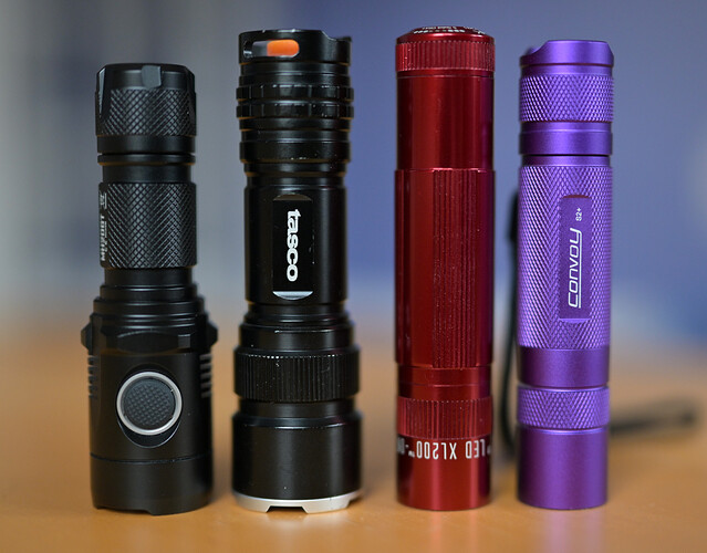

Because I’m sure Tasco has put their name on a wide variety of lights over the years, here’s a photo. Also it helps show how large these lights are relative to some 18650 lights that will have significantly more lumen-hours of runtime:
