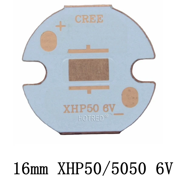

Grab some ∅16mm 5050 DTP boards and reflow your leds:
Warning: the ∅20mm 3535 board sold in the above ad is not DTP, or at least it wasn't many months ago. Thermoelectric separated ∅20mm copper boards here.
