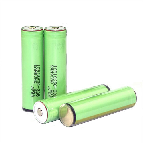

I bought from ebay seller “Samsung Protected ICR18650-30B 3000mAh” batteries. Two orders, first one (two batteries) just arrived today while I am still waiting for second one (four batteries) and something is telling me that those batteries aren’t protected.
I compared them with image of Samsung Protected ICR18650-30B 3000mAh from fastech and amazon (+ checked informative BLF thread: “How to see if a battery is protected”) and I can tell that mine which arrived today doesn’t have this yellow stripe from front to back or some other sign to be protected.
Also they are around same size as unprotected Panasonic NCR18650B 3400mAh and way smaller than protected Panasonic NCR18650B 3400mAh.
I don’t want to go and bother seller until I am 100% sure that he was the one who made mistake, so I would like to hear your advice, does those batteries look like protected to you:
Supposedly Protected Samsung ICR18650-30B compared to unprotected and protected Panasonic NCR18650B 3400mAh :
Image of proper protected Samsung ICR18650-30B as comparsion from Fastech:
I would appreciate if you would be able to let me know If I am wrong in my suspicion that those batteries aren’t protected.

Those 30B definitely do not have protection.

Most people don’t consider a vent to be protected, if they did every cylindrical lithium cell would be considered protected. Either way the ad posted by OP says PCB, and they are definitely not that.
Ultrafire and others do not cut the Anode when venting or overhearing, causing the battery to explode when short circuirt
@Lexel, but like Jensen567 said, those batteries above aren’t ICR18650-30B with PCB as advertised, correct?
Maybe I should link also image directly from ebay seller:
“Genuine Original Samsung Protected ICR18650-30B 3000mAh Li-ion PCB Battery”
and I got those:
Not exactly the same type of batteries as advertised above, right?
^ Yes. You got bare cells, whereas the upper picture clearly shows a modified cell with strip going from positive to negative, button top and PCB. The upper picture shows what is considered a protected cell, and the bare cells that you received (lower picture) are considered unprotected cells (although theoretically there may be a form of protection as mentioned above).
