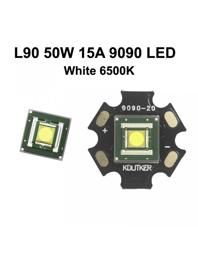

So anyway years ago i recall a user on here managing to fit a Generation 1 SBT90 (round die) led into a Jaxman Z1 it had a wonderful perfectly round circle beam…
I see now that many of these older Leds are just a few bucks now… I am wondering if anyone’s got any driver suggestions? ideally looking for a buck 2-3cell

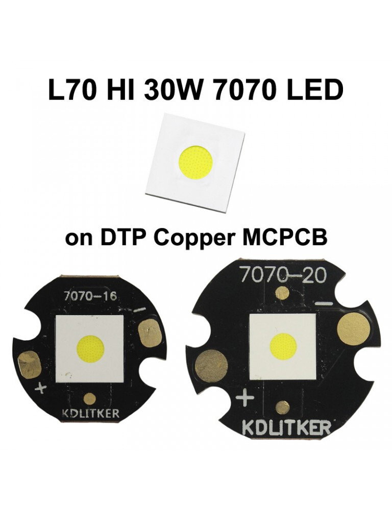

Have also just spotted the L70 HI are those any good?

These are not first-gen SBT90’s, but imitations that perform worse than the 2nd gen. For a good round throwy emitter to throw in a Z1, the SFT25R is hard to beat.
so these are fakes?
The Kaidomain round die emitters are imitations, yes, not the original SBT90’s. They still have ok performance though, but if you want maximum throw in a round die, SFT25R is currently pretty much the best emitter for this purpose.
thanks buddy, i just ordered a 5k one but i cant find the driver info is it 3v?
Both the L90 (imitation SBT90) and SFT25R are 3V. The SFT25R does well with 8A of current or below, the L90 can take a lot more (but in exchange heats up very quickly and goes through a battery in very little time).
