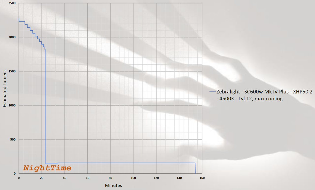

Level 12:
Note that the cooling was done with compressed air. This lamp manages heat well, but I really pushed a lot of air to be sure to eliminate this variable during the test. 2233 lumens for 5 minutes, then a gradual fading until reaching 1822 lumens at 23 min. After that the light produced 155 lumens for more than 2 hours.

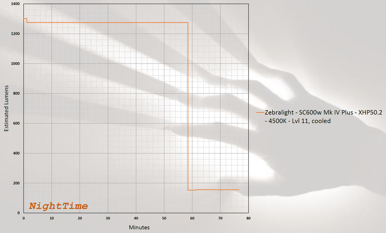

Level 11:
For Level 11, I reduced the air flow a lot as the light can handle the rest without activating the PID. I stopped the test after the first step down (~77 min). 1302 lumens for 1 min, then 1274 lumens for another 57 min. The last stretch started is about 155 lumens. **Update Jan 7th 2023: I ran the test a second time and the result was the same: there is a small step down at the beginning.

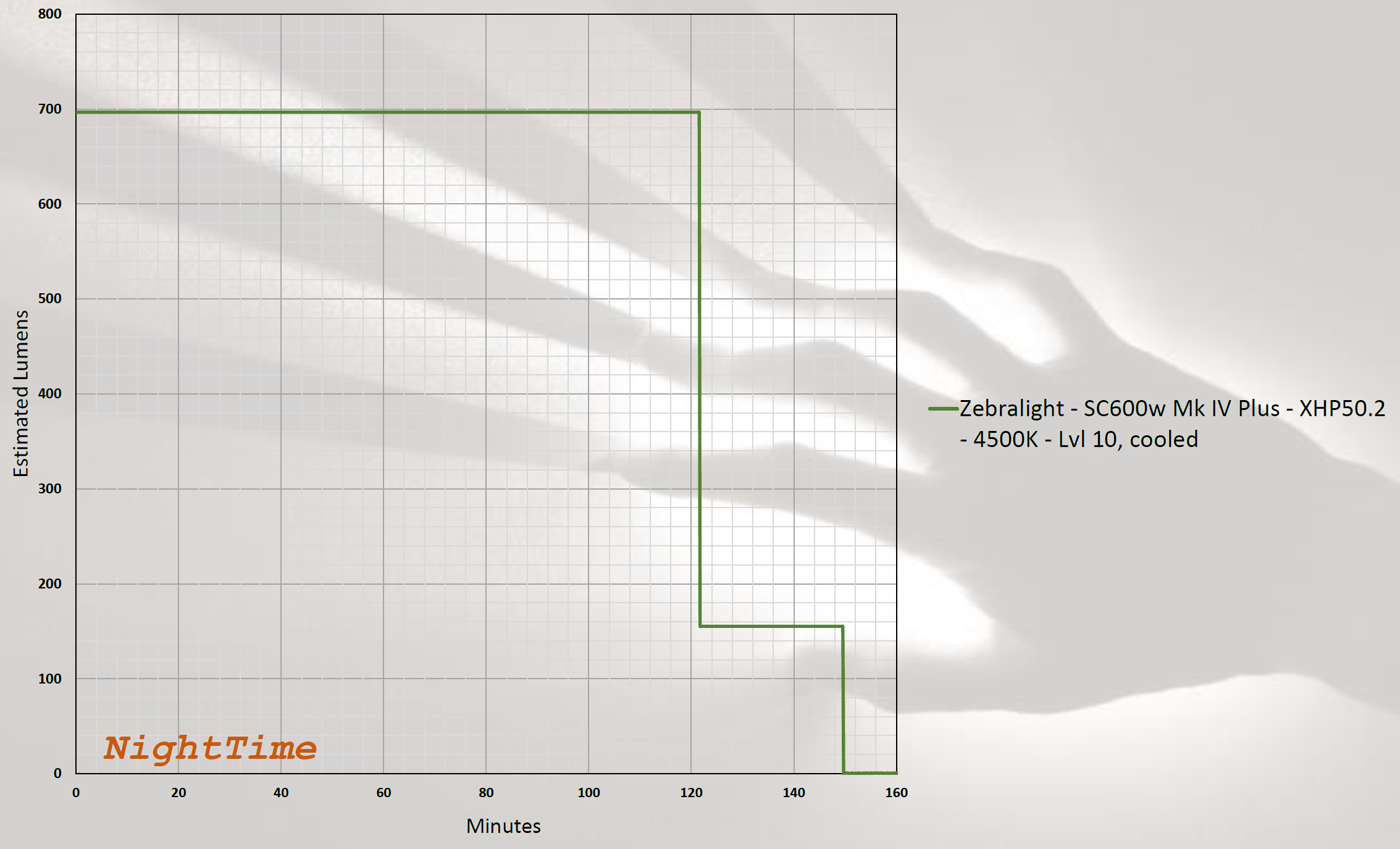

Level 10:
697 lumens for ~2 hours, then 155 lumens until 150 min mark.

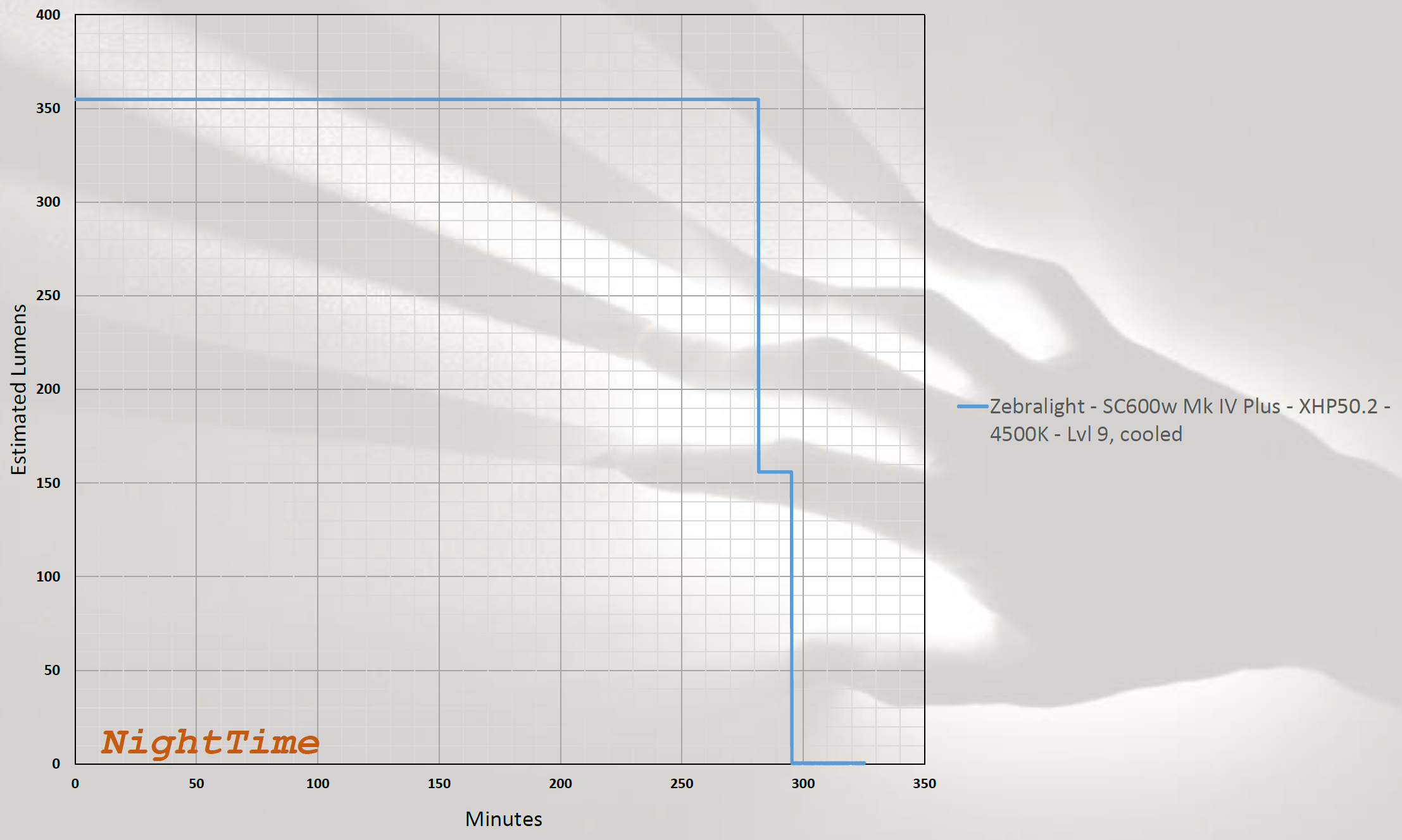

Level 09:
355 lumens for 4.7 hours (281 min), then 156 lumens until the 295th min.
