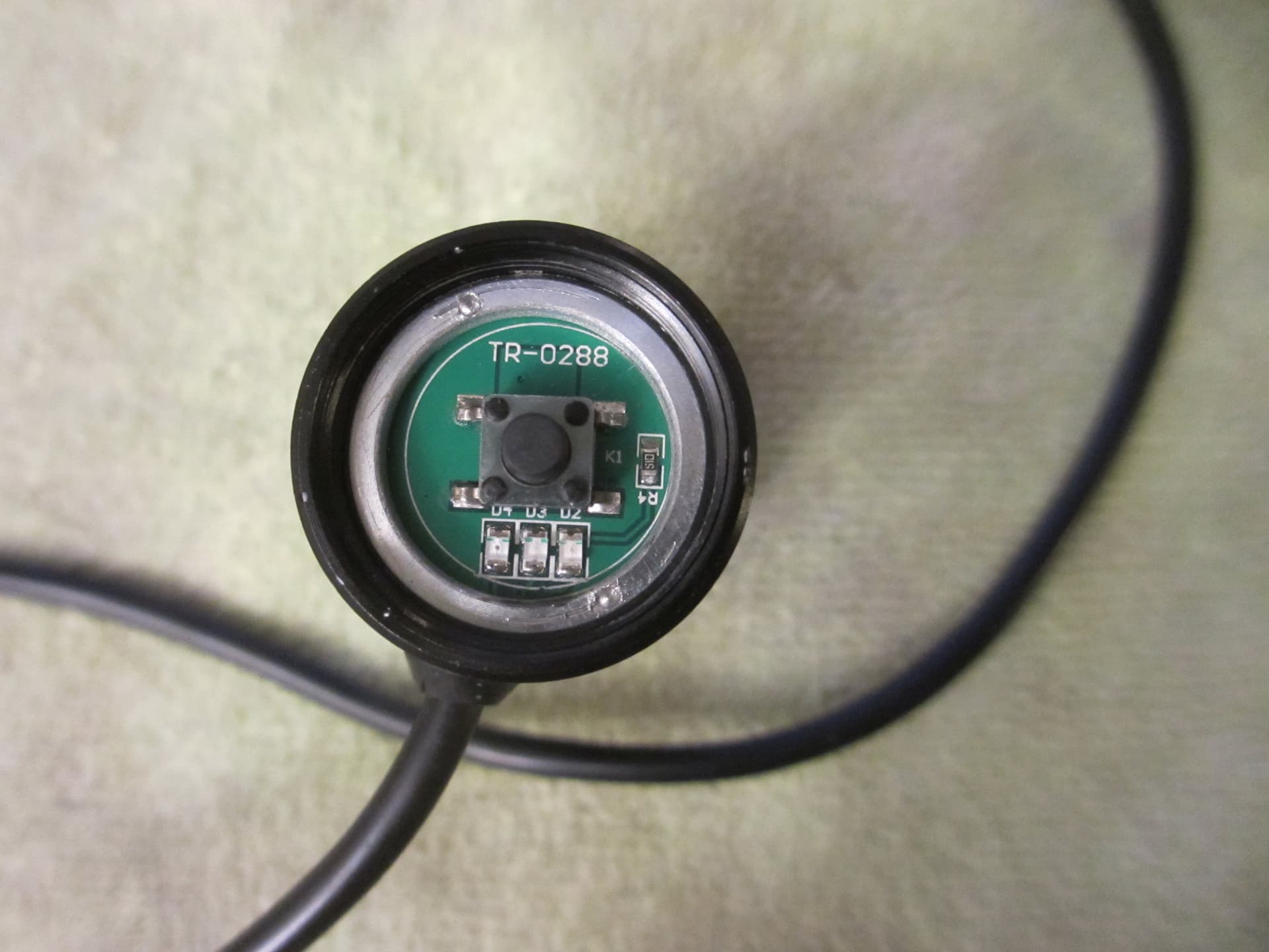

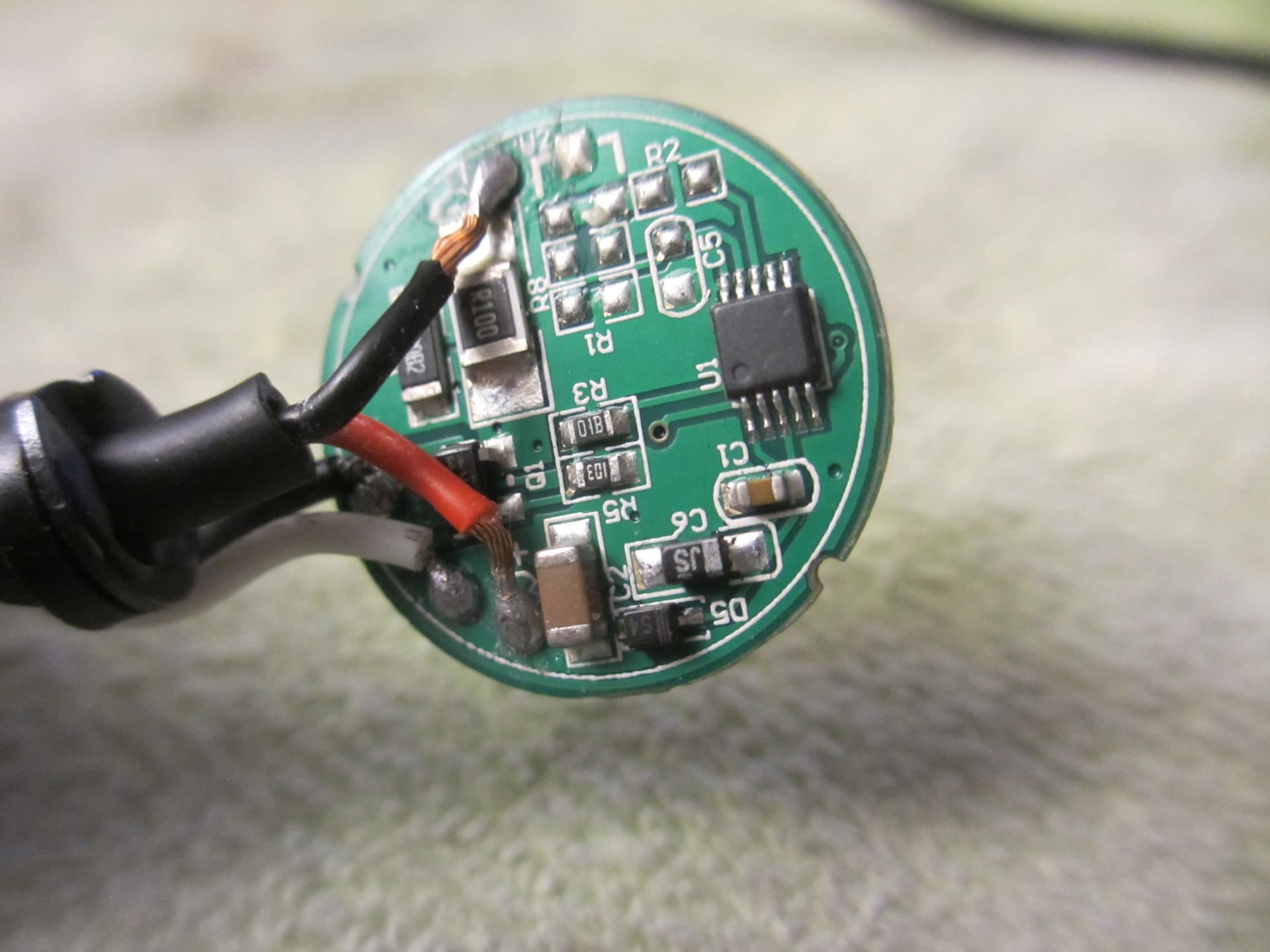

Do you have a picture of it?
Installed in the host, with switch facing back. D2, D3, D4 are battery status LEDs, which I do not care about.
The red/black pair from the battery pack, the white/black pair to the the LED
The switch is on the inside?
I’m confused, what does the switch do and wouldn’t the battery pack hit into the switch with a good bump/shake?
I took the button off to take the driver out because you asked for photos of it.
Oh, ok that makes sense.
I haven’t seen that sort of setup before.

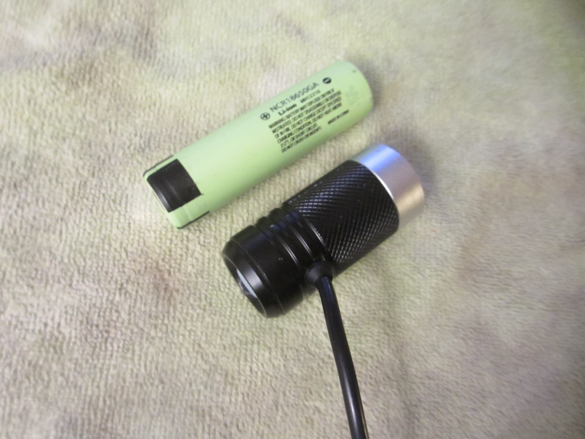

Perhaps you can add pictures of the light /host in a whole unit.

The host is small, but does have good thermal paths- the emitter is mounted directly to a solid divider so the whole host is basically one big pill. 18650 for scale.
