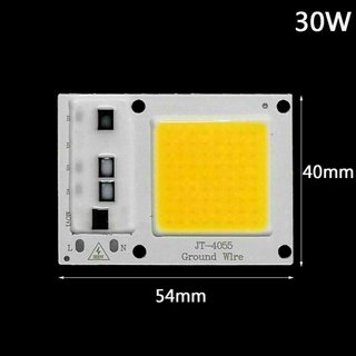

Look for one of the floodlights based on a chip-on-board LED array. You could even buy one and install it yourself in the existing light as long as you also use a fairly substantial heat sink. They are dirt cheap and come in various wattages. I bought a couple of 30W COBs just on a whim for $2 to see how they worked a few years back. They are bright but get hot as well.
Example 30 or 50W, 110V cool or warm white, $4.74 or $5.69 with free shipping from China
