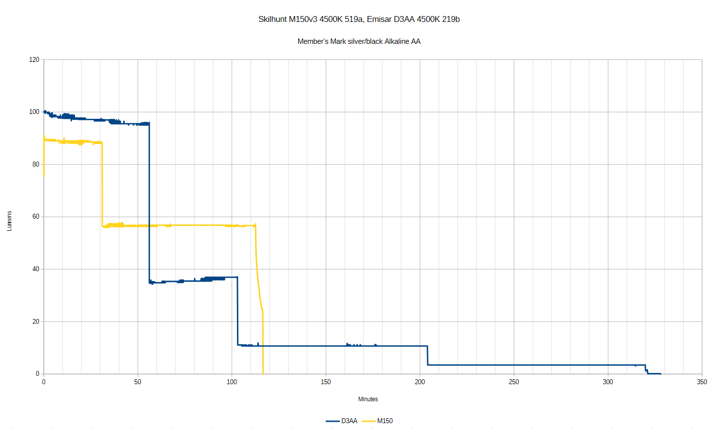

I’ve tested the high CRI AA lights that I have with alkalines, because I was curious how they do. Originally it started with the fact the Malkoff shipped with an alkaline battery I had no intention of using, so figured why not test it. And then when tested, my question becomes “is this performance good?”. Which meant testing more lights and also re-testing the Malkoff with a standard battery.
Sam’s club eventually changed the batteries they sell, and I no longer had any from the pack I used to test the earlier lights. So I’ve tested newer lights with a different battery, but I’m not inclined to go back and re-test the old ones. I did re-test the M150 just to have some kind of rosetta stone. I added a normalized/scaled graph at the end where I applied a factor to the runtime of lights, but it’s not real testing so it’s just a guess at how these lights compare.
Here’s the first batch, and it seems the older batteries had more capacity. They had a shorter advertised shelf life, so perhaps that is the trade-off (though it was 8 years vs 10 so not a big change):

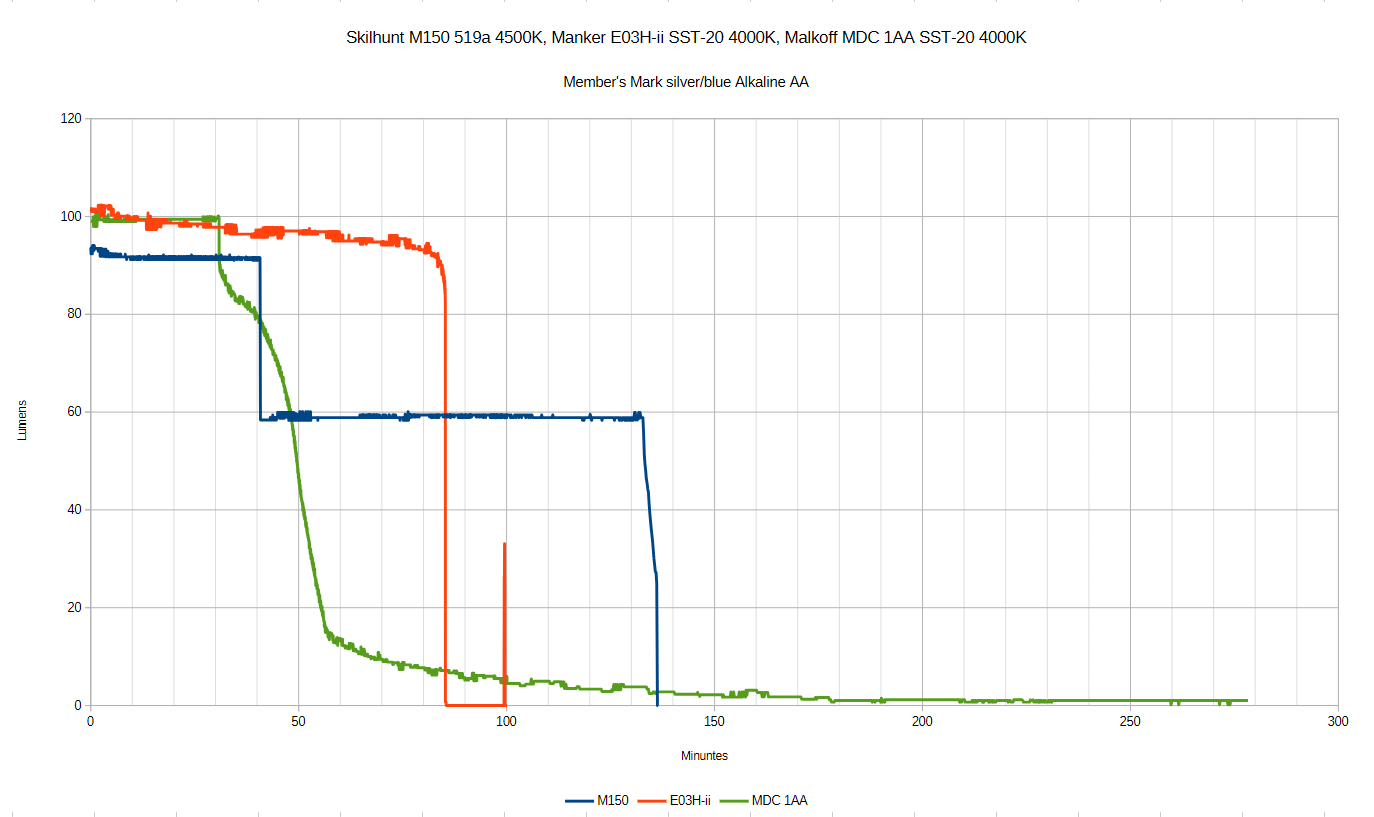

Here’s when I got a D3AA and wanted to compare it, but I no longer had the batteries:

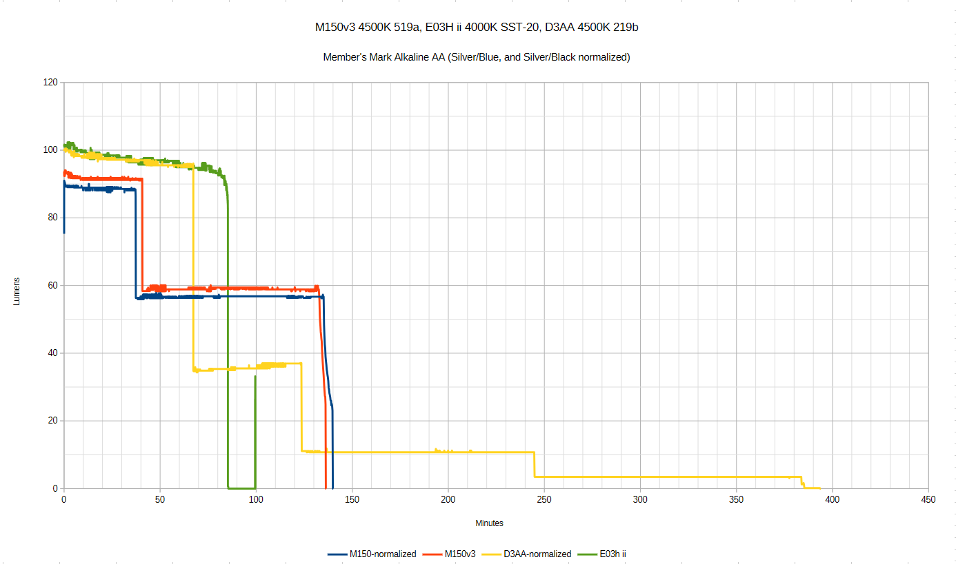

and here is an attempt to normalize the battery differences and make them all comparable (I ended up scaling the minutes by 1.2 or 20%). I didn’t bother putting the Malkoff in this because it’s extra work and didn’t seem worth it. It obviously has less runtime at >5 lumen level than the other lights:
The lights in some cases (Malkoff and E03 for sure, but I can’t recall on the D3AA) were still on, but not bright enough to register. I didn’t try to capture how long they provide “light” from a battery.
