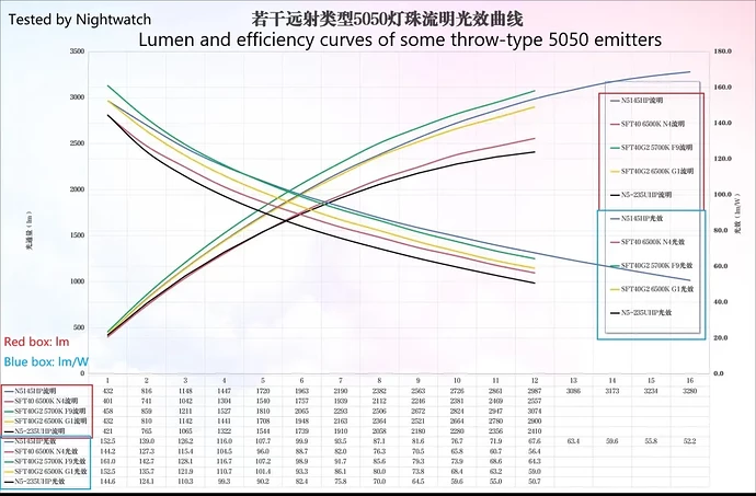

Share some test data from Nightwatch.
I wonder why these values are very low compared to my tests (for example: SFT-40 N4 6500 K @12 Amp = 2557 lm from Nightwatch vs. 3090 lm from my test). So keep this in mind, if comparing these.
It may be due to the difference in devices, and accuracy and calibration. As far as I know, Nightwatch has an integrating sphere, but I don’t know the size. Maybe the results will be different from lumen tubes and integrating spheres of different sizes.
And of course, no matter what, I think it is still meaningful to compare the data horizontally as long as the test is done under the same setup.
Since I have also a sphere I think this could be also the heatsink used. (Of course the accuracy is also a thing.)
Especially the different maximum current in the tests is noticeable in this regard.

I want to know what is the N5-235UHP? I want to get one to test, any info on what/where to get one?
N5-235 and other N-prefixed’s are Nightwatch’s custom emitters. N5-235 is basically 5050 version of Luminus SFT-25R. They are not currently available in the West, but may be available in the West someday along with Nightwatch flashlights.

What is odd about this test is the 6500K G1 measuring lower than the 5700K F9.
The 5700K F8 sample of SFT40G2 that I installed in an M21B with a Convoy 10A buck driver has great tint, but is not brighter than a Gen1.
I have a 5000K G1 on the way. I hope it is better.

Yes, it is indeed odd, it may be due to individual sample differences.
