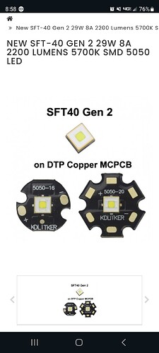

SFT40 Gen 2?
6 Thanks
Nothing official from Luminus.
That seems normal, because Luminus often releases some products to market for beta testing before putting them on the official site.
Most likely just a slightly more powerful version with just a better flux bin. Marketing!
There usually has some physical changes between each revision and it doesn’t look physically any different to the original.
