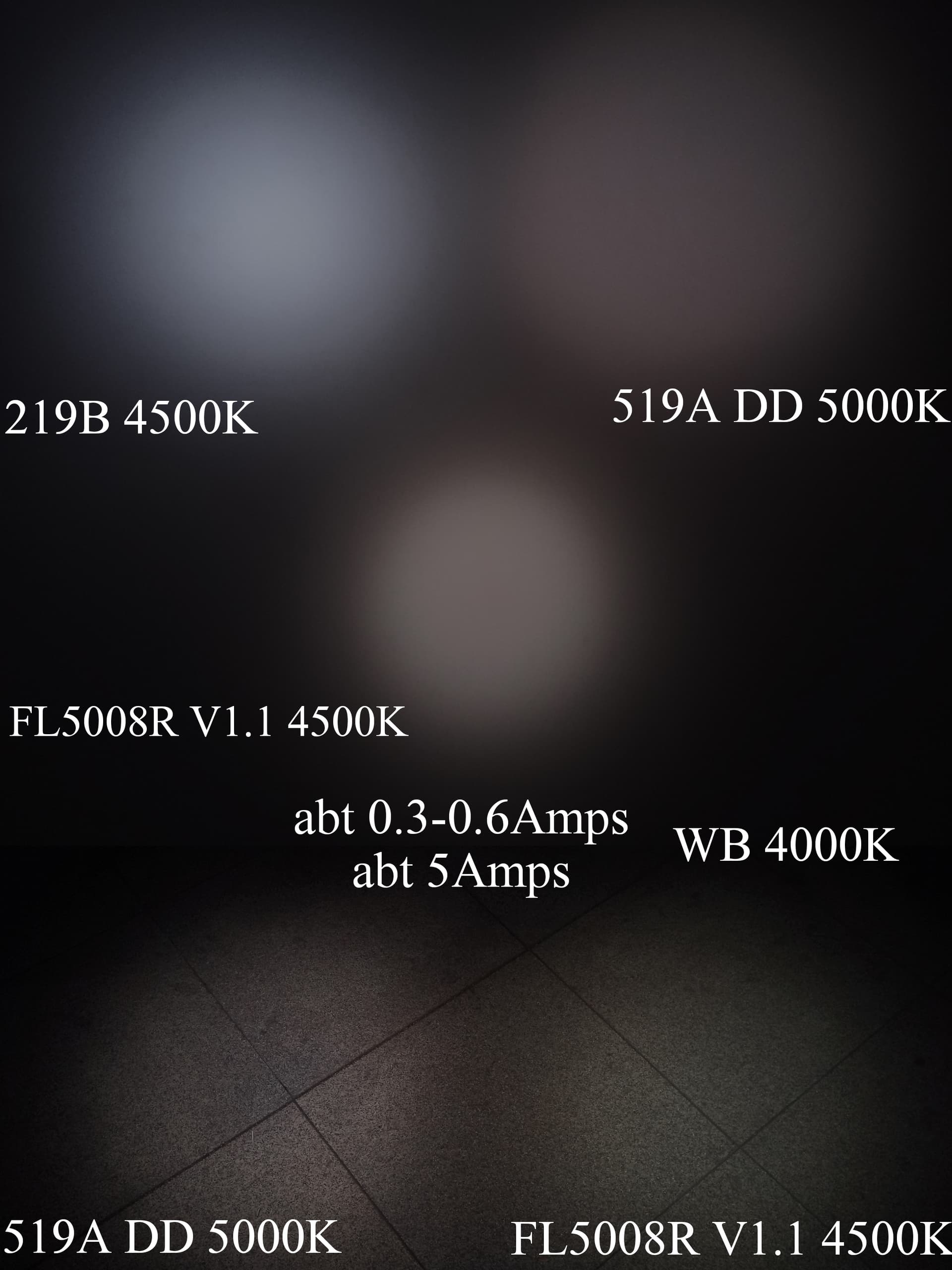

Another brief comparison, almost the same, though the 219b will be much pinker than the Custom in other scenarios with white walls.

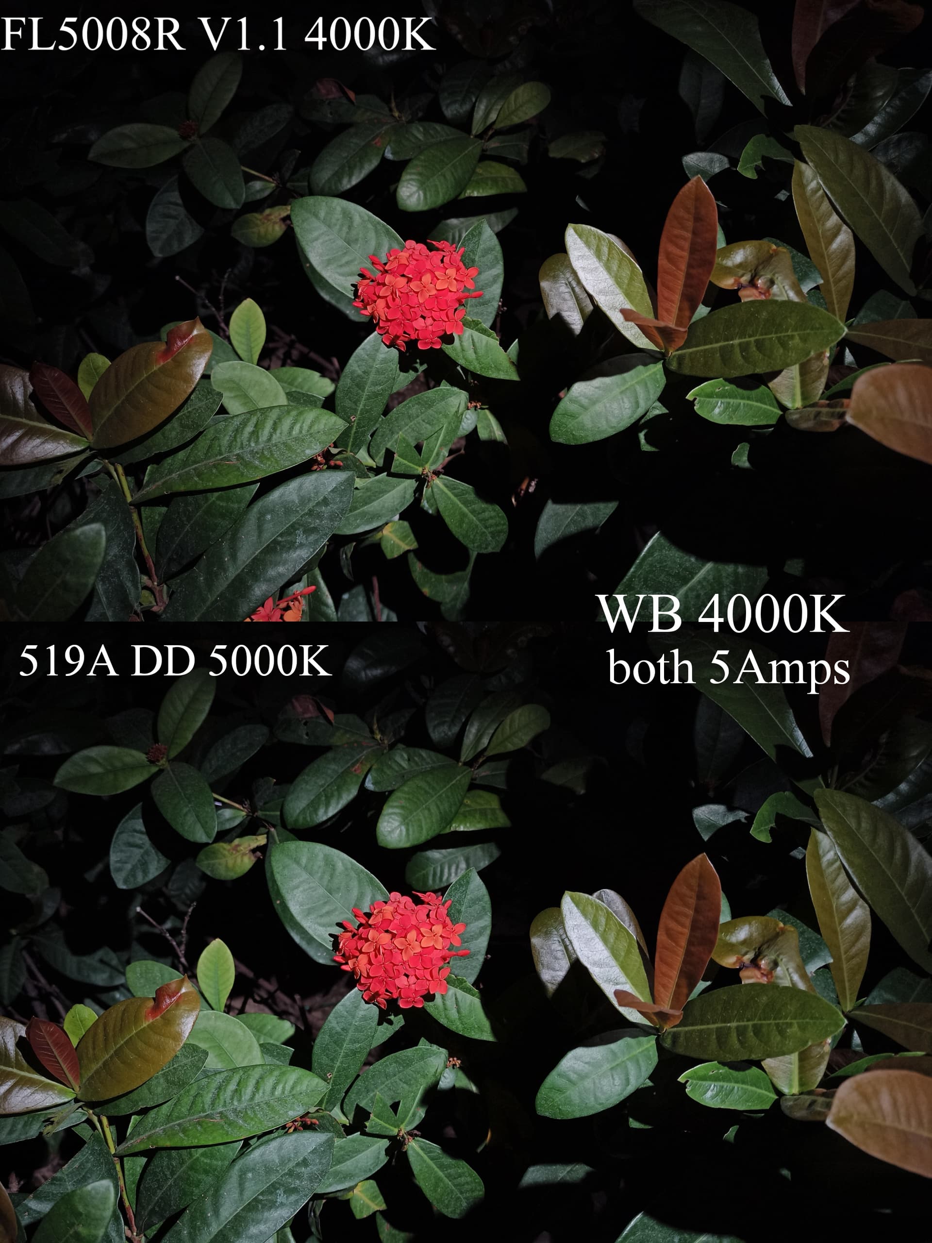

The main thing that caught my attention is the comparison between the 519A and the custom emitter, looking at the green leaf on the upper-right corner of each photo. It seems that the custom emitter does much better at rendering the dark green compared to 519A and 219B, much closer to daylight. Usually blue LEDs fail at this because of a gap in the cyan region in the spectrum.
Indeed, looking at the spectrum tests on the Baidu forum, the cyan gap is much less pronounced than 519A, and the R12 (deep blue) reaches 89, while most LEDs at this CCT, including 519A, tend to have R12 below 80.

Forgot to ask: in person, is the difference in dark green rendering (between 519A and new LED) as pronounced as it seems on camera?
Also: why are the red flowers “blown out” toward the right on the 519A photos? Were they just overexposed, or is there a color rendering problem? Sometimes I find blue-pumped LEDs to give a grey cast over everything due to the blue spike.
They look somewhat oversaturated to me. The gamut index Rg of these custom emitters seems to be really high, maybe over 100 or so (the FFL909A 9V I tested earlier was at 107 which is extremely high).
I think it’s likely just overexposure and brightness differences, or an issue with my phone.
It’s hard to redo a comparison because I swapped emitters on the same flashlight in succession.
Perhaps somehow this picture is misleading. After all, subtle Ra R9 DUV differences would have been difficult for the camera to capture, and would have been more affected by other factors.

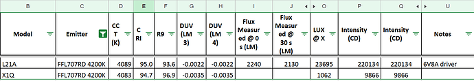

Here is the test of the FL5009R sample.
Good efficiency, good tint, standard footprint, just some minor problems with the beam (SMO only).

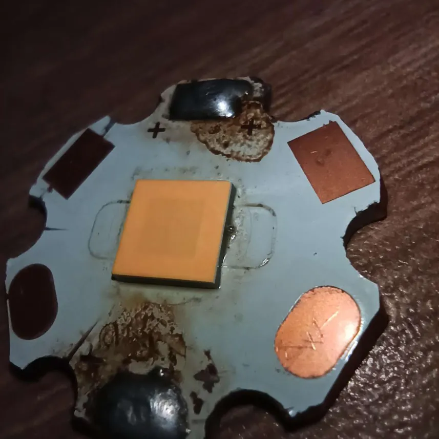

FL5008R V1.1, I think I took an L
Decent at low, but terrible at high, actually, super green to me when shone to the ground, but not so obvious when shone to plant.
edit: added emitter pics, smaller die gap indeed, but tint shift is terrible.
and btw, these had been sold out for two weeks when I got them.
To be fair, the dedomed 519A is super pink and will make neutral emitters look green in comparison, especially if driven at high current. Do you happen to have spectral measurements?
Interestingly, some emitters (e.g., 219C, LH351D) turn greenish at high currents, while most (including 519A) turn pink due to the blue spike. Must be a property of the phosphor mixture–perhaps the particular type of green phosphor saturates slower than red.
I don’t, but to me it certainly looks too green to have ever seen before.
As far as I can remember, it’s definitely greener than 4000K LH351D, but yes, my LH351D probably won a tint lottery.
