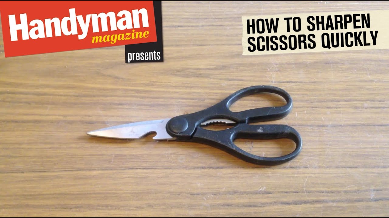

I heard that one can sharpen scissors by cutting through aluminum foil. Has anyone used this method and does it work? I tried it out with my little swiss knife scissors and it seems to be sharper. Just wondering if there’s a better-preferred method when it comes to sharpening scissors?

I don’t know where you heard that. You may not be fully understanding how Google works. There is no material out there that you can cut with scissors that is going to sharpen them. Your scissors may appear shinier but they are definitely not sharper after cutting aluminum foil.
Yeah, it didn’t seem to be that sharp the last time I tried cutting foil. I thought the foil trick was well known? I saw the foil trick a while back online and even now if you search there are lots of articles and videos about this foil trick. I think what they are trying to put across is to use foil if you are in a bind and have nothing else around maybe? Either way, I always go back to using stones or EDC ones. ![]()
