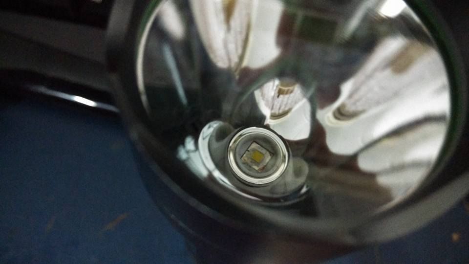

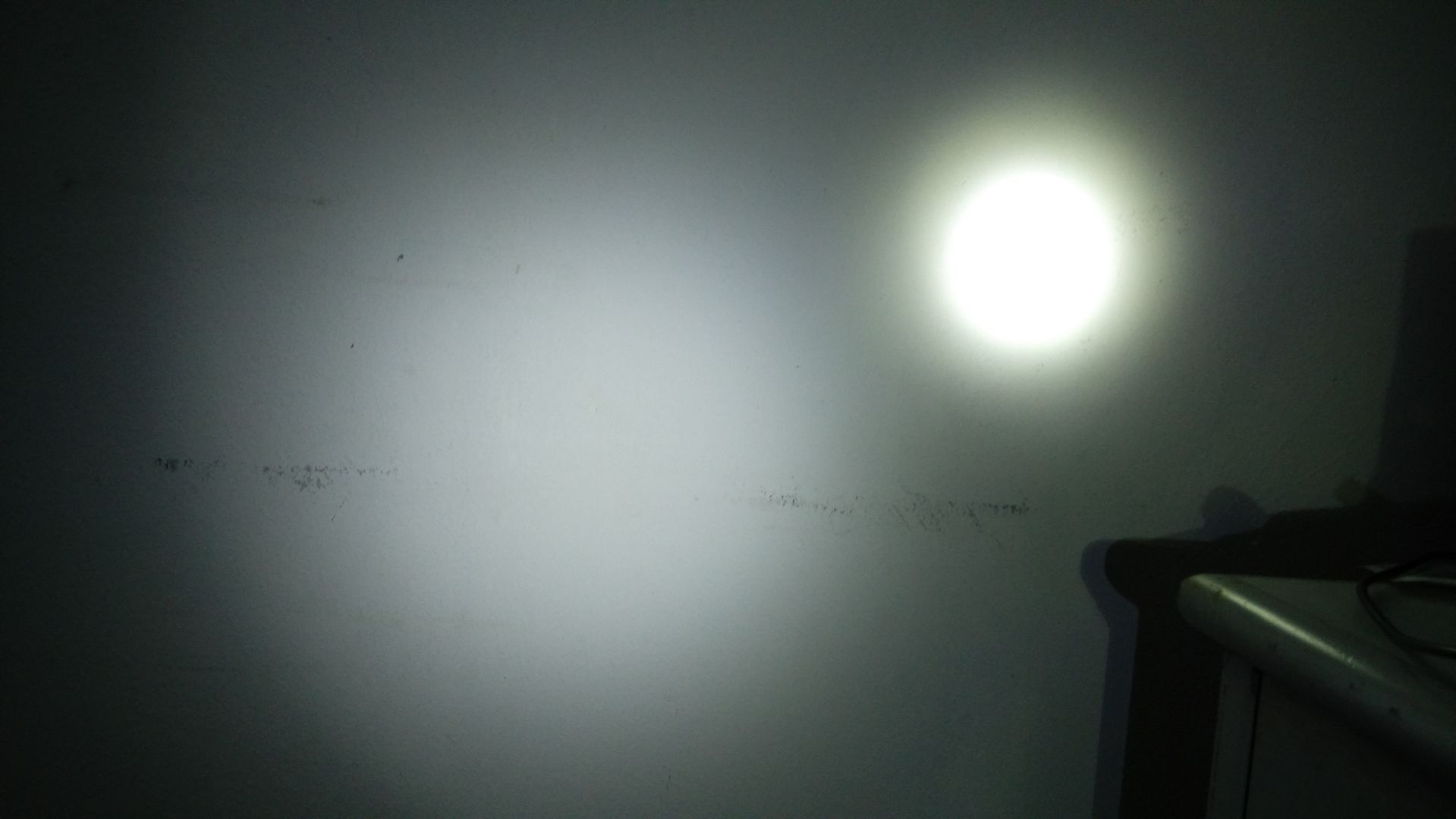

Thanks for the encouragement. I’m liking my dedomed 1A tint now. Still need to clean up the silicone a little to get a nicer beam but I’ll leave it there for the bond wires and deal with the imperfections. The spot is much tighter now :smiley:
Daylight white balance
left is stock 1A on Convoy S2+
right is dedomed 1A on Convoy C8
Did you notice the tint change at all or very much?
tint change is always very obvious in most of my dedomes I’ve tried (as well as many others from other modders)
In this case of XML2 U2 1A tint it transformed from slight purple blue day white to a guitar cream white with a very slight green hue

Don’t rush like me or you’ll get messy dedome which can alter tints if you accidentally peel the phosphor.
I kinda had a tiny bald spot in my LED from cleaning up the mess as the dome didn’t pry out all the way. Some silicone got stuck in the middle.
It’s unnoticeable but it bugs me knowing I did my mistake lol
