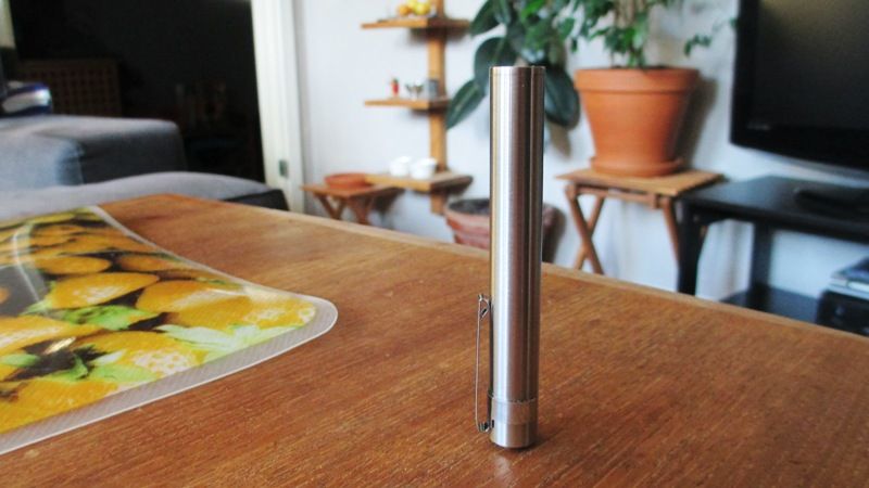

The body of the flashlight is stainless steel and it is amazing my light had no blemishes or marks on it at all this Brings a tear to my eye! Wow we can actually buy a flashlight made this good. I will add the clip is a little flimsy it bends easy but only at the half way point nothing major it still holds the light in place. The Nichia LED is well placed in the center of the reflector Singfire done a much better job on this light then astrolux done on the A01 at placing the LED inline. Being a full stainless body it does have the problem of dissipating heat so it does get warmer than an anodized flashlight of the same size and power. I believe the flashlight has a heat management system so that shouldn’t be a major problem the light steps down when it gets to hot and ramps back up when the light cools down.
So far i have been using my light for a week and the stainless is holding up really well still no marks on the light what so ever. what ever they done it works.
