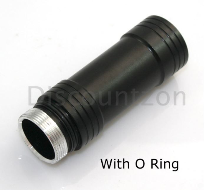

In my search for a HD2010 extension tube I ordered this a while ago.
26650 Extension Tube
No dimensions or compatibilty listed on the site so it was always going to be a shot in the dark, but it was cheap and I was feeling lucky.
Of course it’s not even remotely the right size to fit a HD2010 but maybe it fits something else.
So here are the dimensions. Maybe it’s useful to someone.
O/D On Knurling: 32.57mm
O/D on grooves: Min 30mm Max 31.3mm
O-ring Groove: 28.3mm
I/D: 27.2mm
Length:75.55mm
Threaded section: ~6mm
Thread Diameter: Inner 28.9mm / Outer 29.8mm
Thread Cut: Triangular
Thread Pitch: 1.2mm Measured from thread tip to tip (not sure if this is the most useful way to measure this)
