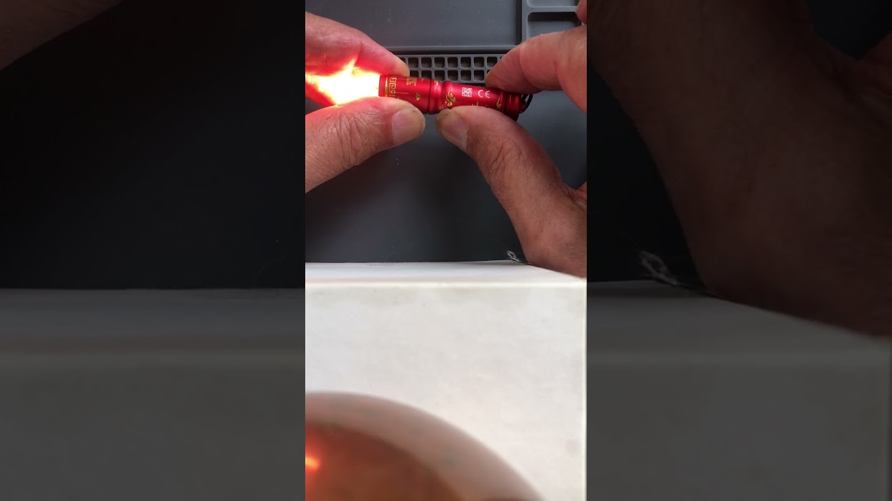

If twisty lights are not unscrewed far enough, they can turn on in pocket…
here is an i3e video, showing how side pressure that cocks the head, can make contact w the body tube and turn on the light:
Here is a Fenix E01, its head rocks so easily, simply rolling the light on a table will turn it on and off:
Here is the Sofirn C01 doing the same thing (same driver and contacts design as the E01):
For these reasons, it is important to unscrew the head of a twisty far enough, about 1/4 turn, to prevent side pressure from turning on the light.

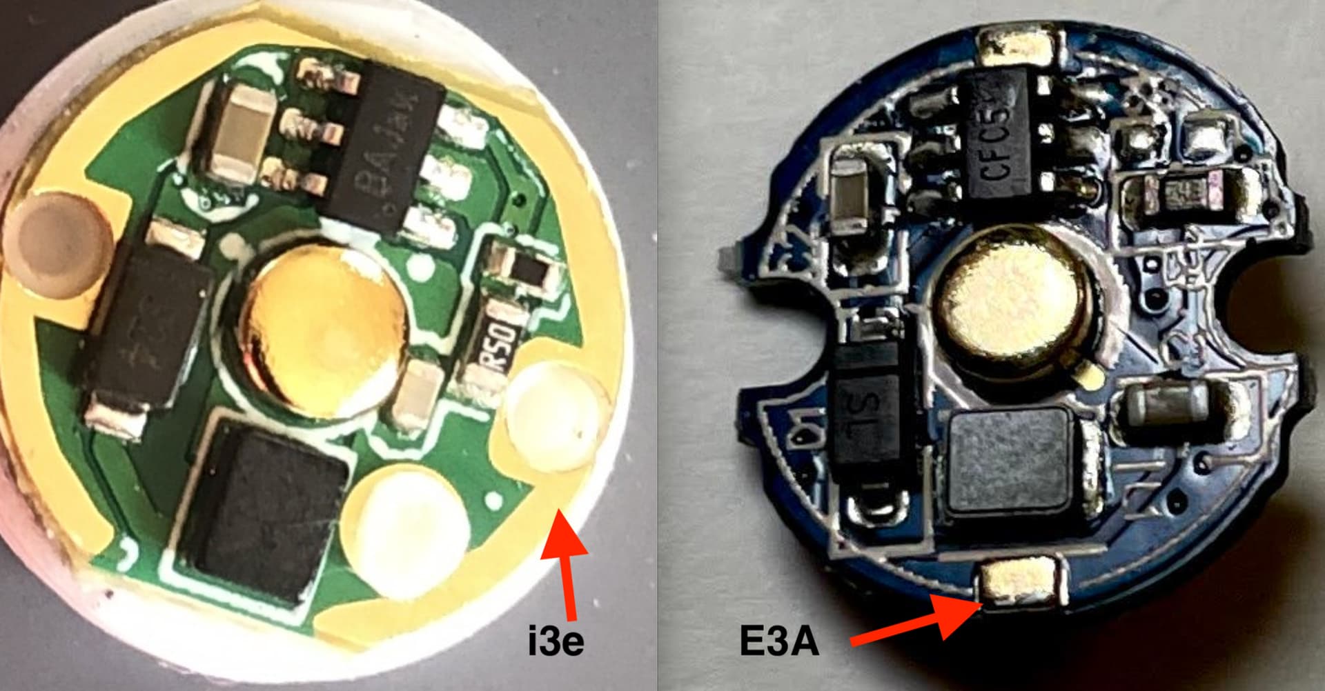

I dont think there is a difference in sturdyness. Both designs reportedly work very well, based on peoples comments.
On the olight, the body tube makes contact with a ring around the outside perimeter of the Driver.
The Skilhunt uses two contact blocks:

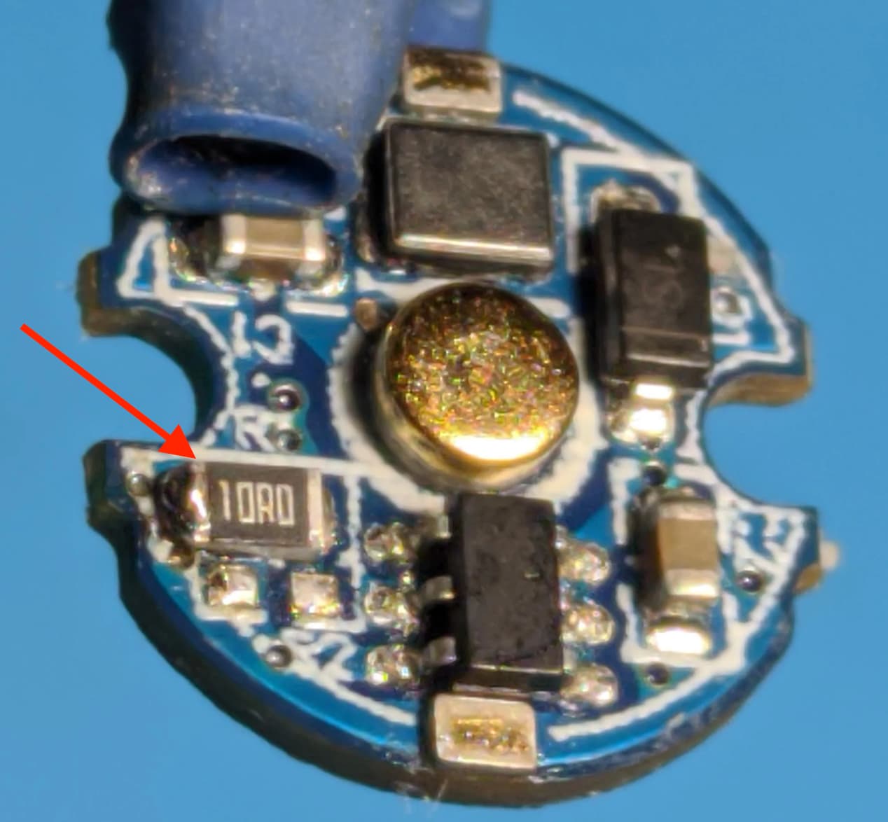

some modding info to reduce output on E3A:
"Output current set by current sense resistor, 0603 SMD size (0805 can be fitted to by my experience). Default value is 0.43 Ohm, corresponds to ~220 mA LED current, according to datasheet formula.
Replacing default current sense R with 10 Ohm reduced LED current to ~9.5 mA, and LED output to ~5 lumens for ~34 hours!"
