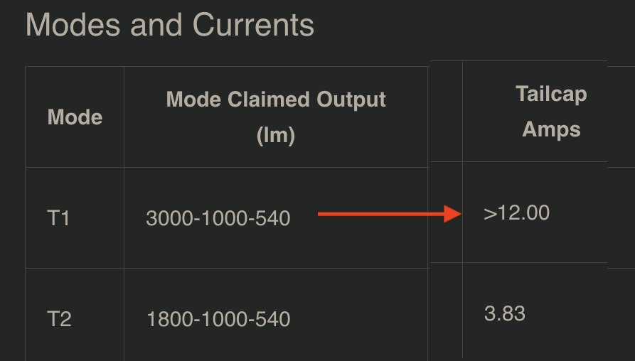

I wonder if some USB-C 21700 might be short enough to fit?
This could bypass the need to rely on the proprietary magnetic charging cable.
The BL-250 that it lists as an option is listed as 76mm long.
That Keeppower you linked in 76.8mm but Acebeam and Fenix seem to be closer to 76 even.
With button top the included 21700 is 75 mm long. Since there is some room with the springs I think 76 or even 77 mm shouldn’t be a problem. The bigger issue is likely the current the light draws.
yes, T1 would exceed the 10A CDR of the USB battery.
zeroair tested the current:
T2 would not be a problem..
