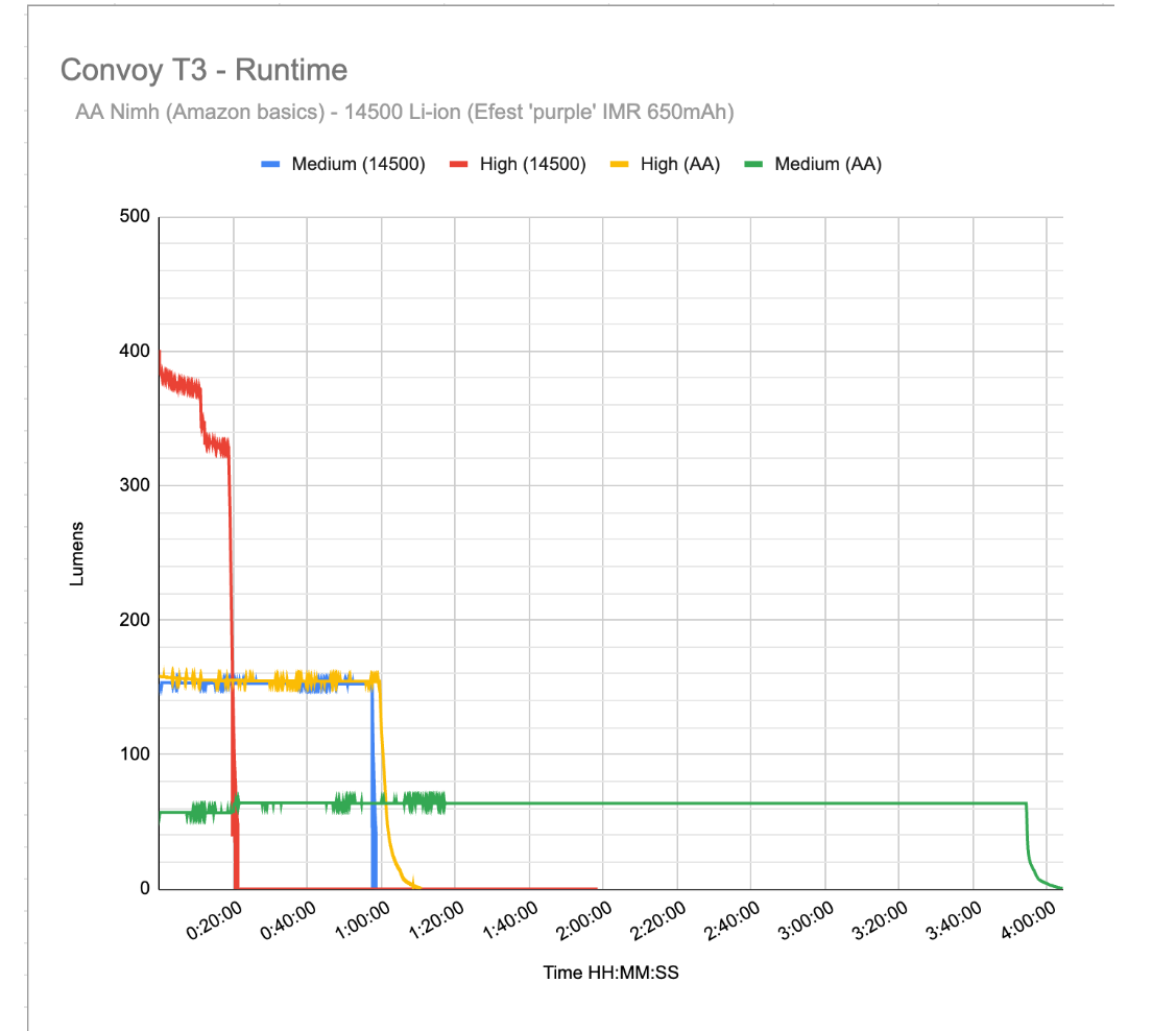

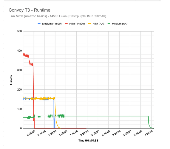

Convoy T3 can sustain 150 lumen for 1h. We also need to normalize for nimh element capacity since some use 1900mah like element and some high capacity like eneloop pro.

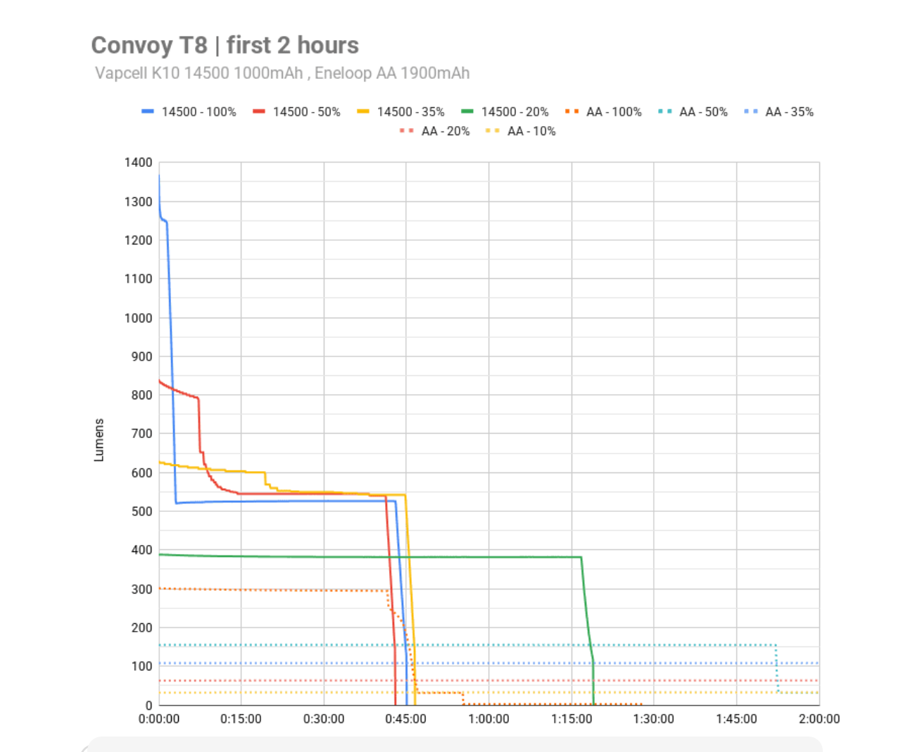

And T8 with SFT 25? can sustain 300 lumen for 40 min:

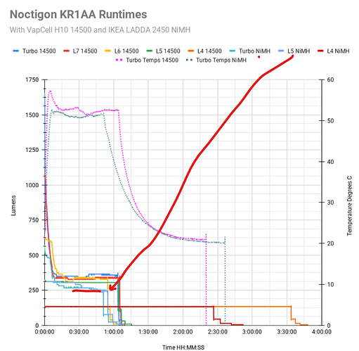

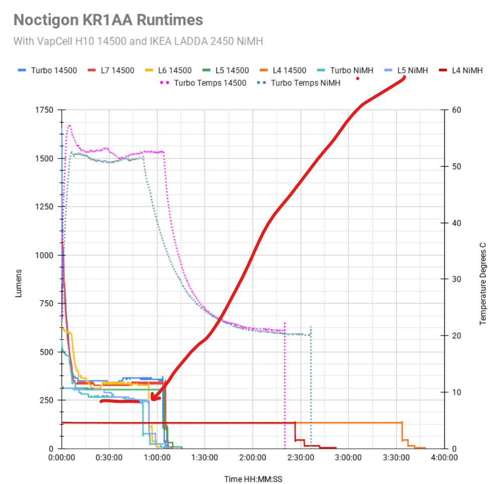

@jon_slider If I read the graph correctly L5 NiMH is 250 lumen for 50 minutes which is on par with D3AA
good point..
agree, thanks for pointing that out
I only did not use it because the line is not flat regulated (some of the 1lumen charts are so cluttered they just make my brain fuzzy.. lol)
What we see from D3AA and KR1AA shows that for NIMH the mainstream manufactures lag in efficiency since in system with battery, driver and led the only difference between D3AA/KR1AA and rest of the pack is driver. The LEDs and battery are more or less the same between them.
Convoy T8 can sustain 300 lumen with SFT25R albeit with driver with efficiency which looks to be something like 50 - 60% with current consumption around 4A. I measured 3.7A with fresh eneloop pro in mine T6 at 100%. And yes T8 is like 18650 light in size which happen to be powered by AA element.
It is a good question why freeman driver can push 85% efficiency with NIMH and other mainstream manufactures produce drivers with what looks like 50%/60% most and even zebra appears lag behind 150 lumen for 1h is 25% less than 200 lumen for 1h :slight_smile:

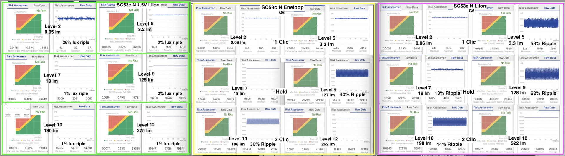

correct, that is my experience.. PID is not listed and my Zebralight SC53c N got up to 65C after 20 minutes on level 12 using 1.5V LiIon. I dont normally run the High mode that long, I only did it for a test.
There is normally no need for thermal management on a light running AA batteries.. the output is usually too low for heat to be an issue. But 1.5V are a special case.
according to this youtube, the 1.5V LiIon gets up to 60C (because of the Voltage converter), when using 2A output for 5 minutes (this is only an issue in the SC53 on level 12, aka H1):
I still like to use 1.5V LiIon in my dual fuel capable SC53 because it has almost no Lux Riple (green box on left). LiIon has the most Riple (red box on right), although not visible to the naked eye because the frequency is very fast:

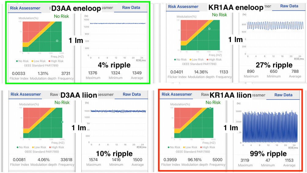

otoh, the thermal management is so good in the D3AA and KR1AA, that they wont let the light go above 150 lumens when using 1.5V LiIon.. because the sensor recognizes the hot transformer and steps down.. in fact the D3AA steps down below 100 lumens.. it notices the battery heat even more than the KR1AA does. So I dont use 1.5V LiIon in the Emisars.
fwiw the D3AA has less Riple than the KR1AA, and both have less Riple on AA than on 14500:

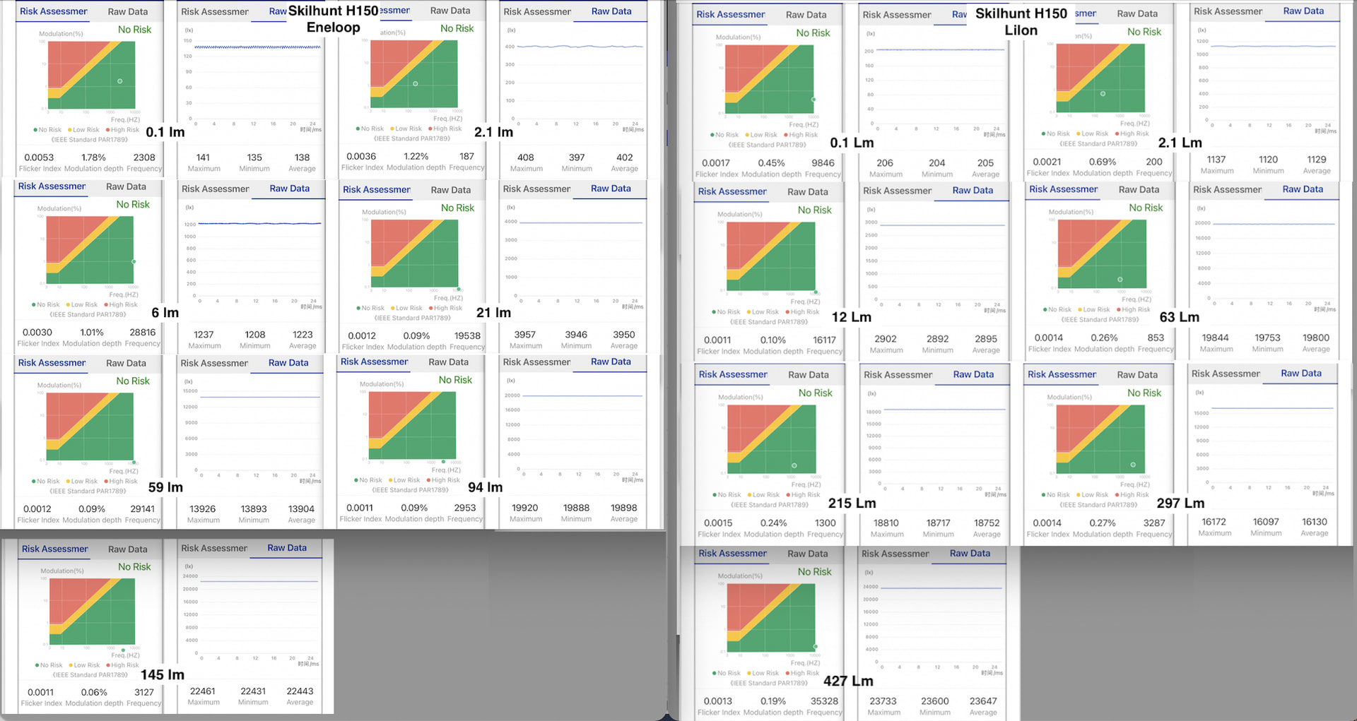

btw, my Skilhunt H150 does not have Any significant Riple, regardless of battery type:
the stable Lux is one of my favorite features of the Skilhunt Driver. otoh, I dont really like that the outputs on AA are very different than the outputs on LiIon.

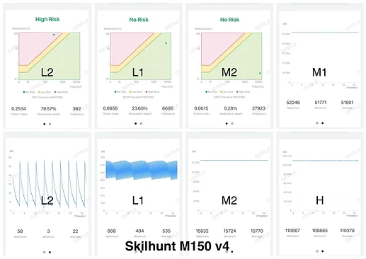

fwiw, the Skilhunt M150V4 is not as clean in terms of the Flicker Index.. on the lowest low it uses relatively low frequency with deep modulation:
(pic from this post)

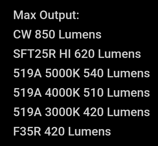

I am waiting for F35R version of M150. Lets see if it any good.

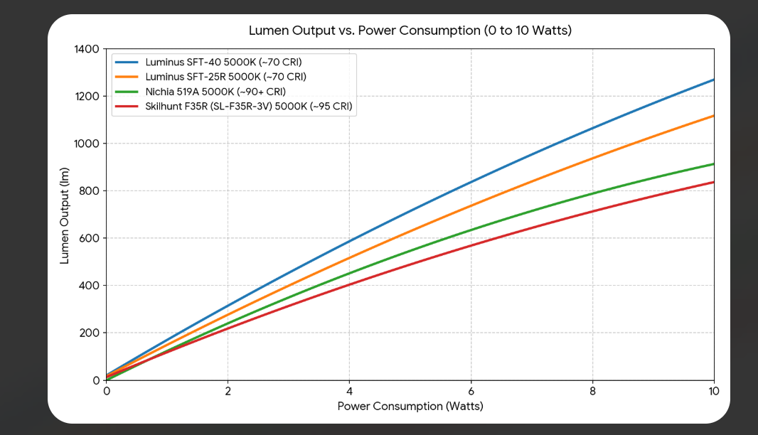

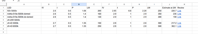

Asked gemini to do a graph for cross reference various popular leds relevant to M150 and it looks F35R trail in output to nichia 519a.
It will be an interesting question if better intensity will offset lower output in M150 body for practical applications.
SFT40 looks like 50% more efficient and can give 300 lumen in sustainable power budget for M150 compared to 200 lumen of F35R.
I tried SFT40 5000k in T6 and so far happy with it. To me it looks even rosy but tolerable compared to very green SST20 when comparing side by side.
What makes you think that the chart is correct?
And did you ask it what else it could hallucinate for you today?
F35R’s inferior output is stated by Skilhunt themselves.

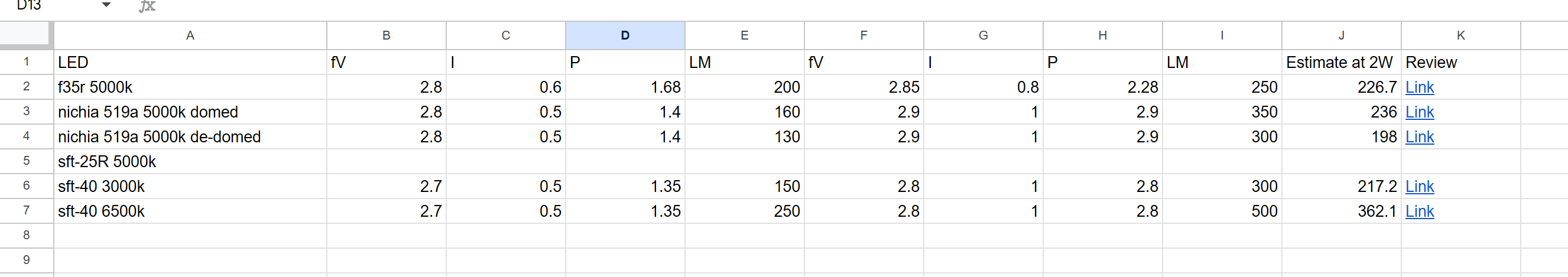

@SammysHP I tried to calculated myself per data we have on BLF and per it F35R better than nichia 519a de-domed and it is a wash if it compared with domed version)))
I don’t entirely trust my numbers. I measure with a smartphone and a shoebox. I do think they’re pretty close most of the time though.

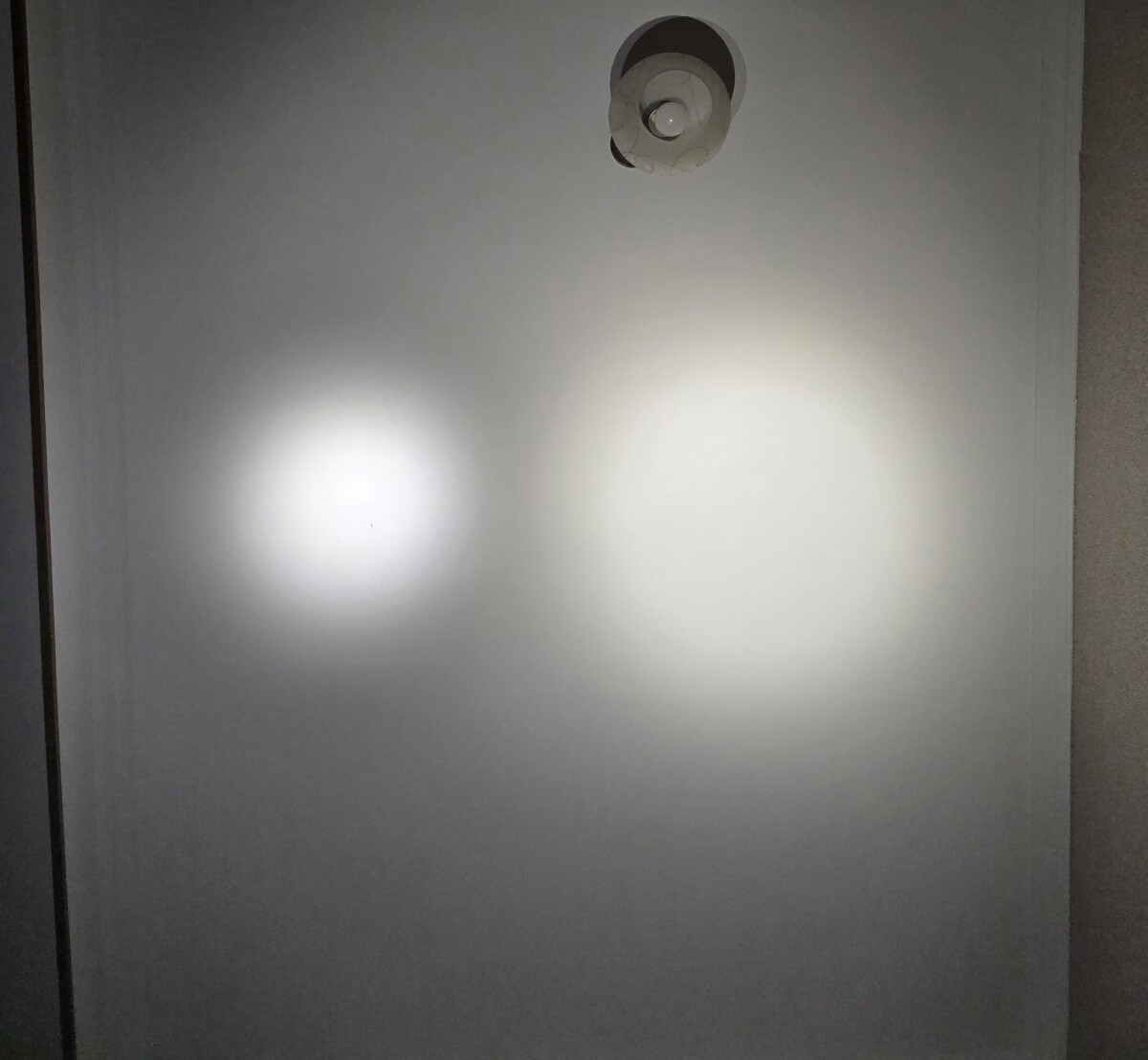

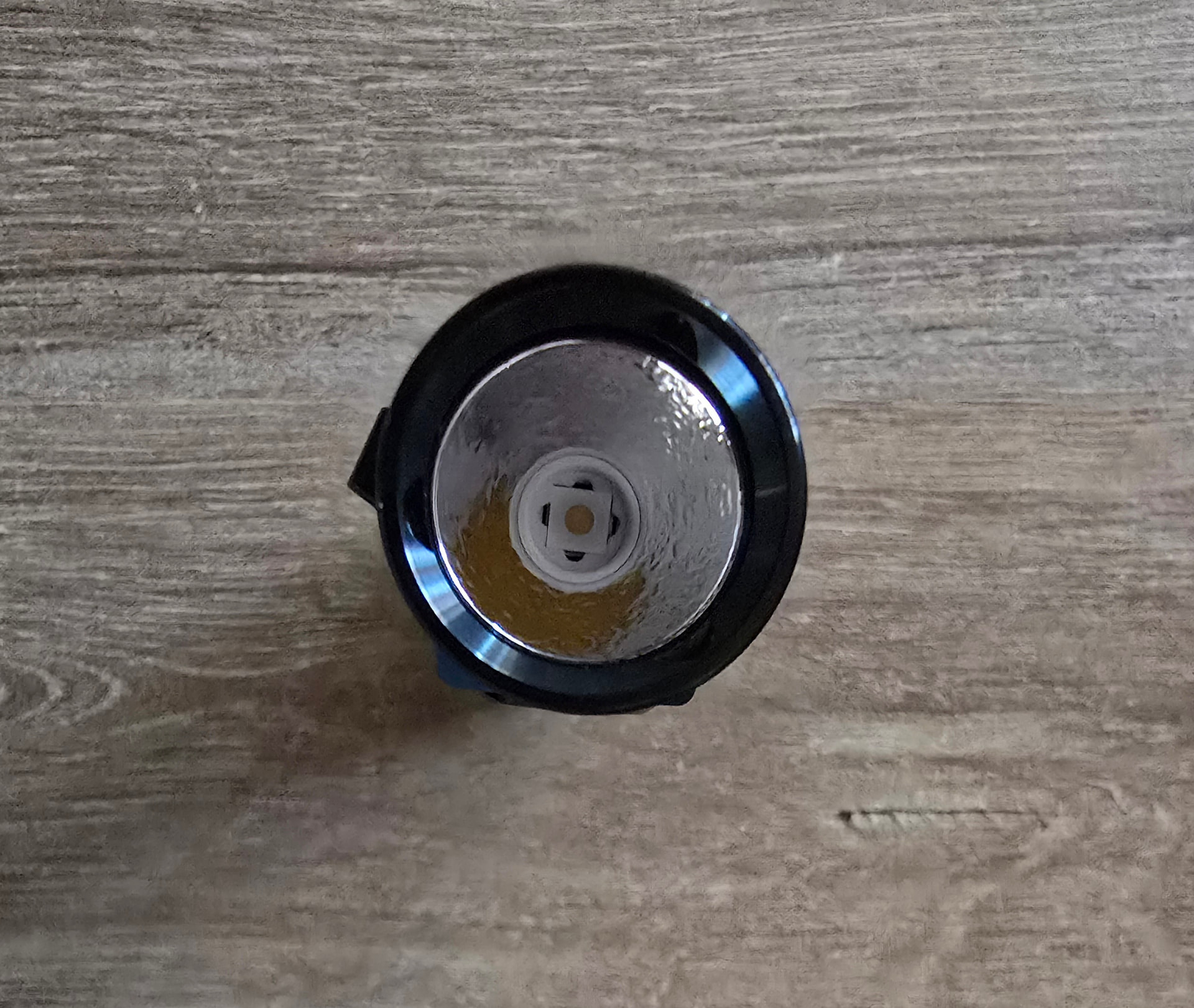

Received my package for M150 F35R model. Hopefully can daily drive it during next weekend. Will do comparison with other 14500 lights I have. Initial impression it is throwy for its small reflector.
Hotspot around 50% bigger compared T6 nichia 519a so it is less throwy than floody version of T6 but that is to be expected.

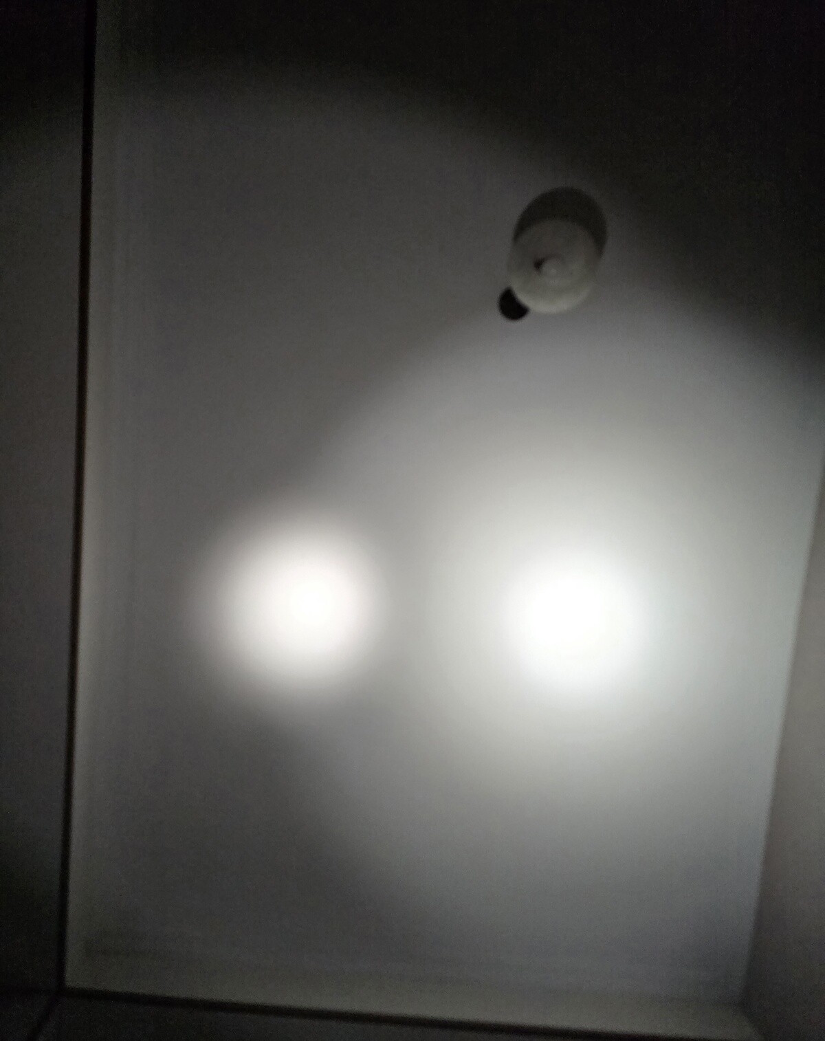

Comparison of beamshot of skillhunt and t6 nichia with op reflector. Skillhunt on the left. Nichia has 5000k CCT
Where T6 shines is that it has both tighter Hotspot and brighter spill. Much brighter.
Skillhunt - 1200 lux for hotspot / 30 lux for spill (H1 14500 BL-113C)
T6 - 1200 lux for hotspot / 100 lux for spill (50% NIMH)
So on T6 spill is around 3 times brigher and therefore more useful.
I do not have spectrophotometer to measure spectral data but clearly unlikely to have positive duv it is more rosy to my eye compared to nichia.
Skillhunt left vs lanapple right.
It is probably more relevant comparison since they have more or less identical reflector diameter and we see M150 with F35R clearly produce much more candela even if my lanapple has smooth reflector.
great beam comparisons
thanks for posting pics
the lux comparisons are also very informing
seems the M150 has a nice tight hotspot and throwy beam, nice LED color too.. domed 519a looks slightly greenish to me, I like its tint better DeDomed..
the T6 spill does look very useful for close range..

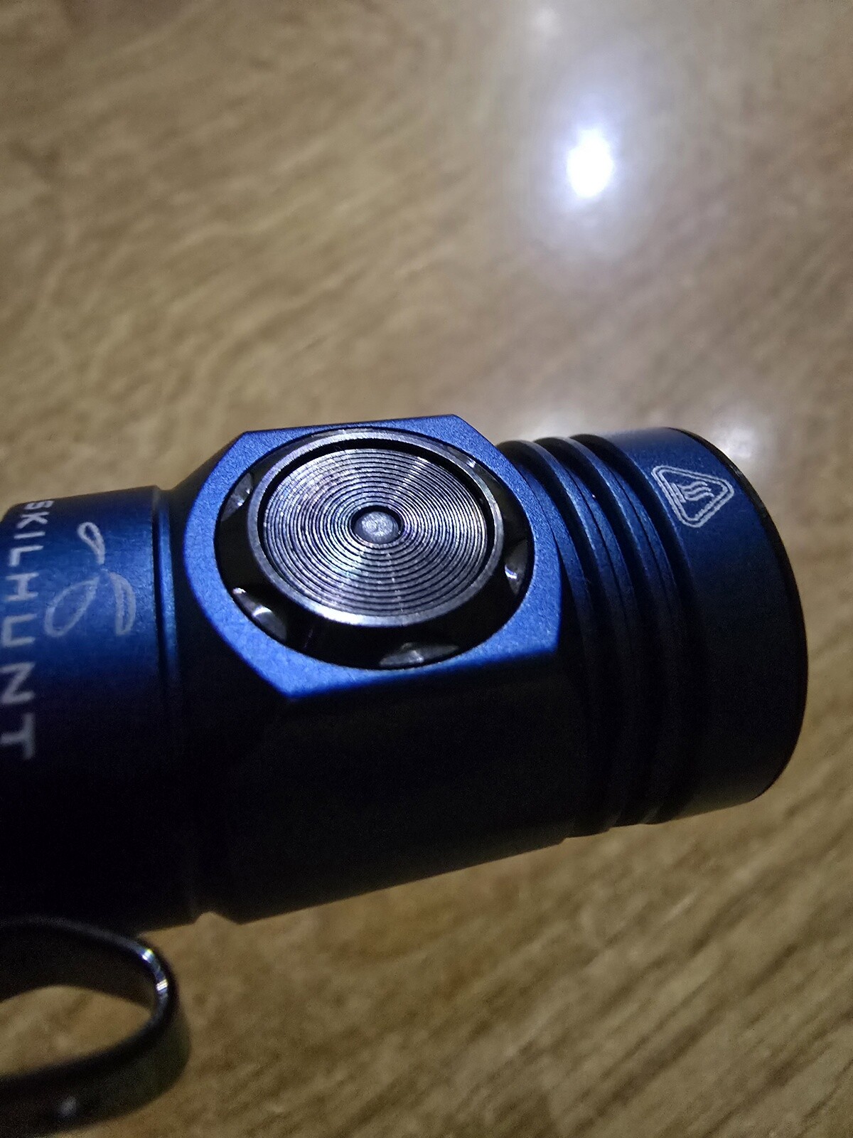

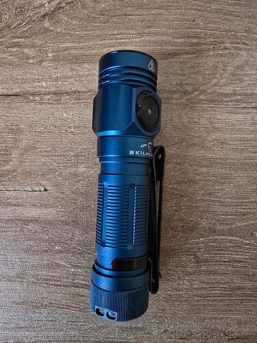

If you interested the metal button a bit under the outer ring so in theory it should be better than D3AA metal button for accidental clicks. With D3AA I usually have to do tailcap lock.
