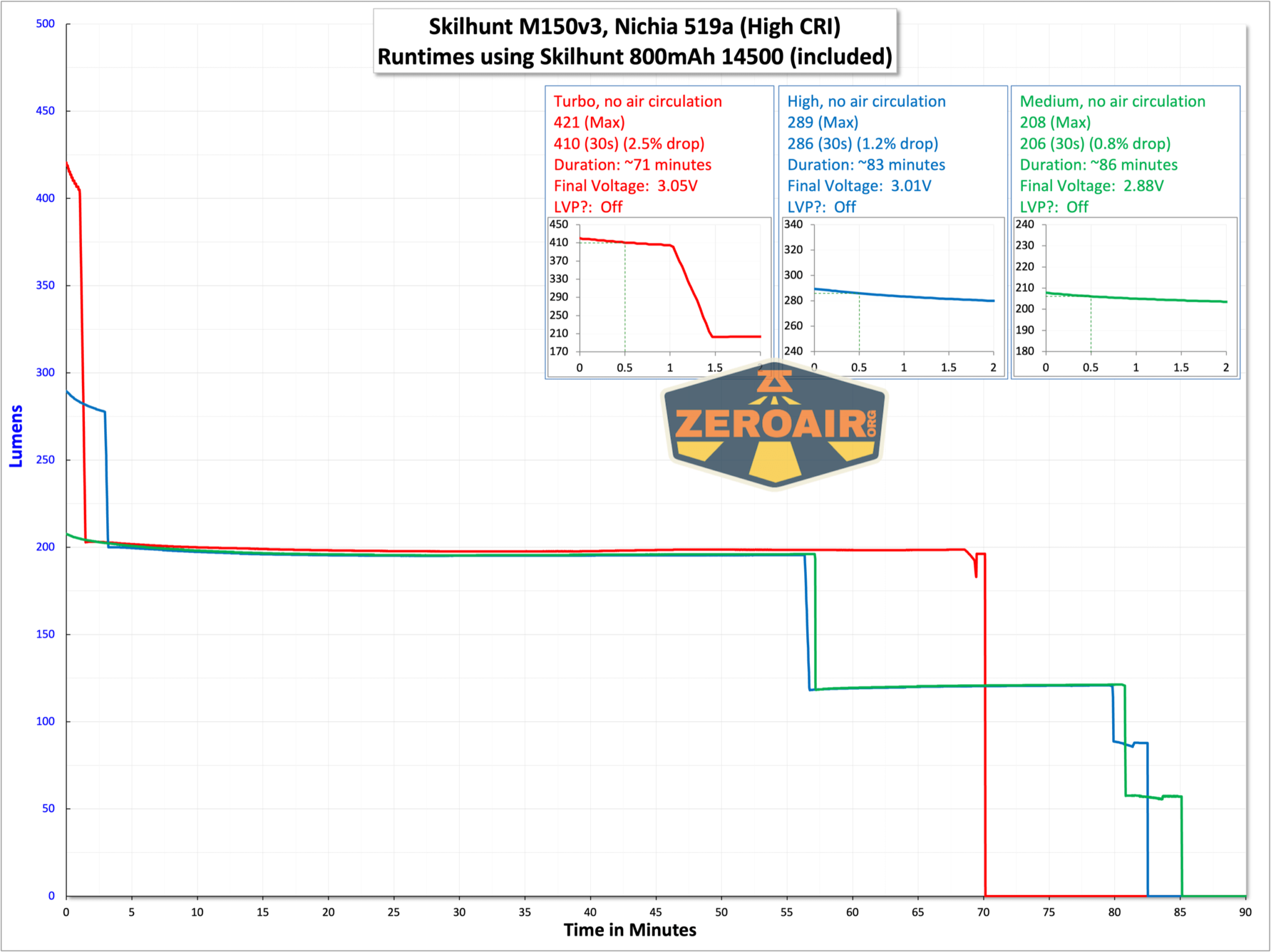

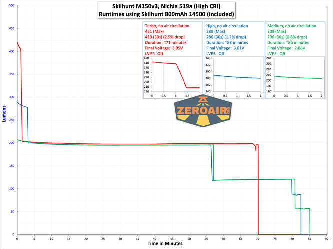

200 lumens of Sustainable High CRI is normal for a 14500 light
here is a review that shows the flat regulated output lasts about an hour on medium:
if you want a light with higher sustainable output, look at lights with Low CRI LEDs, such as the TS10SG… I have not found a runtime graph for that one yet, but it seems to hold over 500 lumens for the first 3 minutes.
A High CRI TS10 otoh, sustains about 200 lumens, similar to the M150
the High CRI 14500 light with the highest sustainable output Im aware of, is the D3AA at about 250 lumens

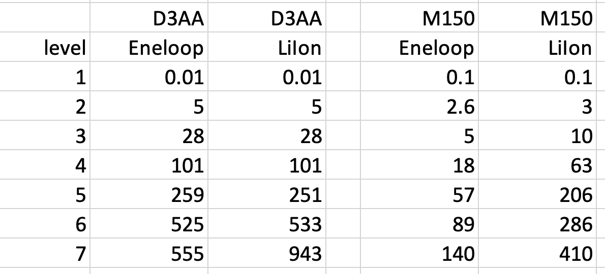

The one thing I’ve always found impressive of the m150/h150 is how moon-mode brightness is not impacted based the the battery chemistry that’s being used. Other 1xAA 14500 capable lights that I own, change their low brightness, based on what type of battery using.
agree
Also true for the Emisar D3aa, moonlight is the same on both types of batteries:
Also both lights use NoPWM

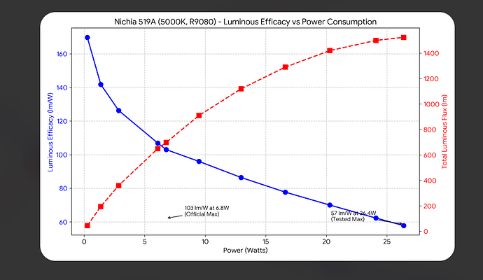

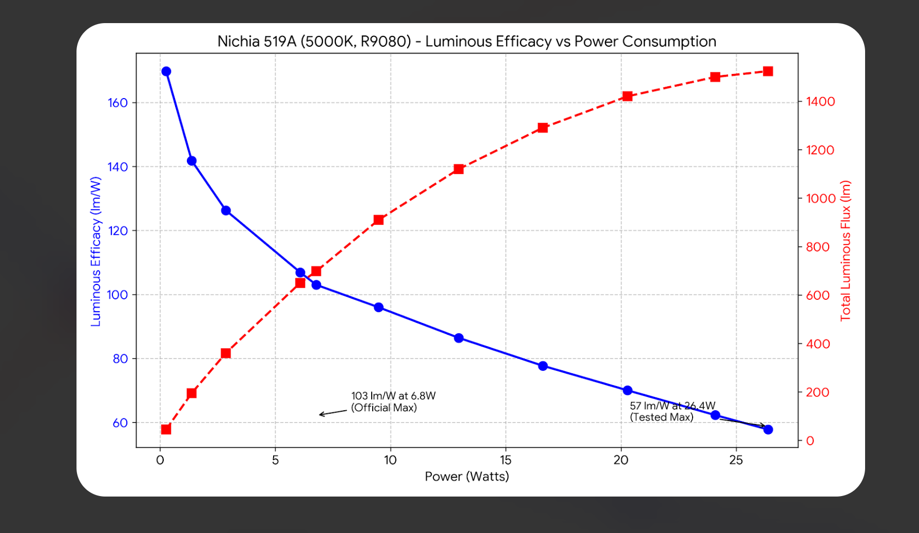

From my perspective it would be great to see mainstream dual fuel flashlight to get to a place when they can support 200 LM as sustainable output with 80+ efficiency of its driver when using NIMH which per D3AA driver we know is doable.
I asked gemini to generate a graph of Nichia 519A efficiency per watt. Should cross verify but should be ok as conversation starter :slight_smile:
Even if we take non eneloop Chinese nimh (pick that cell since I have quite a number of its newer sibling) - recyko 2600 then it perfectly capable of generating up to 3A at 1.1 - 1.15 V which gives us 3.3 - 3.5 Watt.
At 2A discharge it has almost eneloop pro capacity of 2400mah so could be good base for high mode.
So if use for high 2A at 1.15 V and 80% driver efficiency with nichia 519a at 2W we have 130 lumen per watt we should have output of 240 lumen
For 4A at 1.1V and 70% driver efficiency we should get around 370 lumen for turbo mode.
Per above there a room for an improvements.

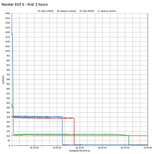

thanks for the link to Tims review, it has this chart that shows the Manker E05 2 sustains about 100 lumens on NiMh (the green line):

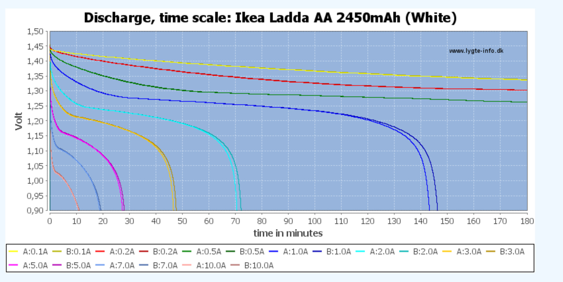

It looks like per that review they use nichia 519a 4500k

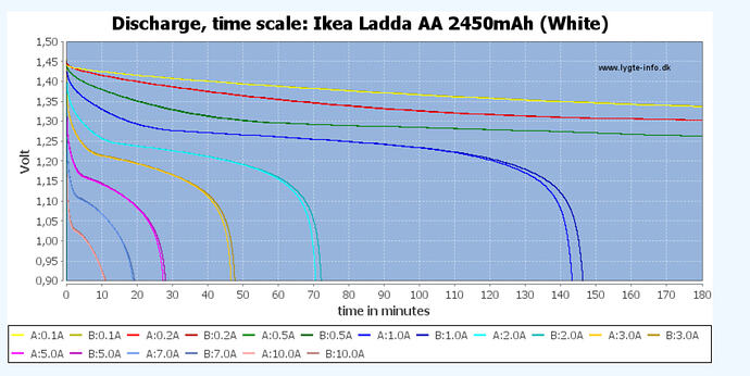

For 70 min runtime for lada nimh given us 2A per lygte review
For 2A discharge it 2.8 watt hour energy or 2.4 watt for 70 minutes which gives us around 83 lumen per watt that clearly better than many competitors more close to 50 lumen per watt on similar brightness.
Convoy T3 driver for example need 2.9A to produce 160 lumen albeit on more warmer nichia 4000K (which less efficient) so have around 50 lumen per watt.
They could push it higher since it is 100 lumen for 2:30 min so it is they decision and not system limitation since battery and driver could sustain higher power. I suspect they could implement a mode of 150 lumen for 1h but decided not to do it.
If it can sustain 300 lumen on liion then clearly it has around 3 watt for heat dissipation budget so technically it means it should be able thermally push 220 lumen on NIMH sustainably.
