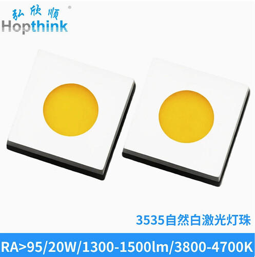

I received the F35R from Skilhunt in mid-January 2026. I do not have any further information about these LEDs apart from the values stated above.
The F35R has a simple design. The light surface is covered by orange phosphor and is surrounded by white silicone potting compound. Bonding wires are not directly visible, but can be seen beneath the potting compound when reflected appropriately. Four bonding wires appear to be used. All in all, the F35R is very reminiscent of a smaller version of the FFL505A or W5050SQ3, which have already been tested.
The footprint is compatible with all 3535 and XP boards, and the thermal pad is electrically insulated.
This LED may be from HSXLED (Hopthink), but this cannot be confirmed.
The luminous surface is covered with bright orange phosphor, which indicates a larger amount of red phosphor with a high wavelength maximum.
The luminous surface measures 2.69 mm2. There is virtually no light emitted to the sides.
