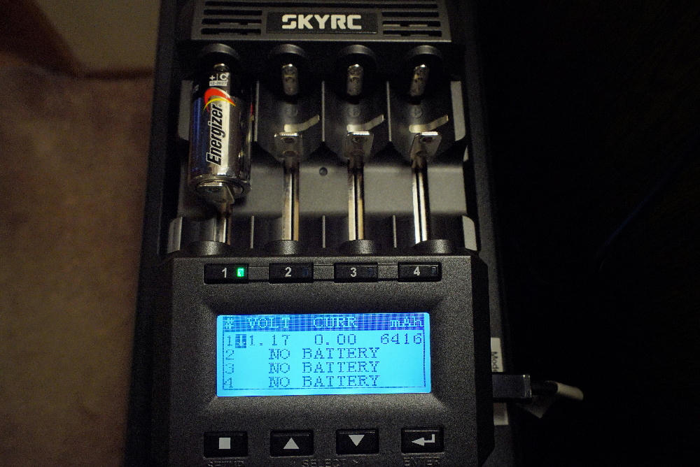

D-Reduce will lower the charge current when battery voltage (during discharge test) gets close to V cutoff. Per the manual, this can be used to test capacity of alkaline batteries, and factors in an alkaline's ability to recover. Through experimenting, I found that setting D-Reduce to about 50% (of set discharge current) can get you close to an alkaline's rated spec. For example, a while back I did a discharge test on an Energizer C-cell. Discharge current was set to 100ma (duplicating Energizer's testing spec), and D-Reduce to 50%. From Energizer's rated capacity HERE, I got pretty close (6416mah), but not without using D-Reduce.
