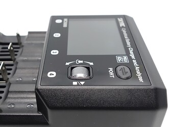

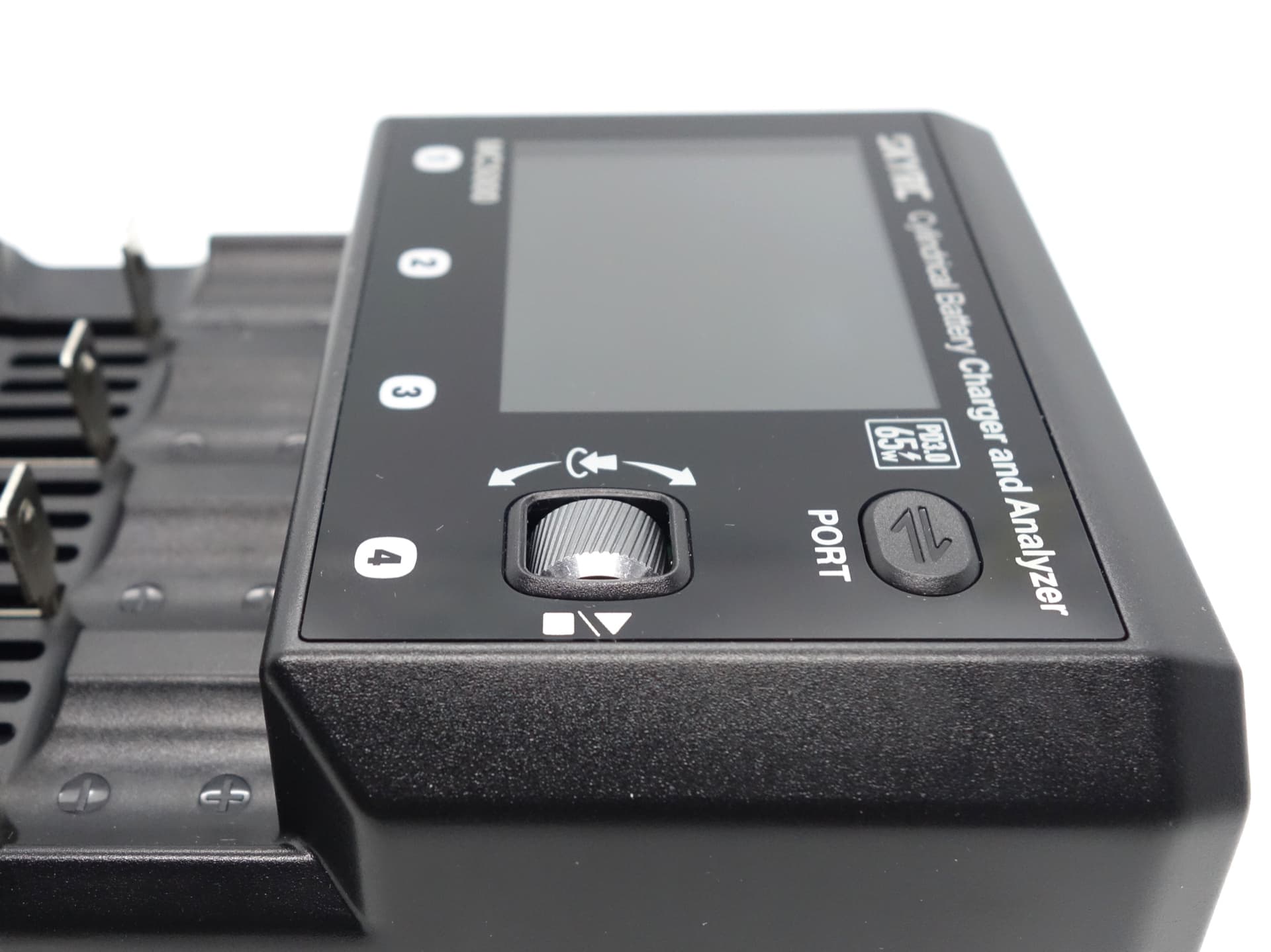

There is a PORT button and a scroll wheel button to control the SkyRC MC5000. The quality feels really good.
The positive terminals have two notches each. This makes it easier to insert flat top cells without needing to balance them near the top. That said, if the wrap of a cell blocks the negative end then you will need to carefully align the notch on the negative terminal with the negative end of a cell.

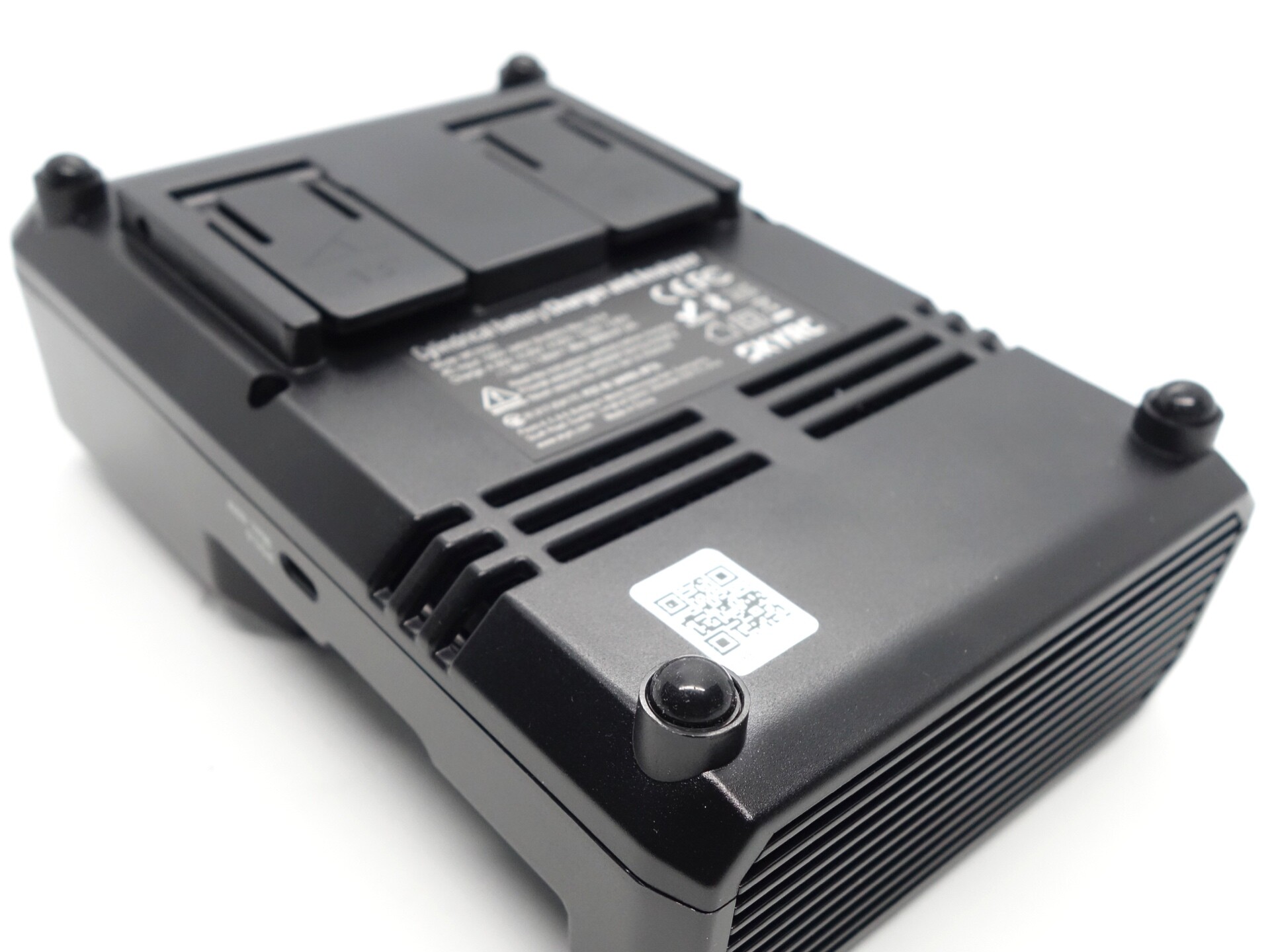

The four rubber feet are massive and they feel durable.
There are three fans and multiple vent holes to cool everything down.
There are two stands that kick out at a 13 degree angle. This helps with the airflow and makes it easier to see the display from an angle.

Just one concern regarding the scroll wheel which also doubles as a push button.
If scrolling using the scroll wheel, I can see instances where operating the scroll wheel in scroll mode, pushing or pulling too hard might accidentally cause the scroll wheel to click as a push button. Conversely, if operating the scroll wheel in push button mode, if pushed off center this may cause the scroll wheel to accidentally scroll instead. These accidental operations may lead to problems with unwanted results.
Really would prefer separate push buttons for navigating instead of the scroll wheel.
In practice it works quite good. No problems while scrolling, but it happened a few times that I accidentally scrolled while pressing the button. All in all it lets you navigate much faster than up/down/enter buttons.

I had difficulties with accidentally selecting YES when starting a task. The charger prompts you to ask if you’d like to apply the task to all slots. I scrolled to NO but when I press the scroll wheel to click NO it would change to YES. This happened about three times. I’ve become used to the sensitivity of the scroll wheel. It has some tactile feeling when scrolling and isn’t freely spinning.

Although with care, it seems that accidental push and scroll of the scroll wheel is minimal.
However, there is still that possibility of accidental activation, which would annoy me no end. I would accept the scroll wheel if used ONLY for scrolling up and down with an added separate button for confirming selection. In this case it is very unlikely accidental activation will occur.
So, as it is at the moment, with the dual function scroll wheel for scrolling and selecting (push button), I will not be purchasing this charger due to possible accidental selections.
Looks like it has plastic kickstand legs. I wonder if they would weaken and crack over time. Wish it were metal like the old Powerex MH-C9000 that I’m looking to replace.
Thank you so much for your time
The ones on the MC3000 are very solid and certainly have not weakened in 10+ years. If the MC5000 is similar there won’t be a problem there either.
