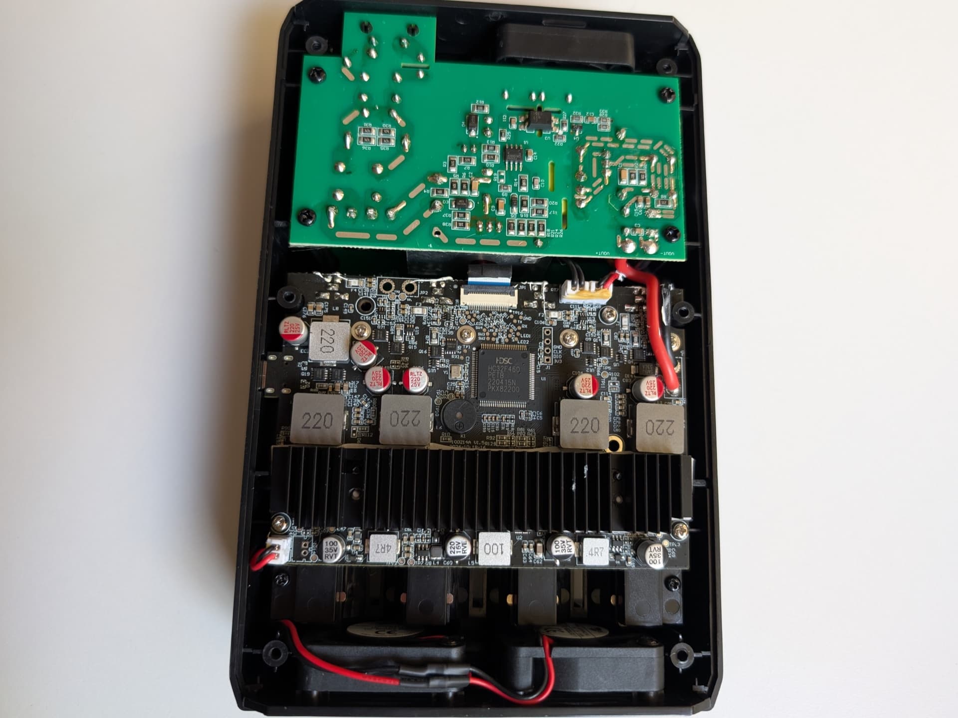

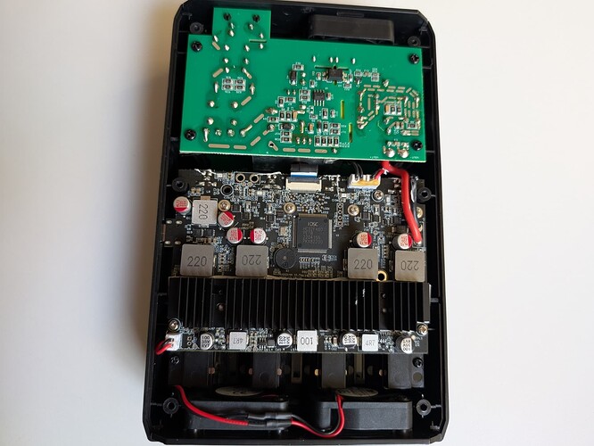

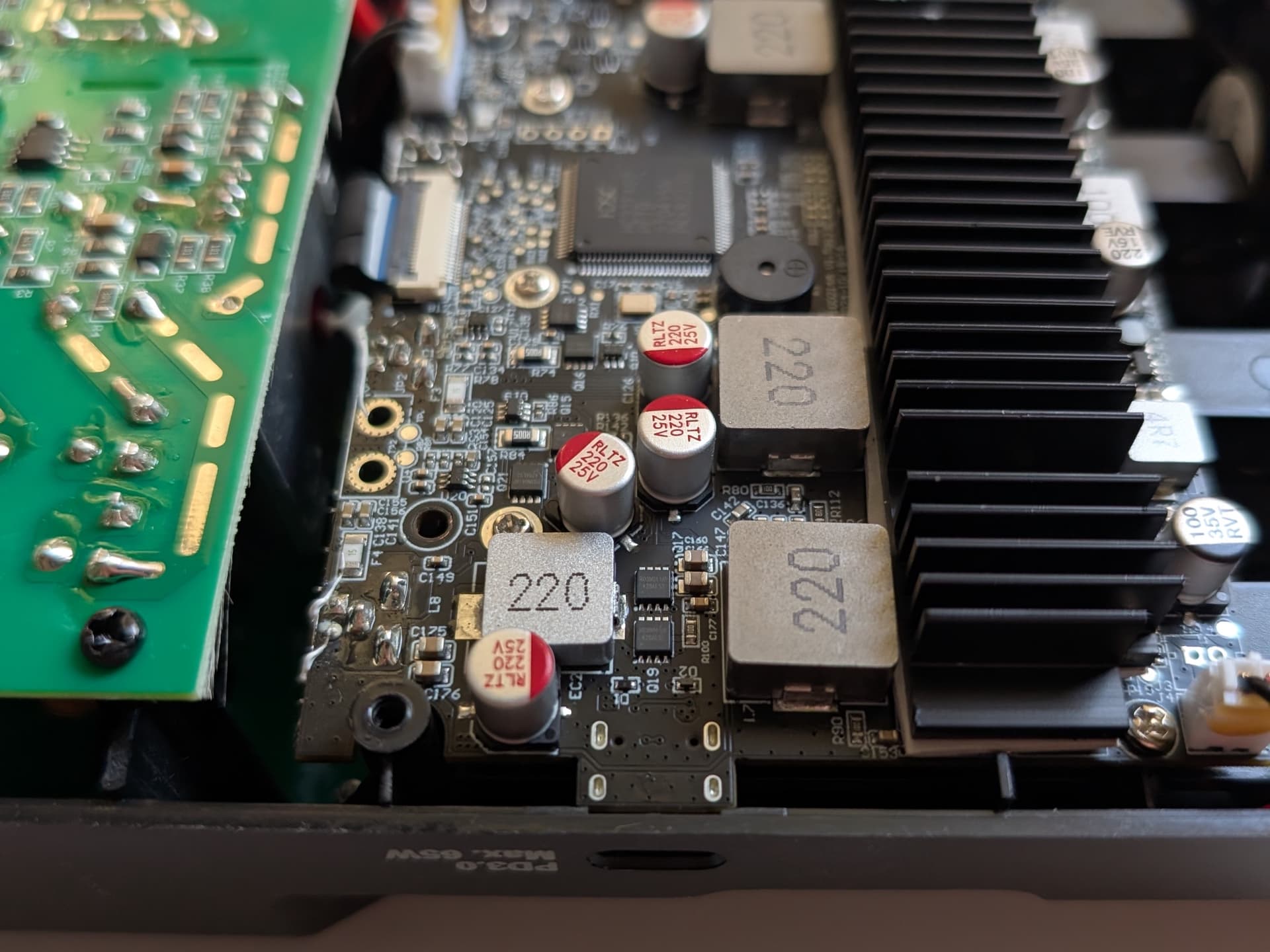

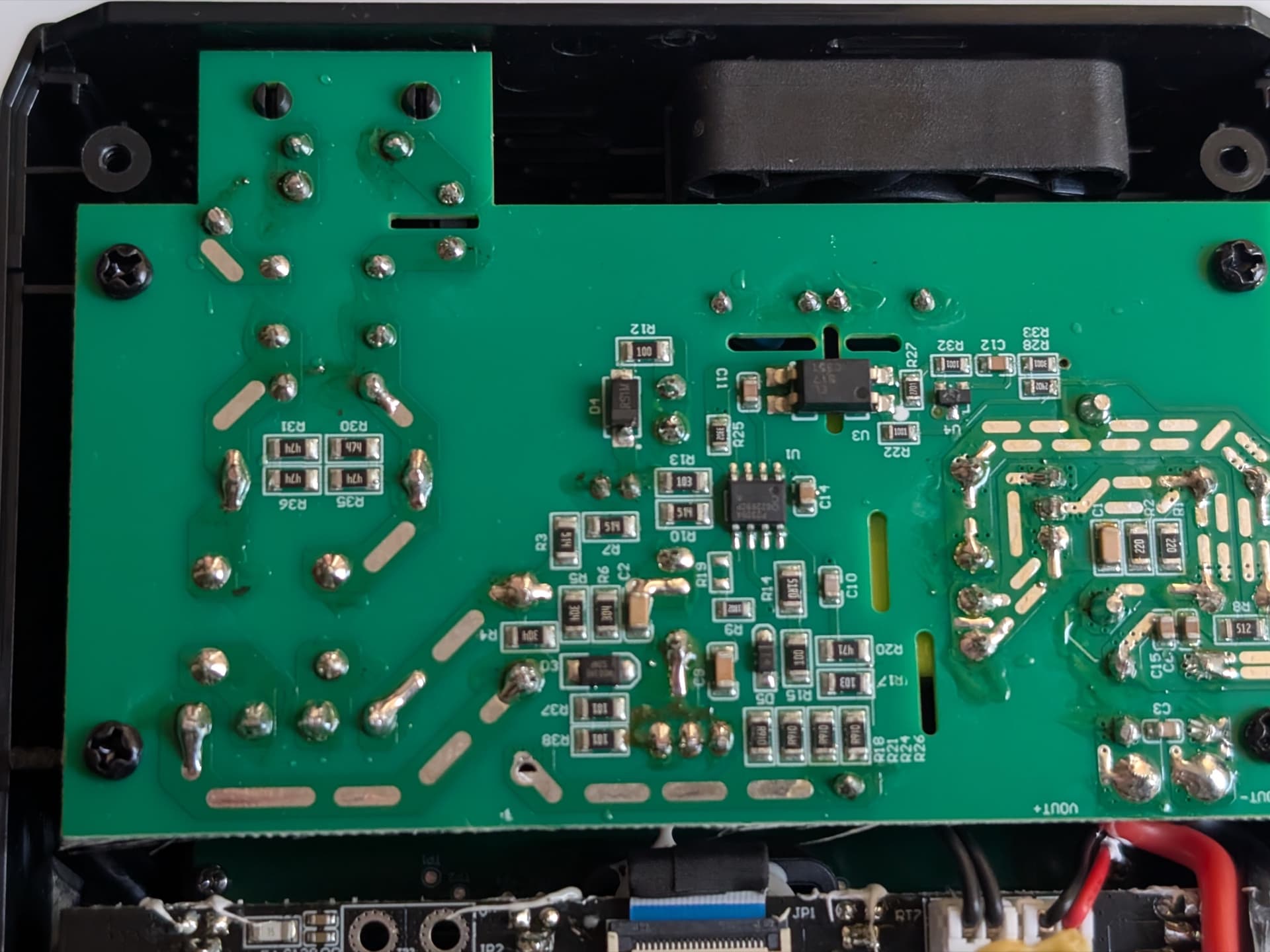

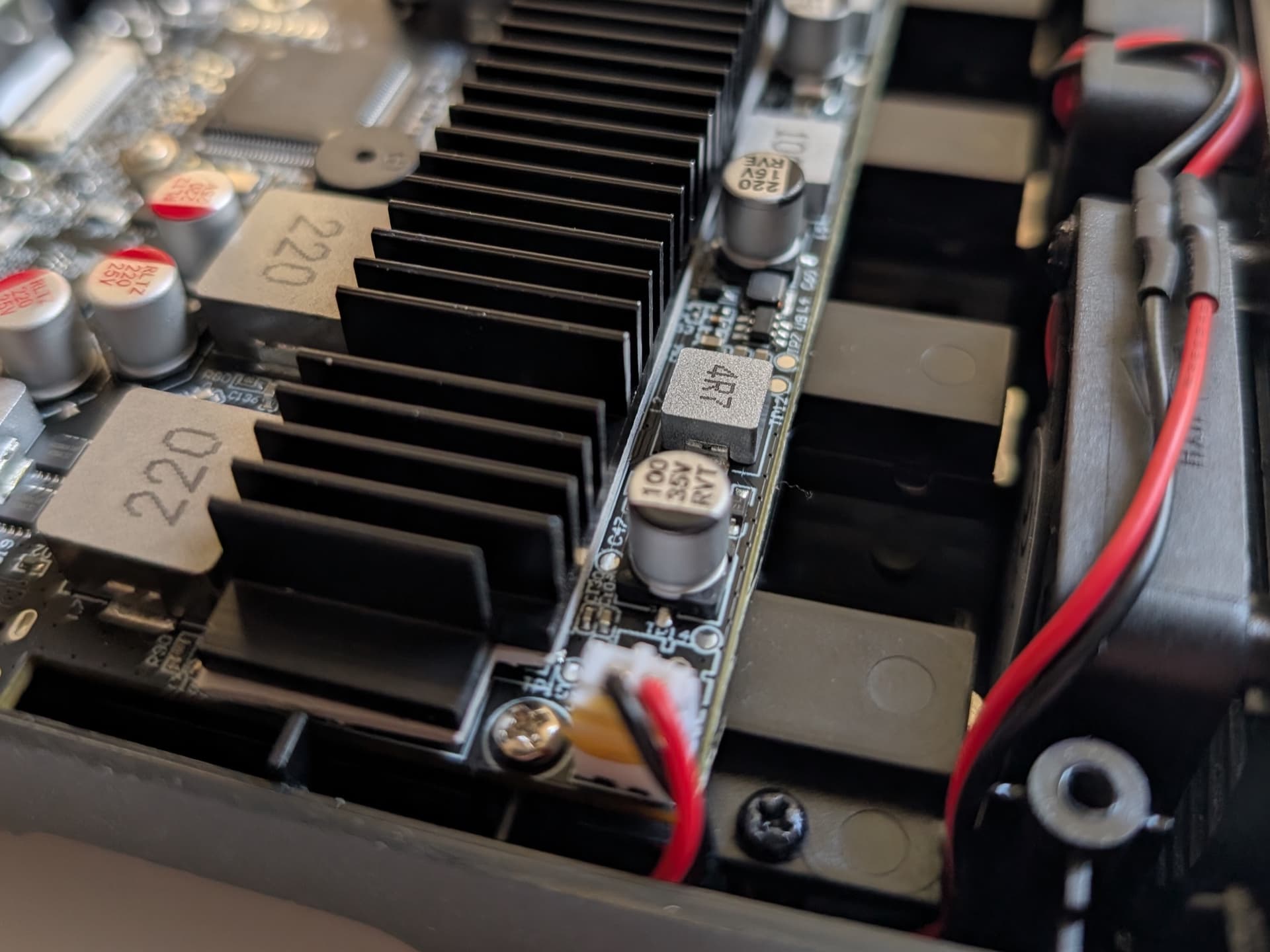

I’ve added a few photos showing a partial teardown to the review.
