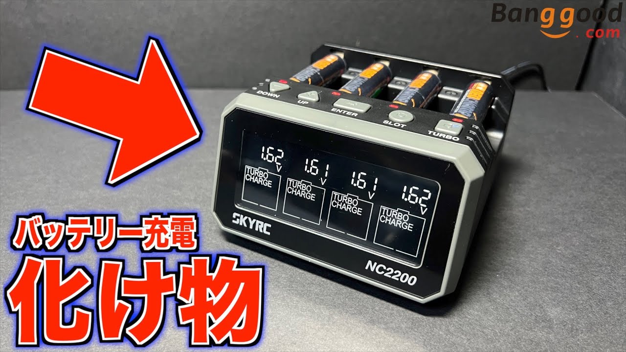

I am considering the Vapcell S4 Plus, and the SkyRC NC2200. I was gravitating toward the NC2200 based on SkyRC’s reputation around the MC3000. However, I started to see some videos (not in English, which makes it tough for me to fully understand) that show Ni-MH batteries going up to 1.65V during charge:
Is this an issue? Anyone have any thoughts on this charger? Or should I be getting the Vapcell S4 Plus instead?
