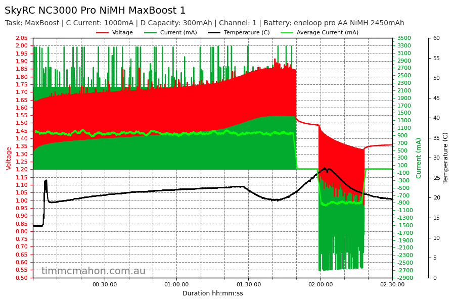

NiMH MaxBoost #1
Firmware: 2.49
Mode: MaxBoost
Capacity: 3500mAh
D.Capacity: 300mAh
C.Current: 1.00A
D.Current: 1.00A
Target Volt: 1.65V
Resting After C: 10min
-ΔV: 5mV
Current Mode: Fixed

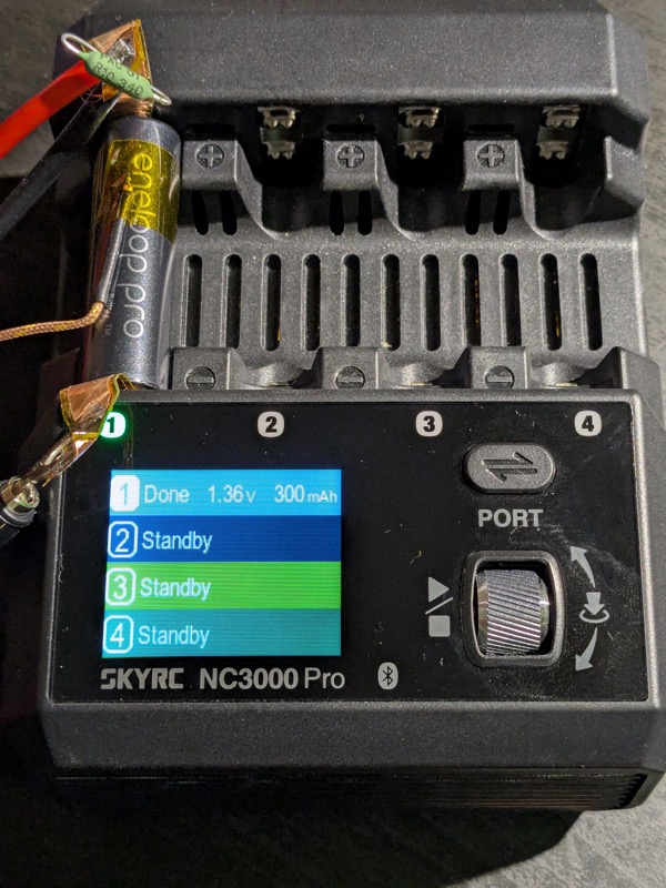

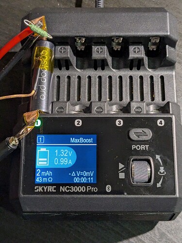

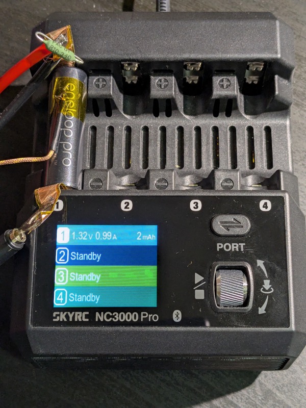

Battery: eneloop pro AA NiMH 2450mAh
| Measurement | CH1 |
| Start Voltage | 1.299 |
| Finish Voltage | 1.370 |

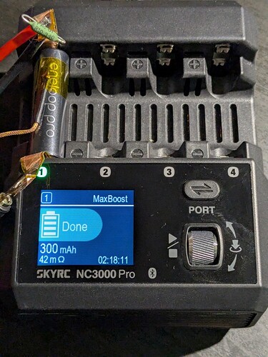

| Capacity (mAh) | 300 |
| IR (mOhm) | 42 |
| Time (hh:mm:ss) | 02:18:11 |
