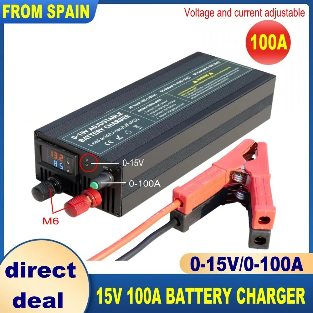

What recharging time is OK for you ?
SkyRC B6 neo is an overkill in terms of functionality and at the same time it is underpowered for the 100 Ah battery.
If you’ll be able to find additional applications for this charger (like balancing battery packs, testing capacity of small cells) then it’s a nice device to buy. But if you need just to charge a 12V 100 Ah battery and you need it to be done fast then consider buying chargers like this
