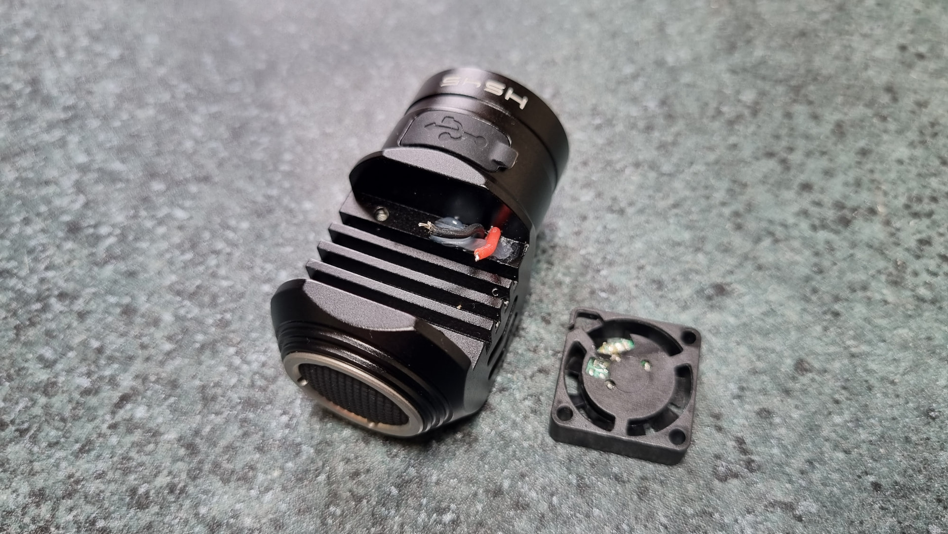

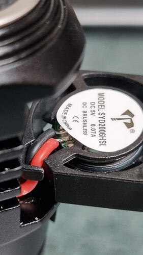

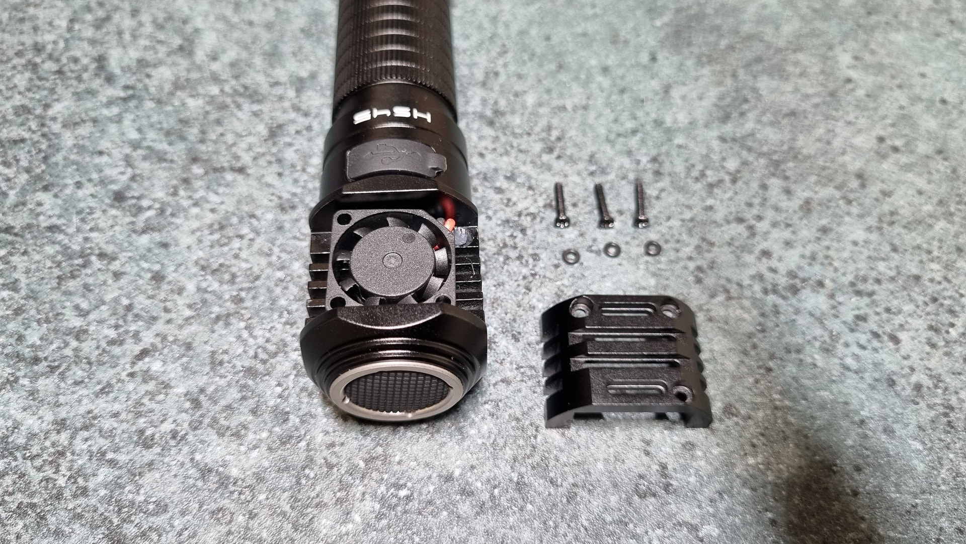

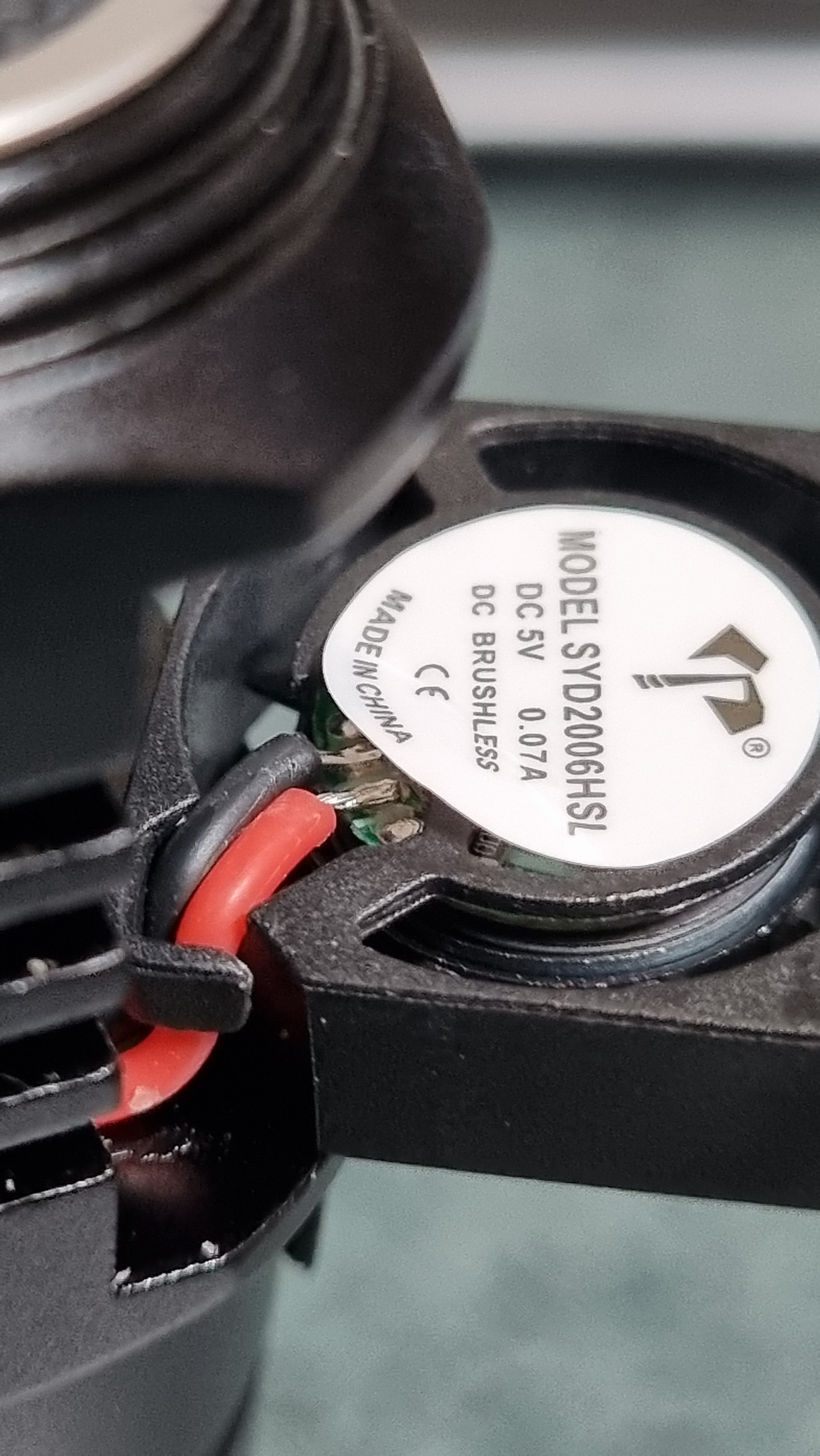

As most already know by now, from my posts on reddit and review, the flashlight is IPX6, but the fan fails to meet any waterproof rating and should never have been used. The Wuben X1 Pro uses the same fan for IP65 but it’s concealed, whereas the HS45 has an open grill that offers no protection from moisture at all. I informed Barry Dong about it and Sofirn are now informing customers to not wash under water to clean the fan, despite the manual instructing one to do exactly that.
The fan bearings started to fail after 5-6 hours of testing, sounds horrible now. Another person on reddit has experienced the same thing.

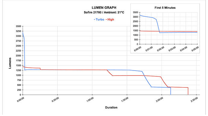

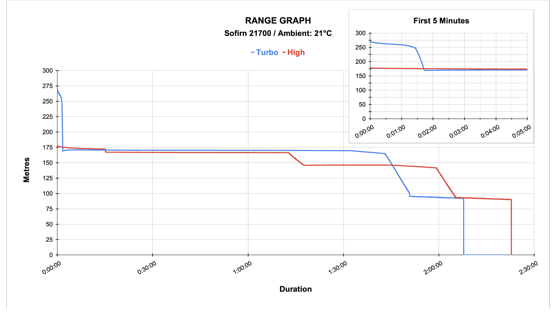

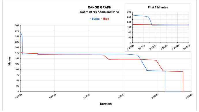

1280 lumens / 170m sustained is fairly impressive though. Personally, I’ll never get used to having a fan next to my ears at full throttle!
Photos of the fan:

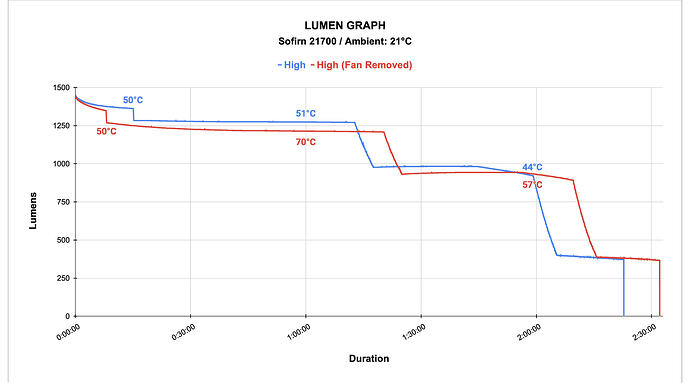

Graphs:
