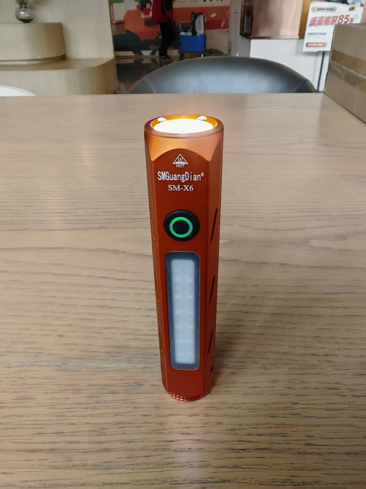

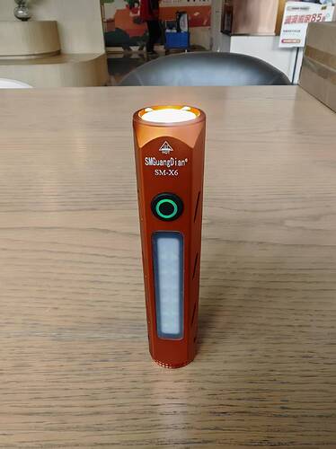

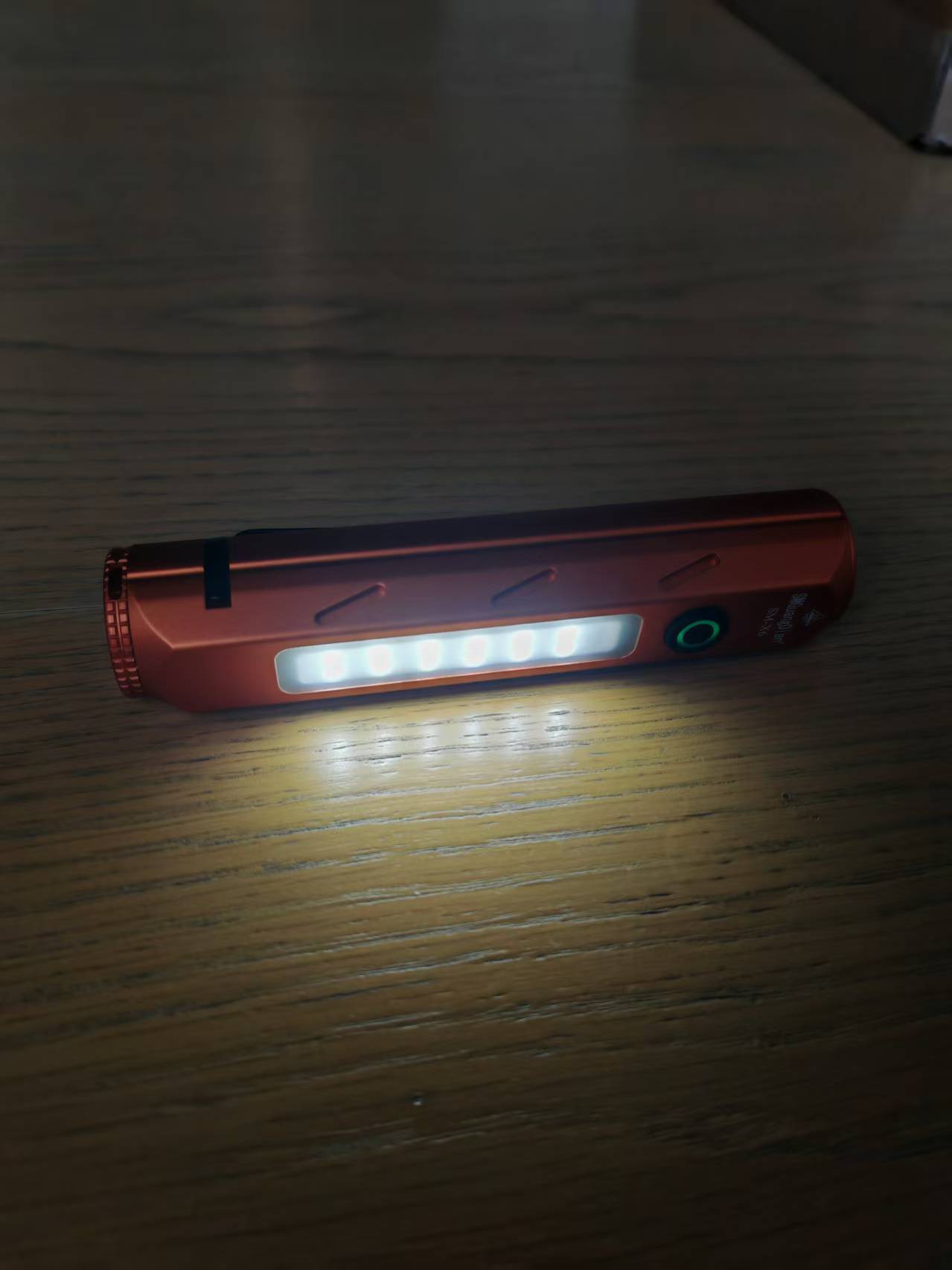

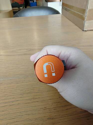

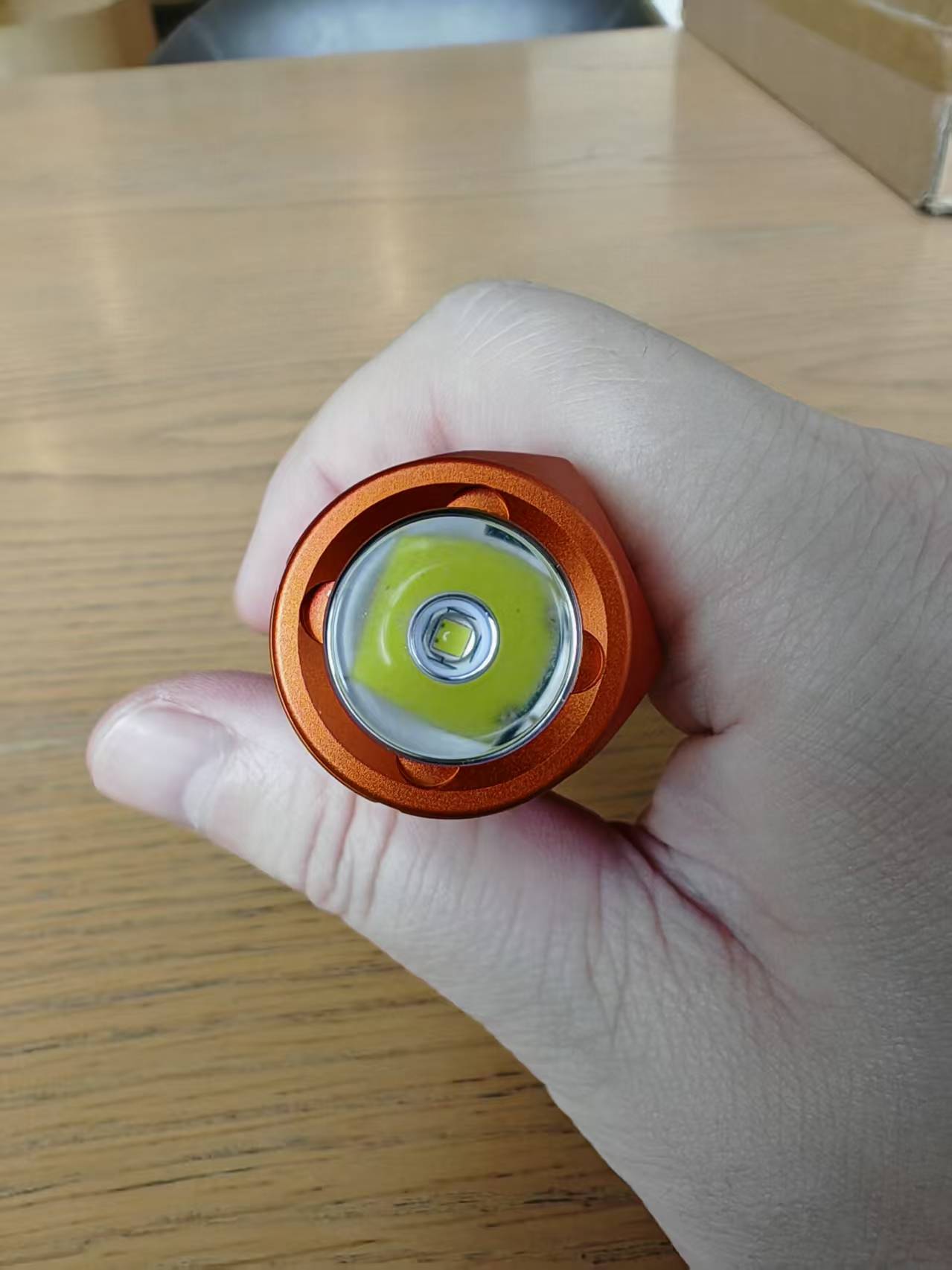

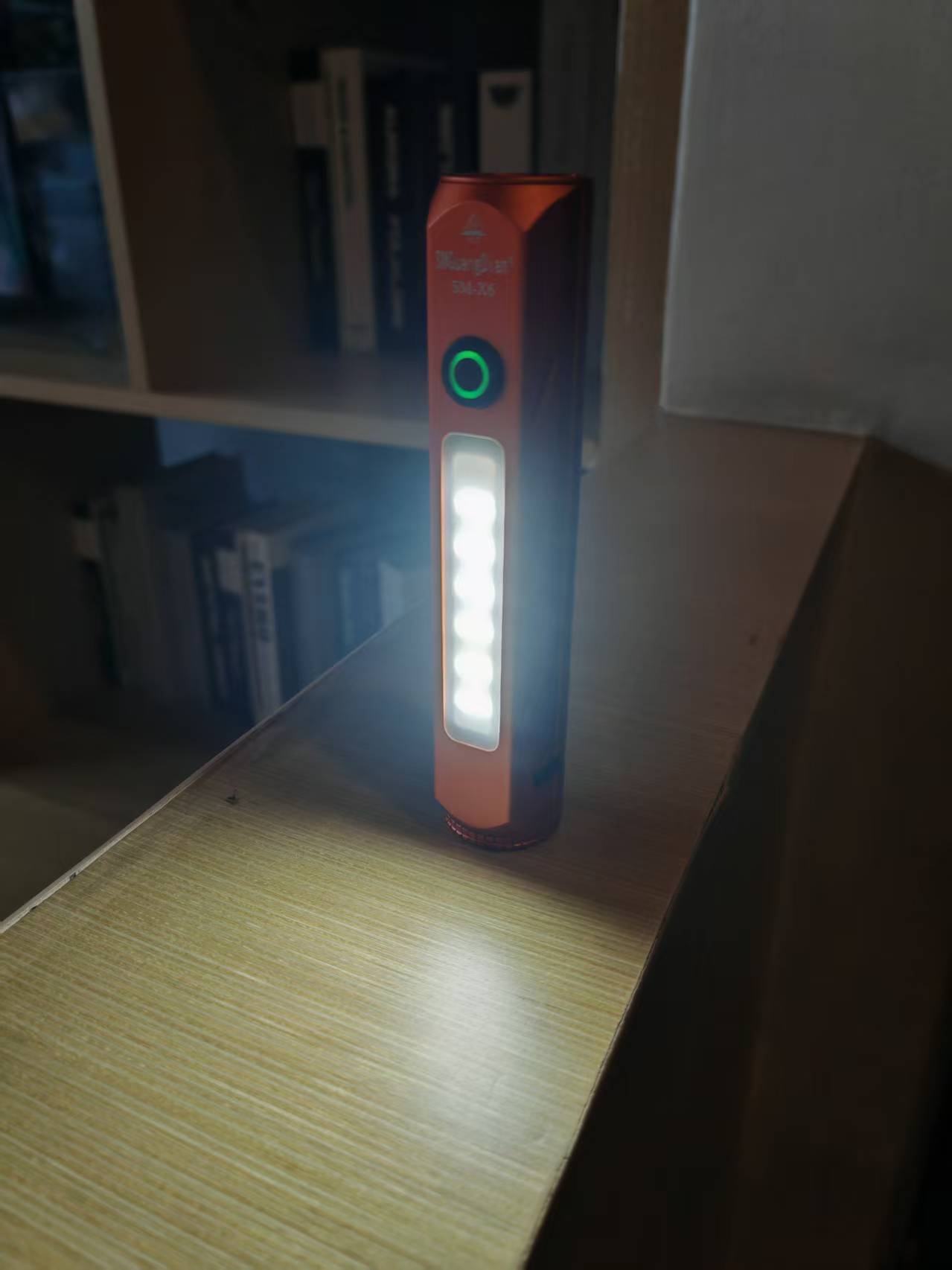

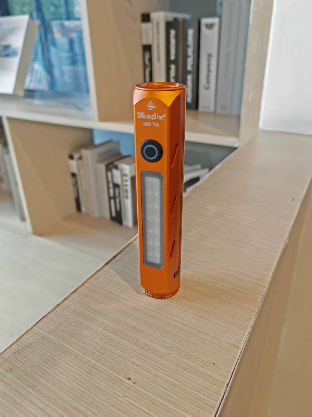

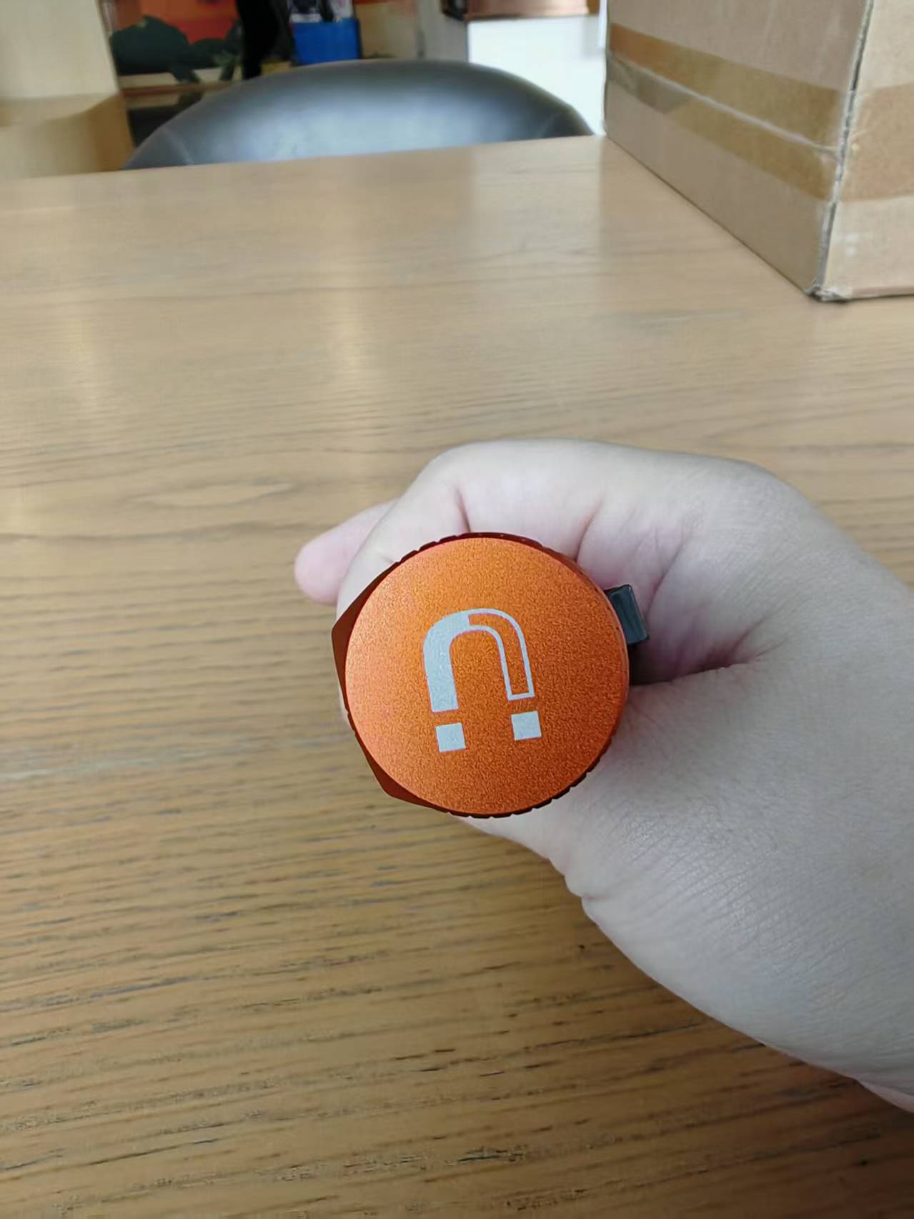

I have bought one Songmei X6 with $7 here.
SST40 led chip, and it seems that this one is similar to IF23.
If the magnet can be removed please post it here.
