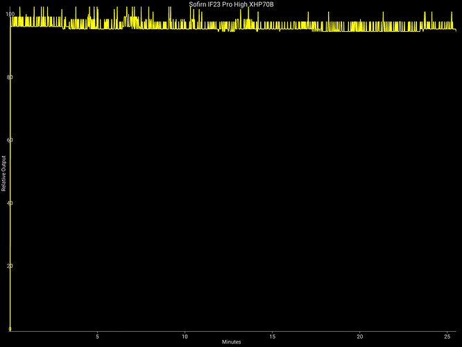

Sofirn have finally released their highly anticipated IF23 Pro! I know a lot of you have been asking me to review this light, so I reached out to Sofirn and they provided me a sample for this review. Sofirn hasn’t paid me to make this video, and I haven’t held back on any negative opinions either. The IF23 Pro is a great example of a ‘do-it-all’ flashlight, which I’ve started to see more these days, instead of your usual one LED, tube flashlight. It comes with a main light rated at 5000 lumens and side flood lights that can be customized to various colors and tints. Similar to the IF24 Pro, the IF23 Pro comes with a buck driver on the main light channel, which improves efficiency and allows for sustained brightness/output levels.

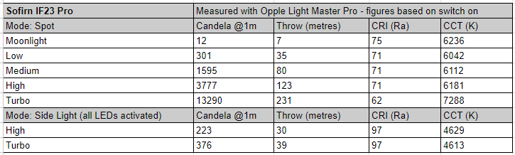

Performance - total output, beam profile, longevity, practicality
- Ceiling bounce test, CRI, CCT:
- The IF23 Pro produces a wall of light with a large, diffused hotspot. The light has a surprisingly good range due to the sheer amount of light emitted. The side light is very handy for closer-up situations and as a walking light where you need soft, diffused light.

The side light has a FET driver. So as the battery voltage drops, the light will slowly get dimmer rather than maintaining constant output.

- The Sofirn IF23 Pro is a great all-in-one flashlight that’s perfect if you’re someone who needs a long-range flashlight and floodlight in the same package. The RGB lights are great if you want to attract attention or like to use red light at night like myself. I also like that the battery is easily replaceable, unlike some flat-style flashlights with similar features. The buck driver makes a huge difference for anyone looking for a serious flashlight as you won’t need to worry about the light dimming during use.
