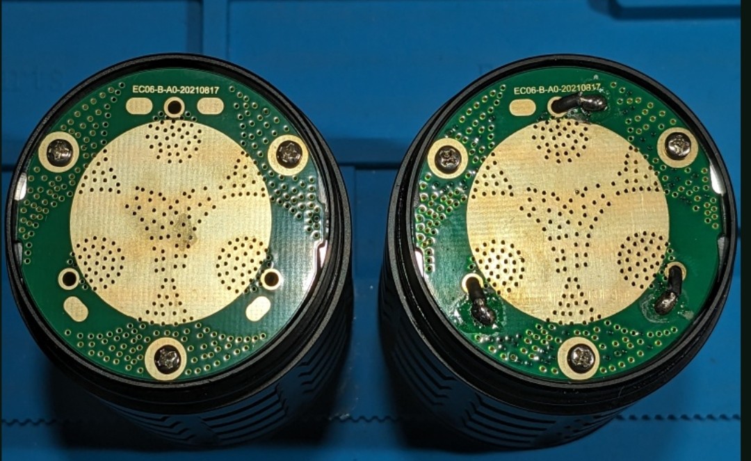

Photos of your modified and unmodified and my unmodified tail caps.
The tail does not look bypassed, so the springs will probably be the first point of failure with high-drain cells. Even stock cells (unspecified current, so probably low) heat up the springs enough to be scalding to the touch.
Without bypassed springs and checking the MOSFETs to determine their model/quality, I would not recommend using turbo with high-drain cells, not for more than a few seconds.
Thanks.. I will stick with 12 amp cells. I set thermal limit as high as it could be. Tail stand for 2 minutes got very very hot. Actual use it would never get that hot because I would turn it down.
Maybe a stupid question. Where do those black wires on the modified cap connect to on the other side. I thought about doing the mod, but if they just connect to the bottom of the spring… the springs would still be weak points.

The wires go from the battery-spring contact point (i.e., vertex) of the spring to the pad you see in the photos, so that the spring is bypassed entirely.
Thanks. That would make for a neater install than having to solder to the bottom of the spring.
The question is, is it worth doing if I am just going to blow /burn up something else in the light??
If you’re using stock cells, bypassing the spring gains you a bit more efficiency, which could make it worth doing. I’ve bypassed mine.
If you’re using high current cells, bypass is must as otherwise you are pretty much guaranteed spring collapse. Some folks have reported the MOSFETs blowing, while some folks didn’t have any issues, it’s largely up to luck. If your FETs are AON6512, they have very high resistance in the low voltage regime and can be expected to fail if one is not judicious about turbo usage. At 3V, the resistance is quite literally off-the-charts.
