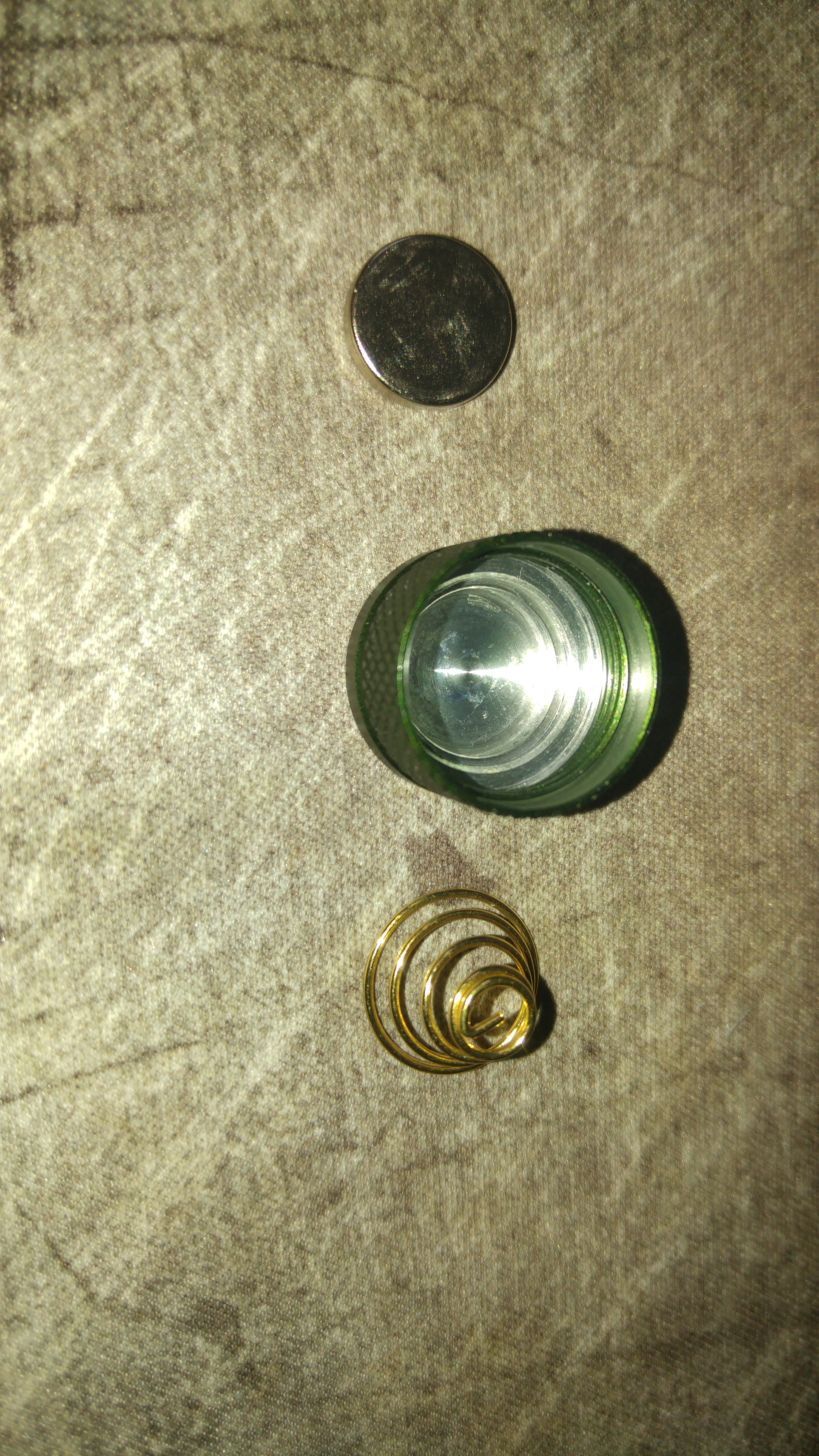

Did anyone bought the magnetic tail for SP10 pro?
My magnetic tail doesn't work.
The spring is just a friction fit, no solder. The magnet is held by some weak glue/tape.
I tested tail with multimeter, and there's continuity between the spring and the tube contact place.
Then I tested the tail with the tube, and there's no continuity between the spring, and the tube end.
So it seems, that the SP10 pro tube, just doesn't make any contact with the tail.
I just looked at it one more time, and the original tail, when screwed, leave small gap between the tube lip, and it.
But the magnet tail, just screws till it hit that lip, and then it can't go any deeper.
So the problem is that the magnet tail is too long, on the thread side, and just hit the anodized tube lip, without making any electrical contact to the tail.
As in the pictures above, there is original, and magnetic. Orginal bottoms out on tail, and make contact. The magnetic bottoms out on the tube lip, and doesn't make a contact with the tail.
Does anyone have the same problem?
