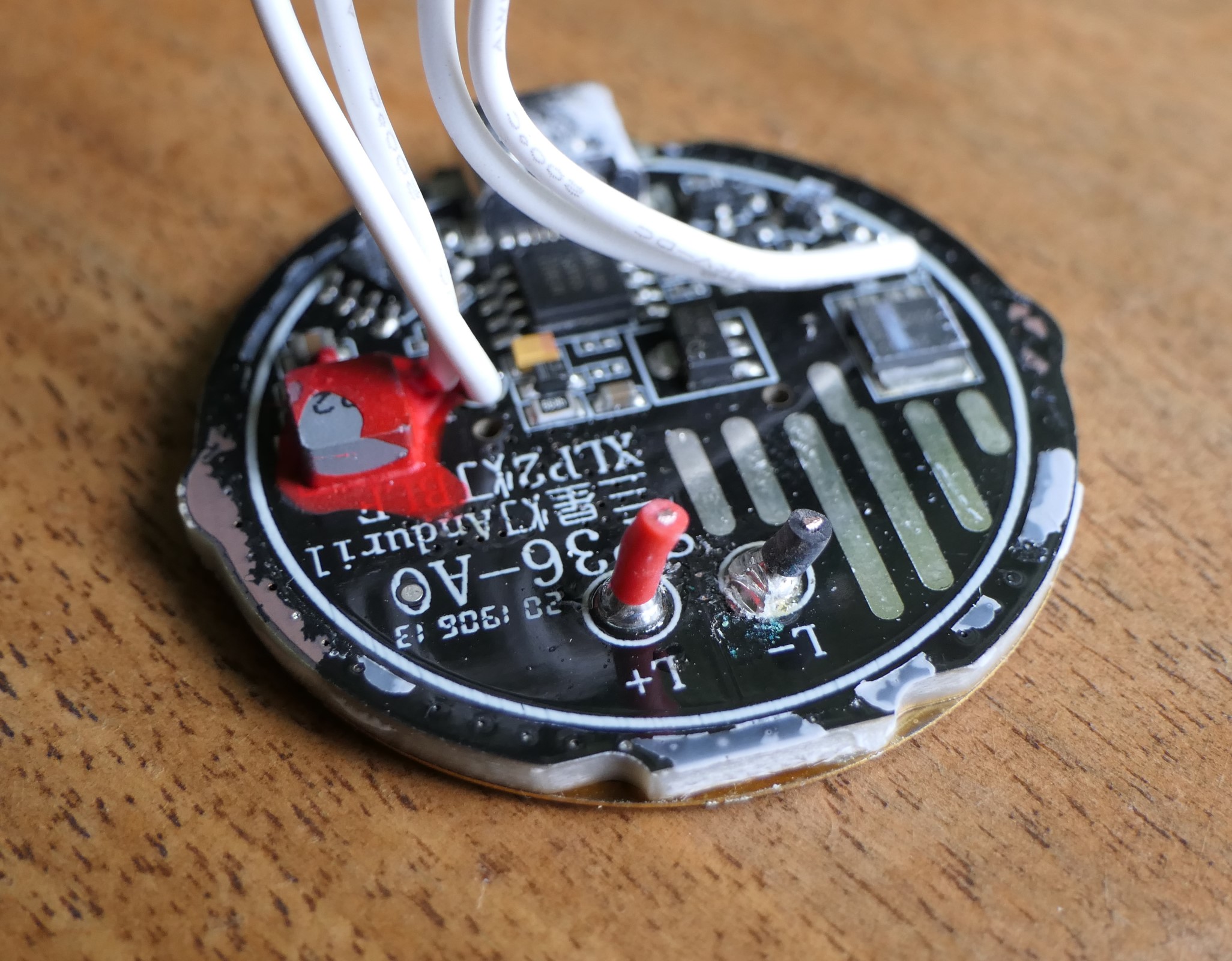

Always on means the LEDs negative are connected to the cells negative (i.e. body), could be the thing rattling inside (screw?) stuck and making the connection.
Unfortunately this light is difficult to disassemble .
When the flashlight is tightened and glowing all the time, the thing inside rattles all the time, does not seem to be jammed.
If I can’t get any help from the seller, I will open it and try to fix it somehow.
When you use the right method, it is easy
Yeah I don’t really like those methods of pushing the PCB from the inside, I did it one time (not the SP36) and damaged components (I didn’t care for the driver so it was ok).
After disassembling the button, I took out the rattling object. It was a little screw that should probably hold the mirror (it moves a bit).
The flashlight is still broken, it is on all the time, the button is completely dead.
I think I will try to unscrew it completely, but I’m afraid of damaging it.
Do you think it will be necessary to replace some element, can it be repaired?
I just used this technique and it works well for the SP36, behind the switch hole are the solder pads for the LED wires and we can push with the tool without fear of damaging components.
It requires quite a bit of force, as can attest the mark left on the - solder joint and the peeled off solder mask.
Bad driver. Happened to me before
