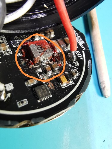

Just broke the SP36 blf Anduril driver :man_facepalming:
Is there any alternative to ordering another one from Sofirn?
Edit:
When prying it out my nail slipped (you can see the path the nail tip traveled next to T1616 chip) and messed up the 3 little chips and bigger one (FET?) - circled in the picture. The FET was like moved 2mm back so I corrected it and resoldered. The 3 little piglets I soldered back with a soldering paste and hot air. But after assembling some smoke went through the button hole. I desoldered 3 little chips and soldered them back manually with the soldering gun but now the driver is dead. No even button light.
What exactly you broke? μC? MOSFET? 7135? Or you broke the board in half?

Little ones are capacitors, big one is inductor. They are the passive components for a boost or buck converter (not sure which one the light is using).
This sounds like you accidentally created a bridge between parts, and when first turning it on it burned one of the Active components (probably controller, FET and/or LED).

Both and neither lol. Its for the usb-c charging and power bank function. The light is a fet+1, not visible in that photo
Looks like you list a piglet somewhere lol. Poor guy.
But ya, like he said. Thats the inductor and some capacitors. That’s all just for charging/power bank-ing. If you saw smoke when you put it back together thats a pretty good indication that something shorted and its toast. See if sofirn sell you another
