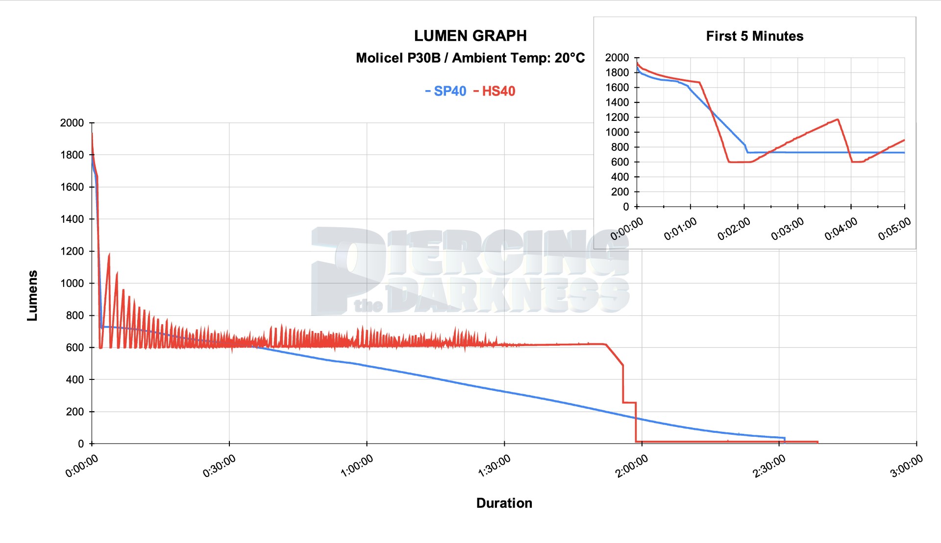

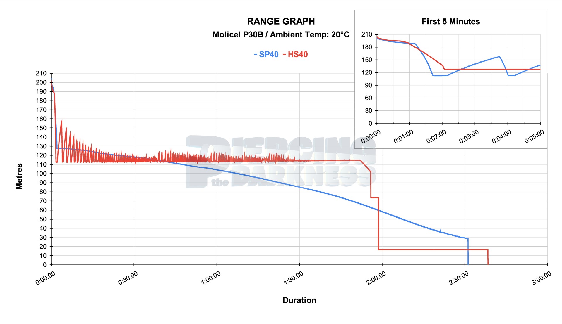

SP40: 1,200 Lumens / 134m Range
HS40: 2,000 Lumens / 175m Range
Measurements with Molicel P30B (ANSI)
SP40: 1,699 Lumens / 195m Range
HS40: 1,750 Lumens / 192m Range
Max Temp
SP40: 70°C
HS40: 47°C
I have a feeling Sofirn must be now using the XP-L2, because no old review measures over 1,400 at turn on. The website info, manual, and box sticker all state XP-L still though.

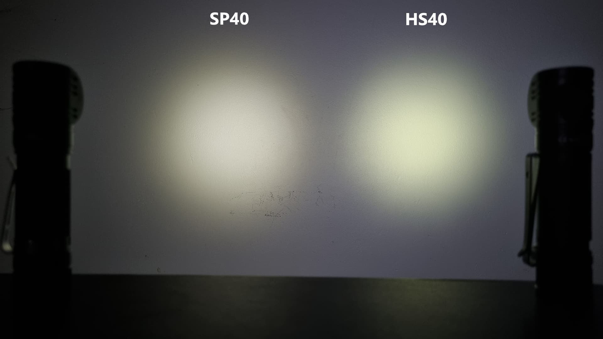

It has a really tight spot. No thanks. I always thought it would make a good EDC light for someone but not a headlight. I never use mine. I really disliked it while walking or hiking.

Yeah they tried to fix the very tight spot with the A model. So they got the spot wider but it is still a well-defined spot. I believe the spill is actually dimmer. And the overall width of the entire beam is still much narrower than many other lights and way too narrow for me. Only four lumen levels. Micro USB charging.
The sp40 showed me almost everything that I don’t want in a headlight.
It turns out HS40 is even more concentrated than SP40… SP40A has slightly dimmer but also even wider spill. The width of the entire beam as in spot+spill? If so I disagree on that, both have very wide spill even among headlamps. What does wonders is swapping the emitter to LHP531 - brighter, wider spot and nicer tint.
