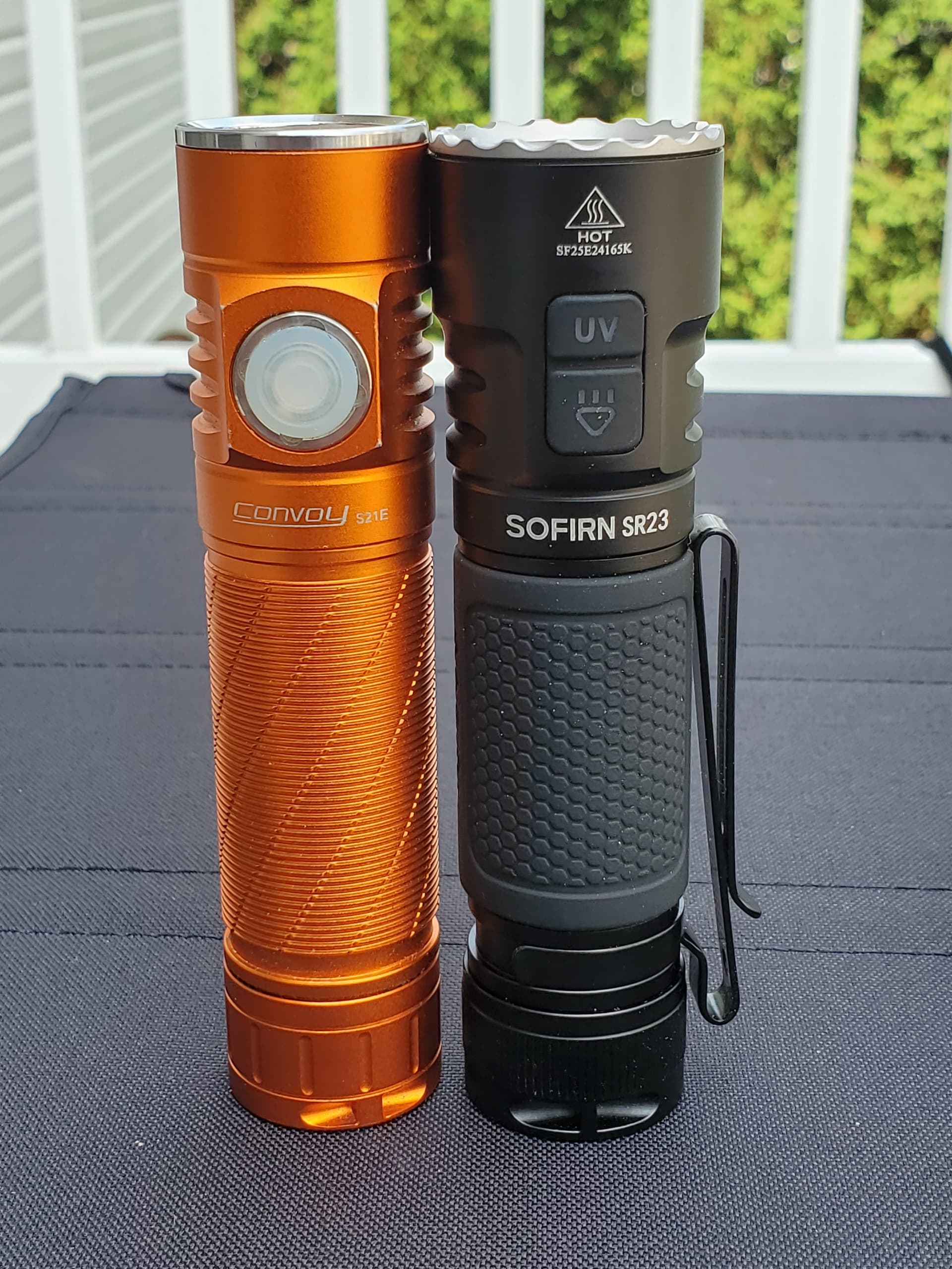

It is a easy to handle 21700 light that has dual channels controlled by a flat rubber capped e-switch with two separate buttons. The tailcap contains a nice strong magnet, also the light is driven by a boost controller as per the Sofirn website. Similar in form factor to the popular S21E so it is easy to hold and manipulate the side switch.

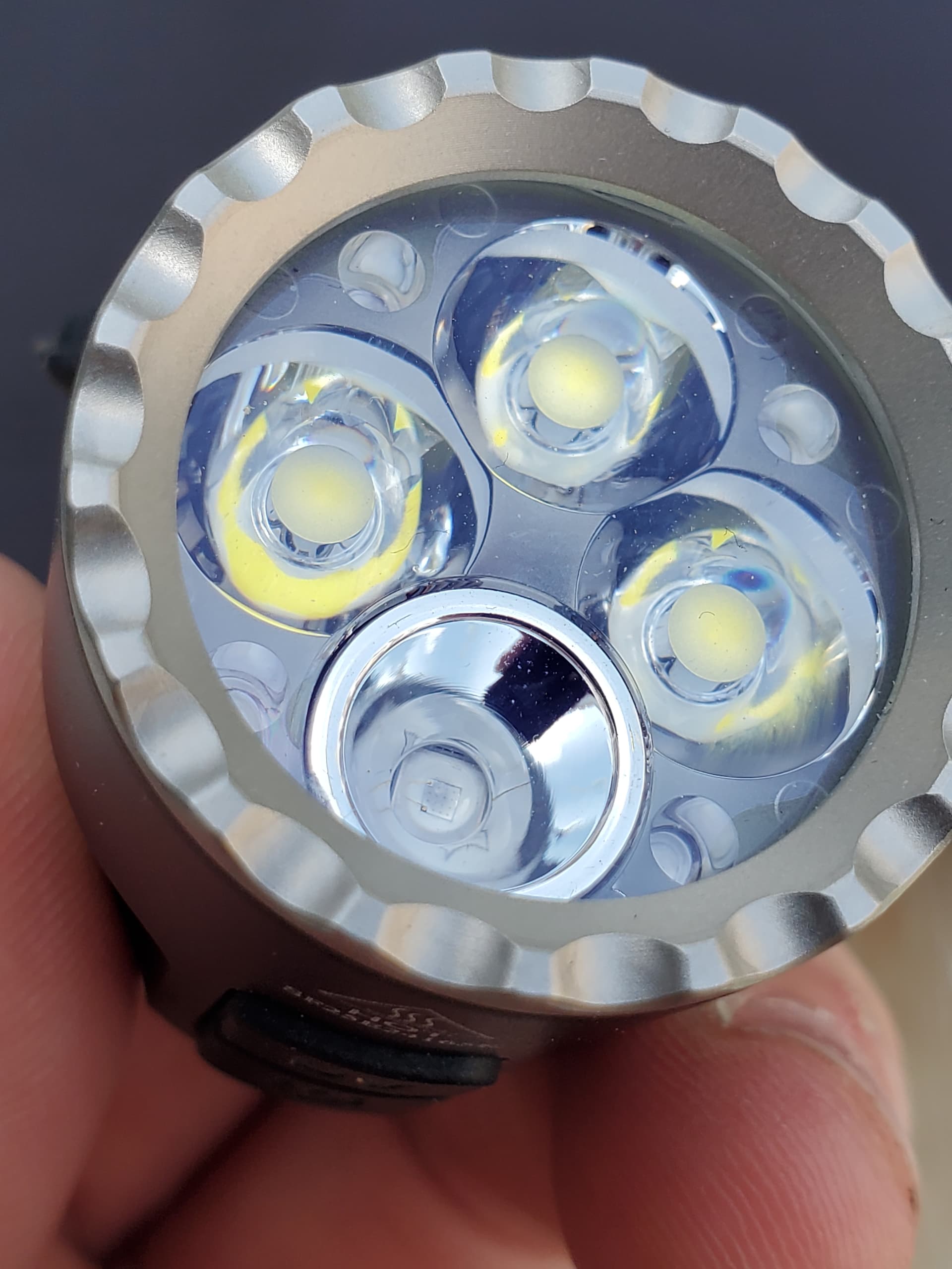

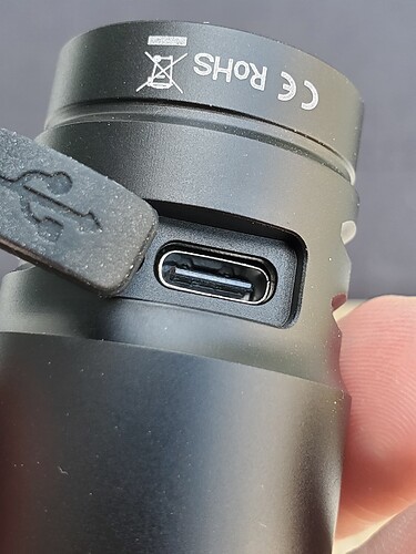

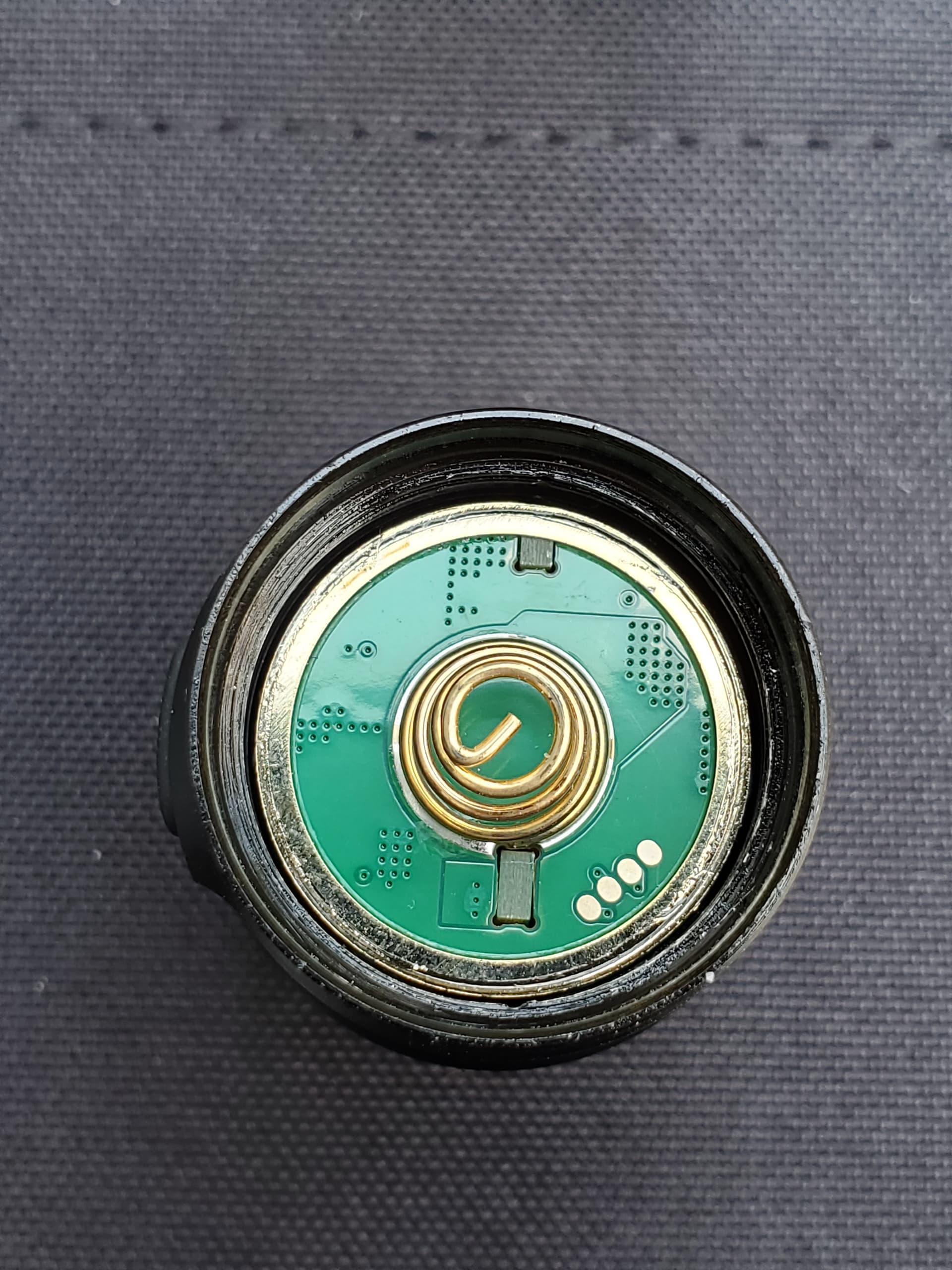

The fit and finish on the light is well done and the crenulated bezel is a nice touch if you like an aggressive front end. The USB charging port seals up well and is recessed in the light which helps to keep dirt and liquids out. The 3 main emitters are listed as TN-3535 sitting behind a very floody TIR and a 3W 365nm with it’s own reflector. The driver does flash pads for those that are interested.

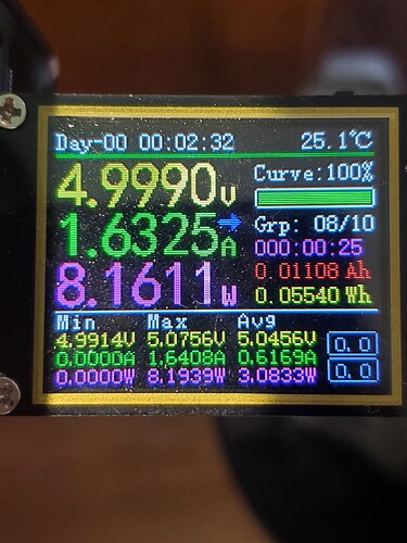

The battery is your basic Sofirn 5000mAh cell, the light charges between 8-10 watts and takes roughly 3 hours and 43 minutes to charge.

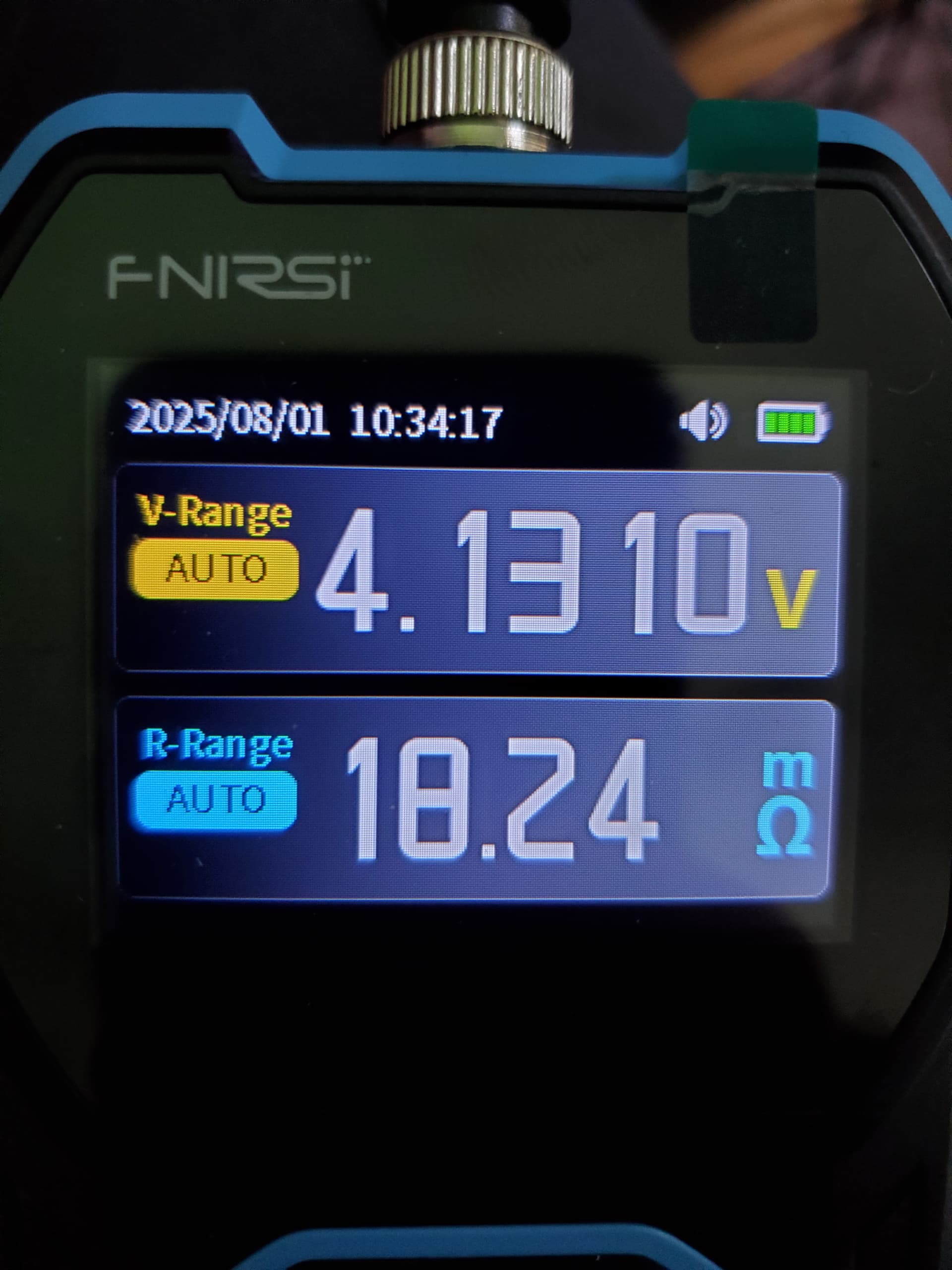

It is a unprotected cell and has decent IR
