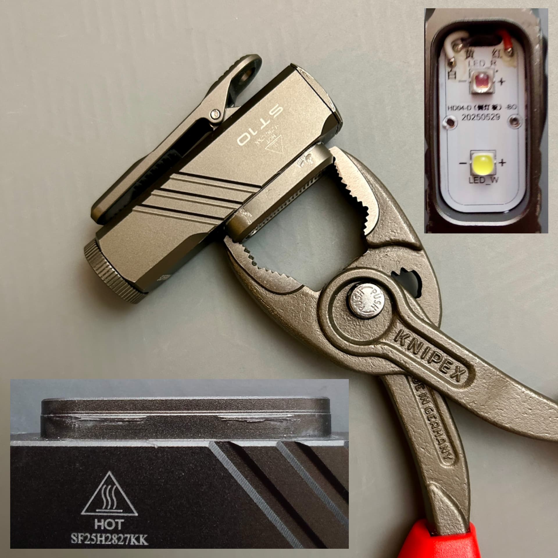

I wanted high CRI light from ST10 (I’m sensitive to CRI deficiency).
Removal of the bezels (the front one in particular) was rather hard. The side bezel turned out much easier.
I have decided to install:
  • 519a 5700K side light, for accurate identification of colors regardless of the ambient light, and
  • 519a 4500K front light, my most preferred CCT.
Hopefully Sofirn will one day offer High CRI variant of ST10.

Do bezels hold in place well after reassembly?
I did not take chances to find it out, therefore I applied the blue thread-locker.
Ohh… looks beautiful. The Knipex pliers. That model is still missing in my toolbox. :heart_eyes:
And the mod is nice as well, of course. :+1: :rofl:
They’re something, really. Seldom used but once needed I have nothing better. And I love the good tools (it’s the life-long affection, contrary to the flashlights which I got interested in few years back).
