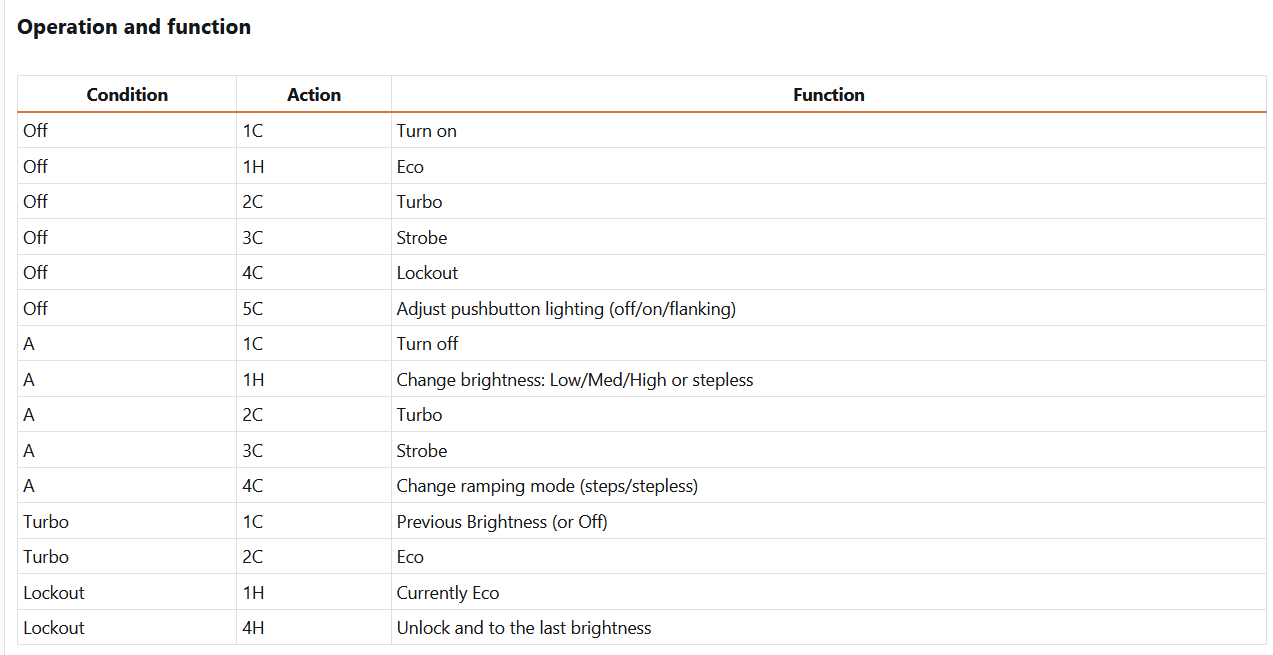

The light in the switch should be switchable.
I found this List for the UI:
The “A” means “On”.
It’s translated from german and it got a bit wrong: [Review] Sofirn SP33S | Taschenlampen Forum
4H means you click three times and then hold the button down after the fourth click. 1C means just a single click and then no holding down.
