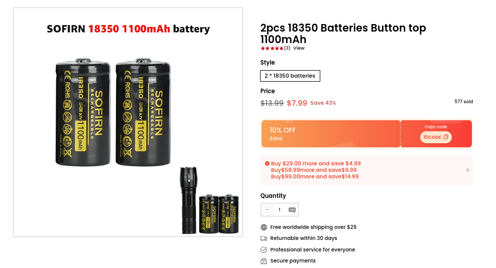

I find this discrepancy with Sofirn’s 18350 1100mAh cells quite concerning.
The product listing clearly advertises the battery as 1100mAh:
Sofirn 1100mAh 18350 Cells
However, the table on the same page states Nominal Capacity: 850mAh and Max Discharge: 5C. If we calculate 5C for the stated 1100mAh capacity, that would be 5.5A. For the 850mAh capacity, it would be around 4A. This is already a bit inconsistent.
To make matters worse, the datasheet you linked specifies Max Discharge Current: 1.1A (Standard Discharge Current: 0.55A )
This is a massive difference! A 1.1A max discharge current would make these cells unsuitable (and potentially dangerous) for many flashlights, especially high-drain models. Failing to prominently disclose such critical specifications on the product listing feels irresponsible and undermines trust in Sofirn as a brand. It’s essential for Li-Ion batteries to have accurate and detailed specs, as using them beyond their limits could result in overheating or even catastrophic failure.
Sofirn really needs to provide consistent, transparent, and accurate information about their batteries to avoid putting users at risk. For now, this discrepancy makes me question their reliability.

Those specs are for their old 900mAh 18350 cells that they no longer sell. I received two datasheets for both 900mAh and 1100mAh.

Thank you, @PiercingTheDarkness, for your reply. Unfortunately, this further highlights Sofirn’s shortcomings. They not only neglected to disclose the critical (and low) max discharge rate of 1.1A for their new 1100mAh battery, but also left outdated specifications for the discontinued 900mAh version on their product page. This mix of omissions and inaccurate information raises serious concerns about their commitment to transparency and safety, especially when dealing with Li-Ion cells where proper handling is crucial.
