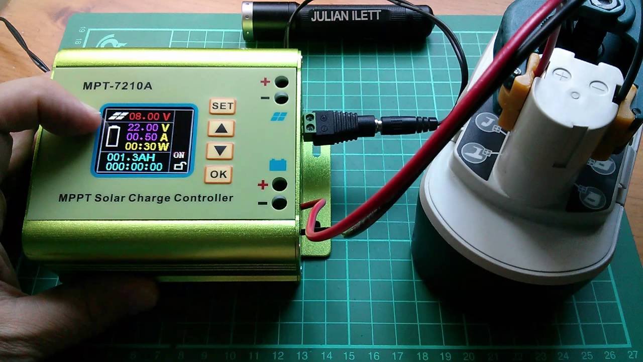

No worries , those little 7210a’s really are excellent for the price only issue is they are boost so battery bank needs to be higher voltage than panel but its ideal if you want to run a 24v bank with an 18v pannel
Wellp, while I am more or less fluent in read and written english language, the same I cannot say concerning spoken english understanding. I may have certain negative beliefs in this regard, forged at an early age.
Despite this, looks easy to understand. In red is the input voltage from the source (panels, wind turbines, mini-stellarator or mini-tokamak, etc.). In purple, with yellow V is the settable battery output voltage, and with yellow A the settable maximum output current. Below and all in yellow is output power in watts. In cyan colour figures battery capacity can be specified (what the point is right now I don't know), and a timer count whose point is also sort of pointless :-D to me. At the right side column I see a diskette icon with a two digit counter, I presume that is a writeable¹ array of memory presets…
I also have a small concerning doubt with the MPT-7210A, will it be able to support 16.6̅7 amps of input? I know I should stay below 10A at the output (for such I thing I would choose no less than a 9S li-ion battery for 200W of “18V” panels, and a minimum of 13S for 300W), but no figure I've found yet concerning input limit. The above Sunyima boost controller specifies 16.7A maximum input current, for example.
Generally the max current is regardless of voltage , as such most controllers will handle more watts at higher voltage
For example my victron is rated for 30amps , if i run a 12v battery bank my PV max will be 440Watts , but if i run in 24v @ 30 amps i can have upto 890w of PV and so on
the MPT-7210A is 10amps max input or output ,so you’d need to go 48v (13S) bank and run your solar panels in series to give 36v that way you never go above 10amp on the charge controller.

Well, I discern the MPT-7210A is then not really well suited to handle 2 × 100W “18V” panels in parallel, as they can give out in excess of 5.5A each.
Given this and considering I may go with up to 4 × 100W panels, the better affordable solution as I see it is to choose 2x (Sunyima) CTK-EV-300 charge controllers, each one fed by 2 × 100W panels.

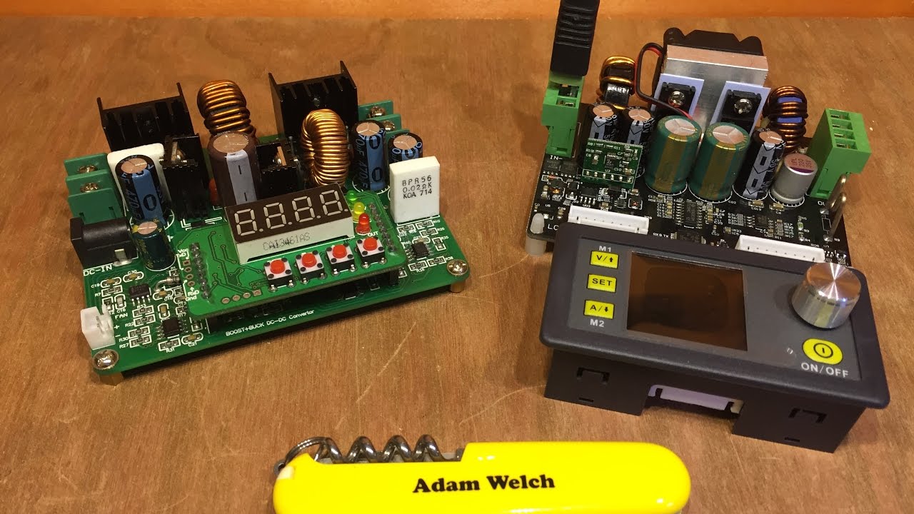

There are some very nice Boost buck up & down converters around you dont need to spend alot of money to get the power out of the panels, the issue is as i said earlier going to be safely charging lithium batteries
