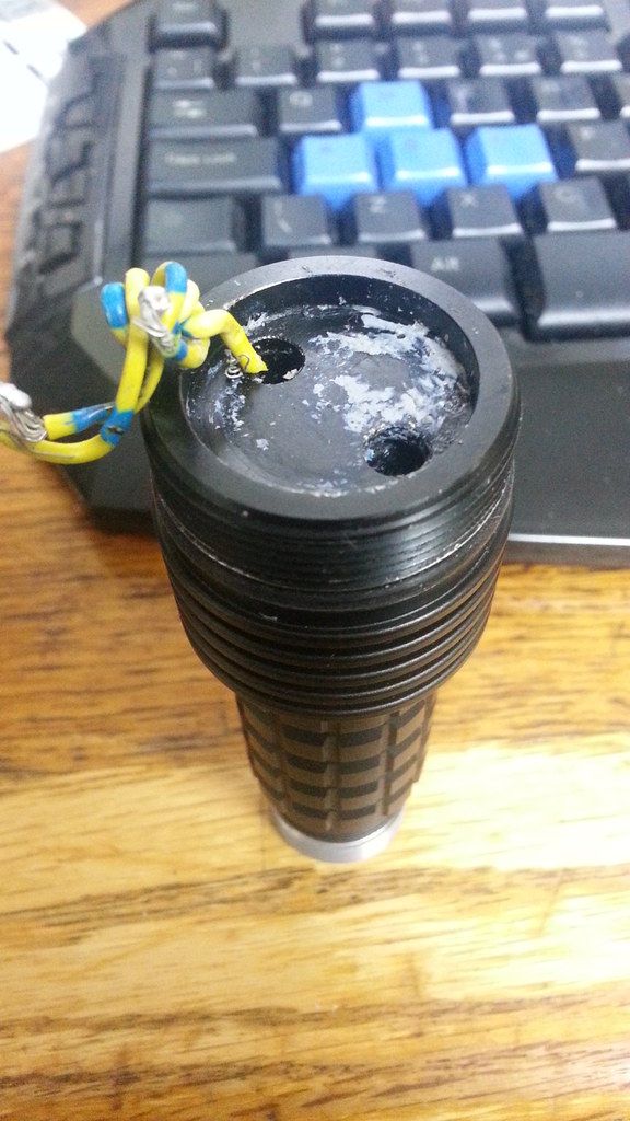

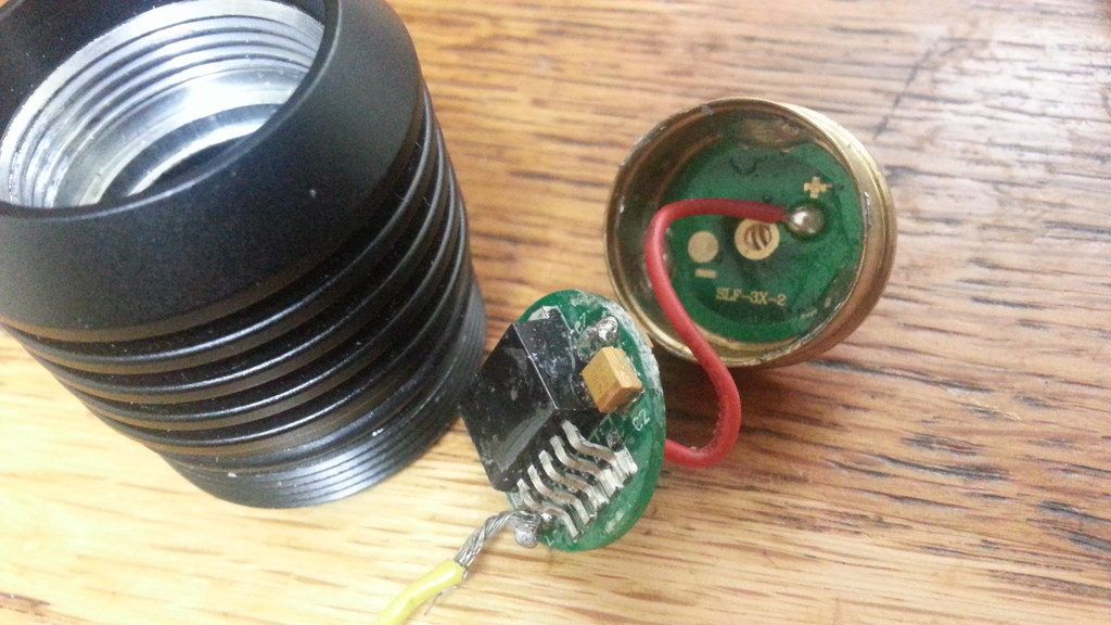

I just received a Solarforce M8 that I bough off eBay. It said the LED just needed replacing, but a wire has come off the driver. After reading the thread about removing the driver, it looks like this will be a driver and LED replacement.
Problem 1, what LED and driver should I go for? I have the extension tube, so it will take two 18650, maybe a 6v LED, such as the XHP50?

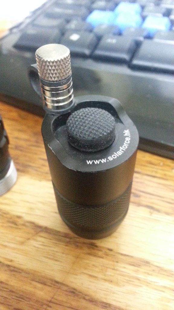

Problem 2, the switch is a little funny. Does it have a driver in there as well? I’m measuring 50ohm between the body and spring when on. Will I need to mod this as well?
I managed to get the driver out undamaged, I hope. I put the probe from my multi-meter through the hole under the spring, hooked it on the ridge on the probe and gave it a good tug. Seller said he’d had the pill out, but said it was threaded (possibly a misunderstanding).
I’ll add some new wires, an XM-L T6 I have spare and give it a go. I’m still thinking about a fitting a 6v LED (XHP50 or XHP70).
Looks like you managed. Shouldnt have driver in tailcap.
Fully working now, just 1A at the tail though. Tail is just a switch, I had my lead in the amp socket on the meter (glad I didn’t check the battery voltage).
Just trying to decide what LED and driver to put in it now. XHP50 and a zener mod driver looks like the simplest solution.
Bypass the tailspring and also bypass the driver spring if that model takes one. Really makes a difference.

What is this on the tail cap?
And why that tail cap I wonder? That’s not the one that comes with the M8.
I wondered the same thing. Apparently it’s connection for gun mounted switch.
