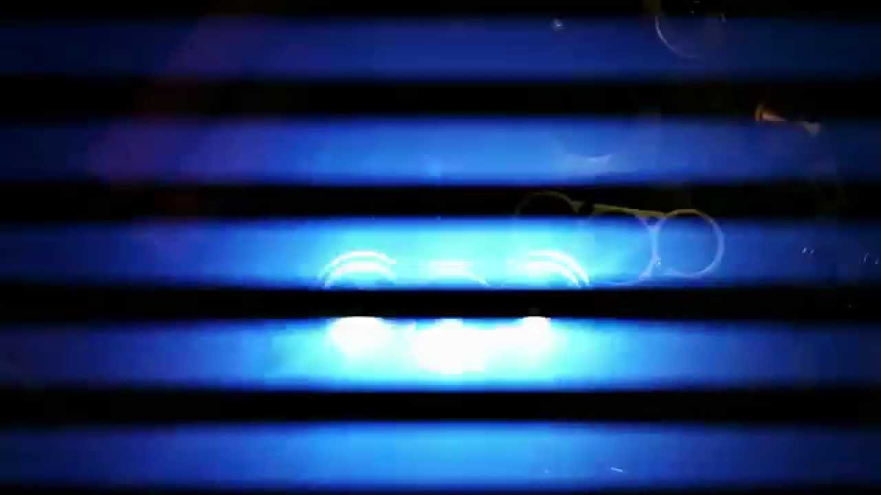

PWM is too low, as seen in the following video
