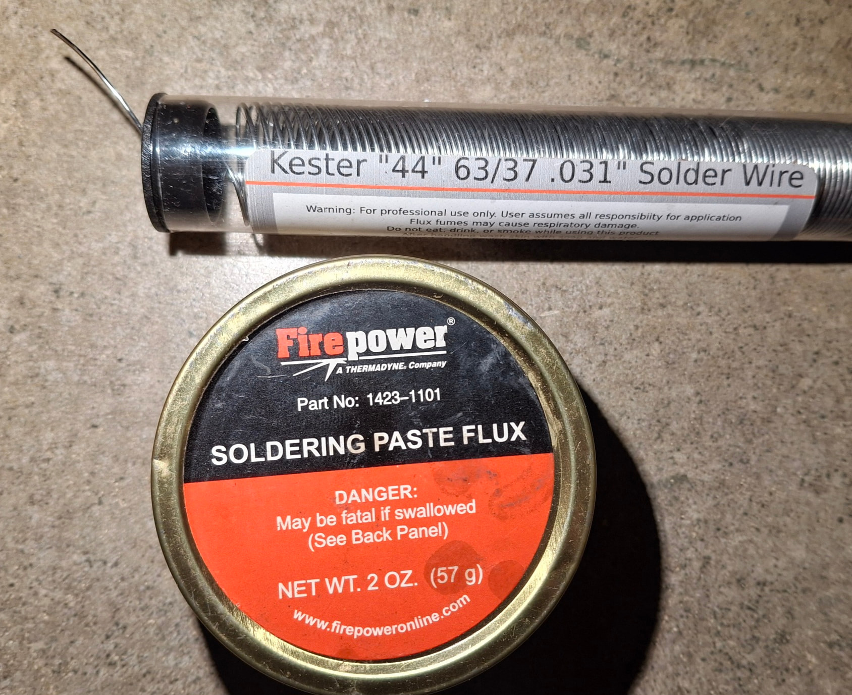

I use this FirePower stuff I got from two jobs ago, still haven’t went through half of it. It works well enough that I have to looked for an alternative.

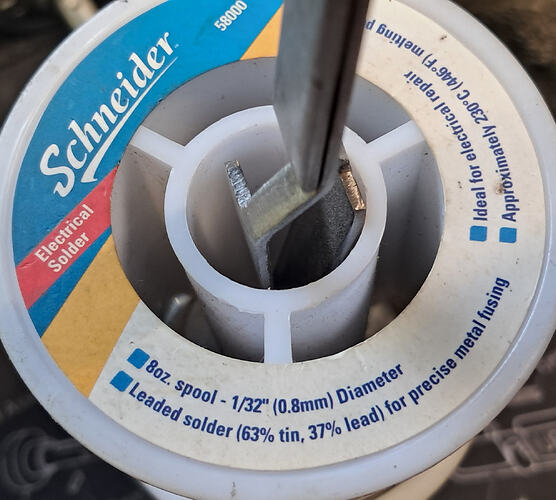

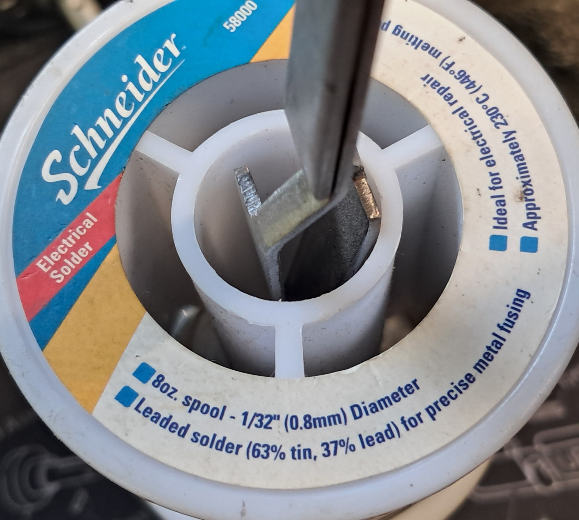

One thing that NASA soldering school taught me was to wrap a new tip in lots of solder, turn on the heat and keep the tip wet while it heats. Too often if you don’t do this the tip will oxidize and will then never hold solder properly.
I forgot to do this recently with a new tip. I ended up throwing it away. It was useless.
Exactly.
When I start soldering I always wrap the tip in fresh solder at a lower temperature, sometimes in between to, certainly if I solder on a higher temperature and the tip gets dry and discolored and most of the time when I’m done with soldering (for the day), again a bit of fresh solder on the tip, clean the exces off and it’s ready for the next time.
