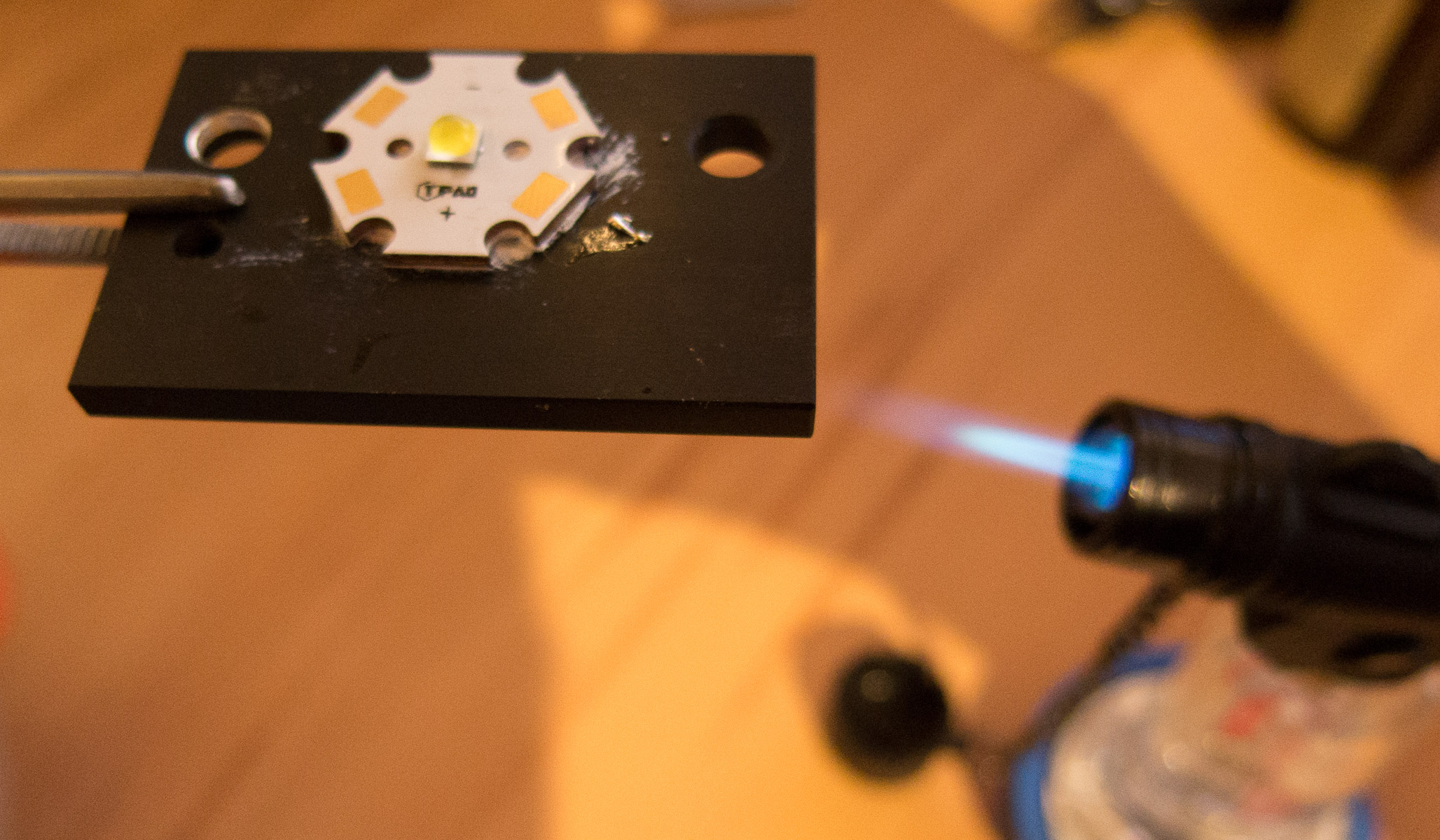

Seems not many of you paid attention to this. I've renamed the thread (supressed “batteries” after “Soldering”) because, well, Sn42Bi58 can make pill soldering a much easier task. Don't you think?
Reflow leds with it for a “free” overheat protection. LoL!
Soldering pill with a gas burner it doesnt make much difference heating to 100 or 200 dC,
Just apply solder paste or some pieces of solder wire on the pill and put the star on top
Its not much different from teflowing LEDs on an aluminium plate you heat up with a gas burner
