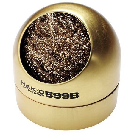

I was replacing a lot of ruined tips untill I got a brass mesh tip cleaner.
Best compliment to any soldering iron imo.
Cleans the tip without destroying the iron layer or lowering tip temp like a damp sponge does.
I’ve been able to keep even the cheapest tips in great working order by cleaning
them frequently during use (with brass mesh), keeping them tinned, and not letting them sit idle
while hot.
After a couple of years, something’s made my soldering iron suddenly much less effective despite using the brass cleaner before and after every time I touch it to something. I’d missed the trick about leaving a blob of solder on the tip when not using it, though. I’ll do that from now on.
