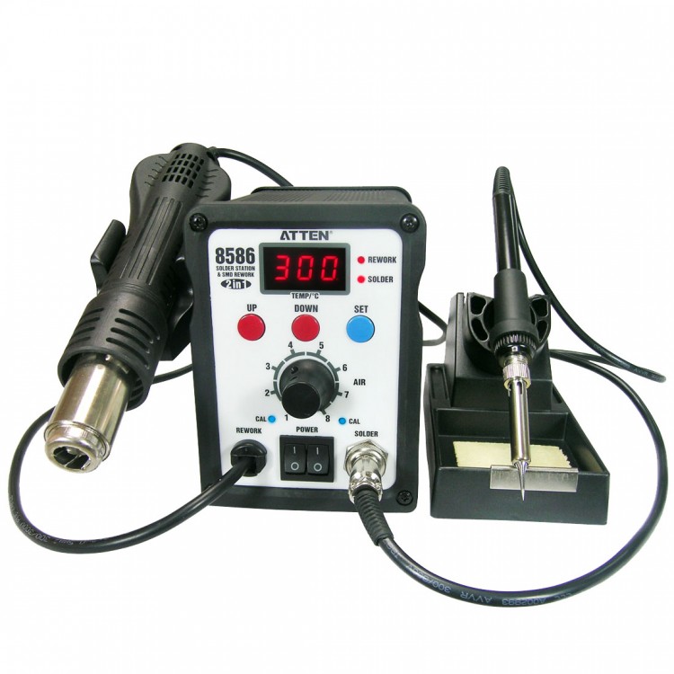

I found a rebranded/generic version of this on ebay, goes pretty good. The hot air gun is great for shrink tube and heating up stuff, haven’t used it for actual rework yet.
