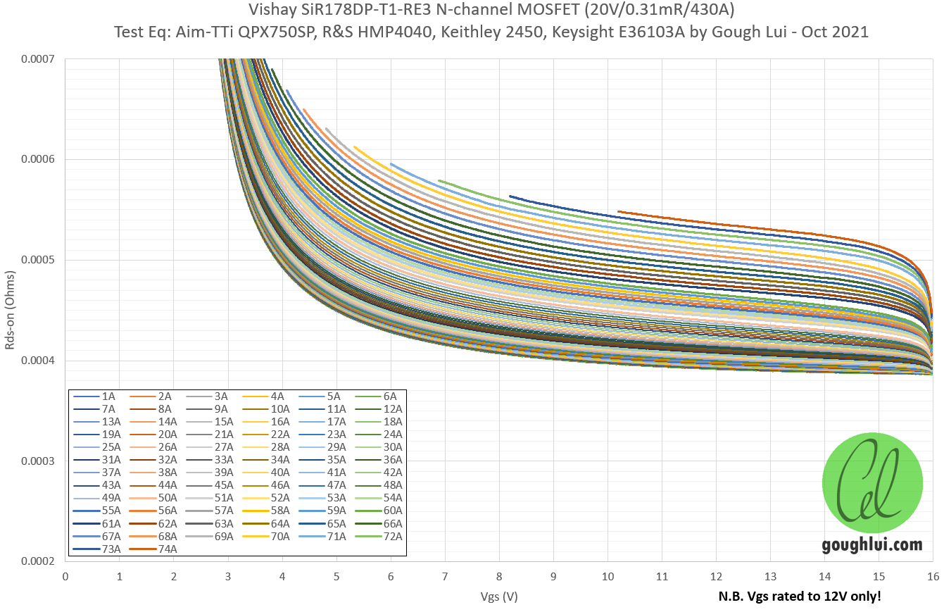

Get some SIR178 next time you make an order, SIRA00 and other FETs used in these DD driver are often 4.5Vgs rated (logic level) and the ON resistance increases quite a bit below that at 1S li-ion voltages, SIR178 (2.5Vgs rated) has very low RdsON even at 2.8Vgs, on top of not costing much.
The A00 is rated at decimal point levels in the area I use a flashlight. (3.5-4.2V)

Thanks for the heads-up on the 178, will check into it. Not modding lights much anymore as there are new interests gobbling up my time. Although lately my buddy has been asking a lot… lol. Bored old men. Whatareyagonnado?

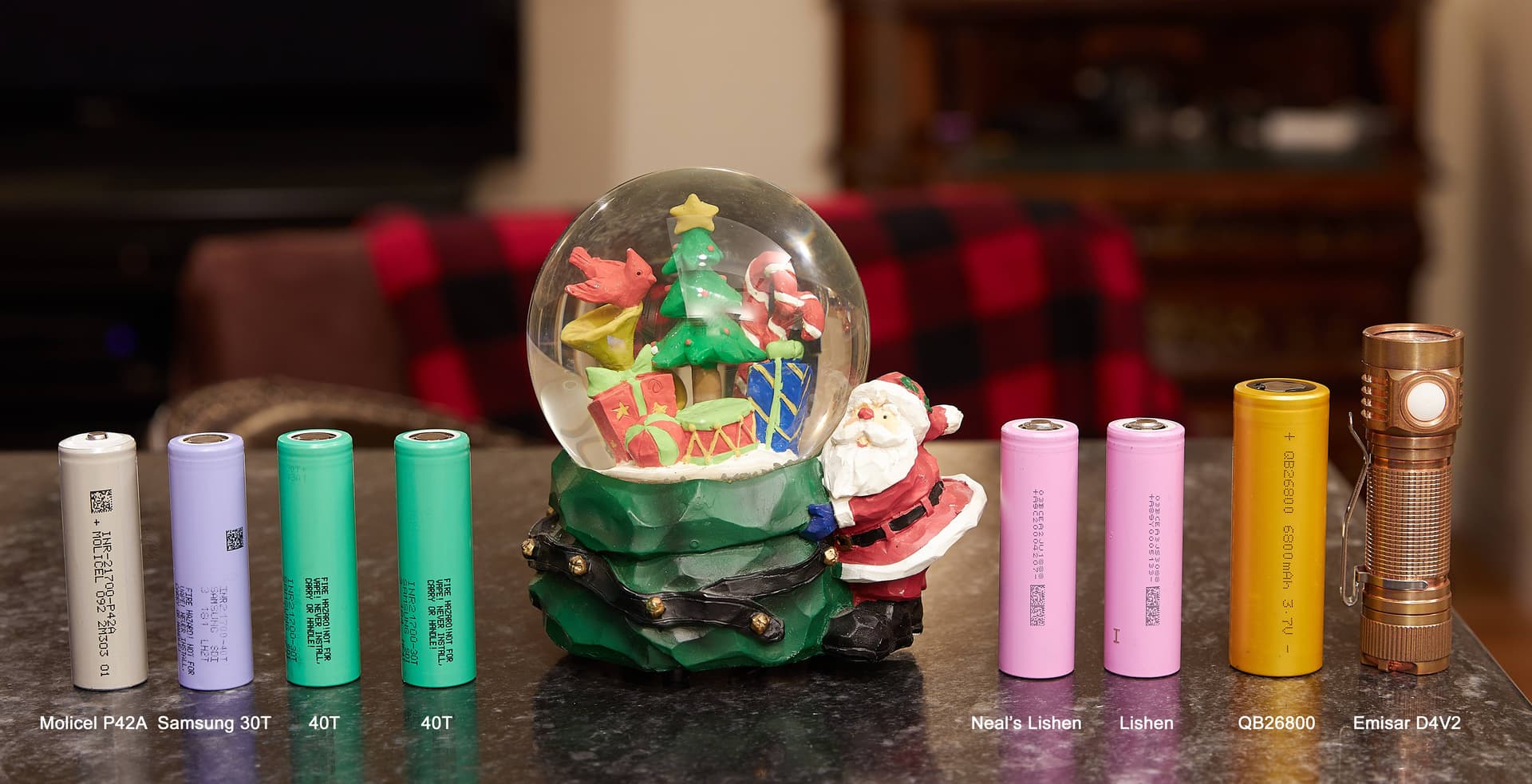

Don’t know IR. How could I tell date code? It’s in the picture below. I got it from Neal for my Haikelite HK05 just a couple months ago.

It doesn’t look like genuine Molicel, I had it happen before that some “P42A” batteries I bought from chinese sellers ended up at less than the minimum specifications from Molicel, likely were rewrapped 4000mAh 35A lishens.
The font size doesn’t match up with the Molicel P42As I bought from li-ionwholesale and illumn, and the wrapper is supposed to be slightly shiny. I recommend getting a different one to be sure it’s legitimate.
The date code for Molicel is LYMDD SS (discard the 1st digit “2” - not sure what it means)
A=2010, B=2011, C=2012, D=2013, E=2014, F=2015, G=2016 etc. If it was genuine, the cell is from 2022-03-03.
Thanks. In real life it looks pretty close to this one from li-ionwholesale. Neal’s after-sale service not exemplary but I don’t think, and hope, he’s not selling counterfeit. If true would be disappointing.
