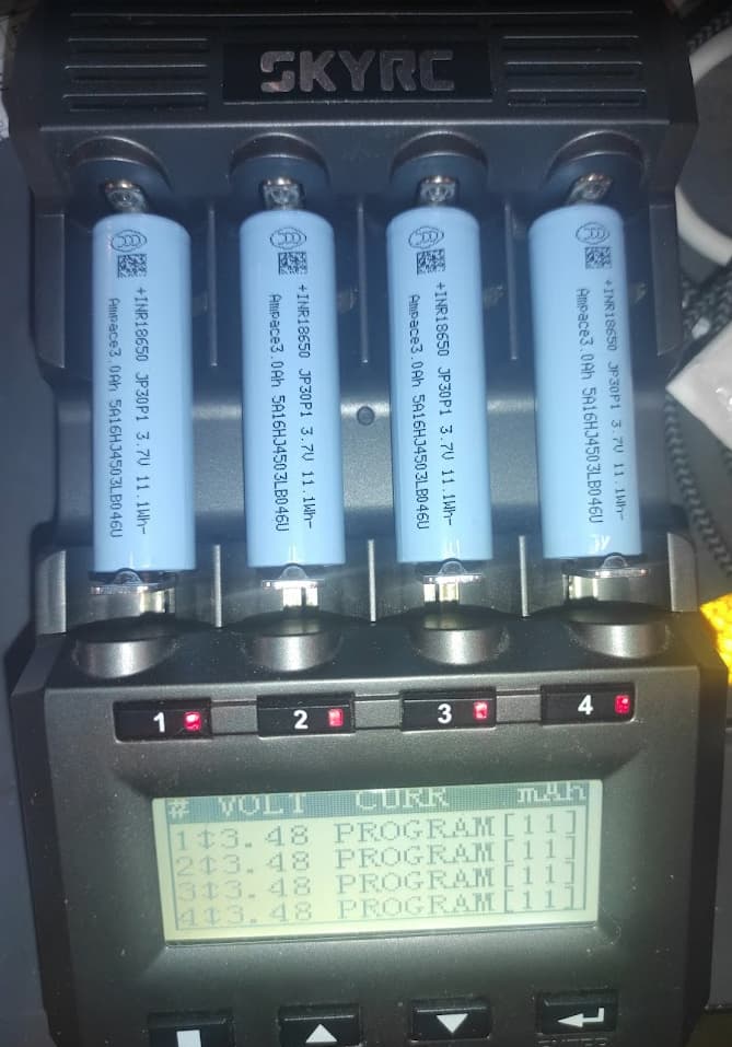

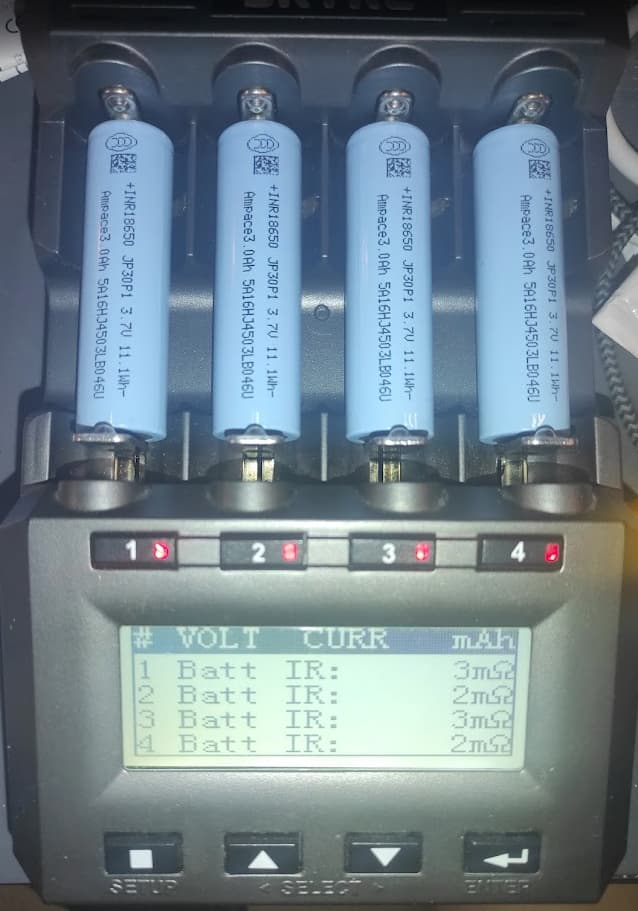

Just got a nice set of 4x JP30, shown below already loaded in my SkyRC MC3000 (could not load them in my preferred charger, the Gyrfalcon S8000, given their positive terminals are way recessed and only the MC3000 was able to make reliable contact, thanks to its terminal nubs):
For what it’s worth, bought them off AliExpress (I know, I know – but was the only way, tried to buy them off @vapcell-sales18 but after a promising start, they stopped answering my PMs, so I just gave up). Cost was just under $5 each, including shipping and all discounts, and took about 38 days to reach me here in Chile.
I’m really impressed with their low IR: 2 to 3 mOhms, less than half the already low 6-8mOhms I see with my Molicel P30Bs (and I understand it has to be that way for them to be able to provide the constant 56A they are supposed to provide with temp cutoff at 80C without burning down the house, but color me impressed anyway).
What I’m not impressed with is the low voltage they came at: 3.48V is way too low in my book, I’m used to see batteries being shipped at at around 3.7-3.8V (ie, about 50% SoC), the only time I saw a battery coming in from a seller at such a low voltage were with the Sony/Murata VTC6 I bought at NKON a couple of months back (these came in at 3.49-3.50V). So I must ask: is shipping with such a low voltage (and presumably such a low SoC) normal with high-current batteries?
The other suspicious thing is the wrapping: not OEM as I’ve seen here and elsewhere, but full Ampace labeled with logo and all, including a QR code (which seems to be fake, since it decodes to just “5555555” – that’s it, 7 times 5). Dimensions also look strange (as in, way too small) at 16.9mm diameter and 63.9 length.
Looked for an official datasheet online but could not find it – albeit it surely exists, as part of it is teasingly displayed at the DIY500AMP web store page mentioned above, so the best I have to go on is the specs table shown at that same page.
Planning on doing a couple of CDC cycles to test them and try to determine their true capacity, charging up to 4.2V@1.5A and 75mA termination, and discharging down to 2.5V@0.6A with just voltage cut-off (which as far as I was able to determine, are the standard Ampace-recommended charge/discharge parameters for the JP30).
Will do it tomorrow (it’s late night here already and I’m definitely not going to leave those batteries operating unattended), so if any of you can offer any tips, suggestions or warnings, I will be sure to check this thread again tomorrow before starting the tests.
TIA, and one way or the other I plan on posting my results here when I have them.

3.48V is actually excellent.
The lower the voltage, the better the calendar life :slight_smile:
Thanks for the tip, but are you sure? I thought that anything too far (either below or above) 50% SoC, which would be 3.7-3.8V, would mean damage over time in storage for Li-Ion batteries…
Yes. Staying closer to 50% is better for cycle life, but not for long-term storage.

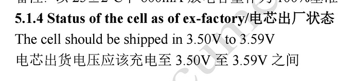

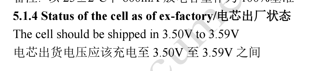

From their datasheet
Thank you for this! Also, congrats on your finding the datasheet, I tried to but couldn’t find it anywhere. Your Google Fu must be really strong!
So according to my MC3000 measurements, my JP30s at 3.48V were just a bit (0.02V) below the manufacturer-recommended shipping voltage range (3.50-3.59V). Much better than if the recommended voltage were 3.70-3.80V…
Since it has been a long time (almost an year) since I last used my MC3000, it was very probable that it lost its calibration, so I just double checked with my UT210E DMM, and again all 4 batteries were at exactly 3.48V, so I guess that is it.
Thanks again @Qubeet and @BlueSwordM for your reassuring comments re: the JP30 shipping voltage . Gonna start the cycling procedure now! :+1:
Dug a bit deeper and found it on NKON.NL, available directly from the “Documents” tab of their product page: https://www.nkon.nl/en/amfile/file/download/file/739/product/5848/
OTOH, the PDF states “NOT final version” in a watermark in every page and that is hardly reassuring… Was anyone able to find a different version of this document (or actually, any official document from Ampace regarding the JP30 detailed specs)?

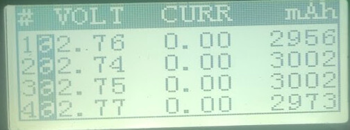

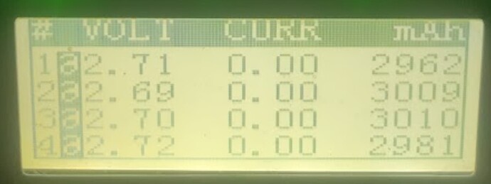

Discharge part of the first cycle done, and measured capacity was pretty much nominal:
Not bad in my book, and WAY better than my previous high-current battery purchase (4x Molicel P30B also from AE, which clocked at around 2500mAh/battery).
Will give it a couple of cycles more in the MC3000, then put it in my drone and test continuous discharge at 10A, and and then post the final results here for y’all.
But so far it looks promising, certainly better than I expected.

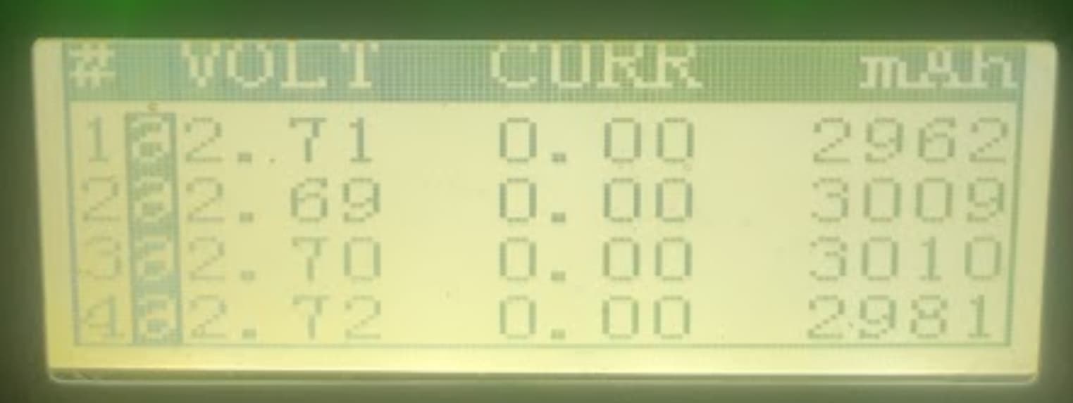

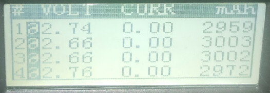

Second and third discharges also looked promising:
Now I’m recharging all of them at 3A (the maximum current the MC3000 is capable of providing) and when it’s done, will do a high-current discharge test at 10A on my drone and see how things go – will keep y’all posted.
