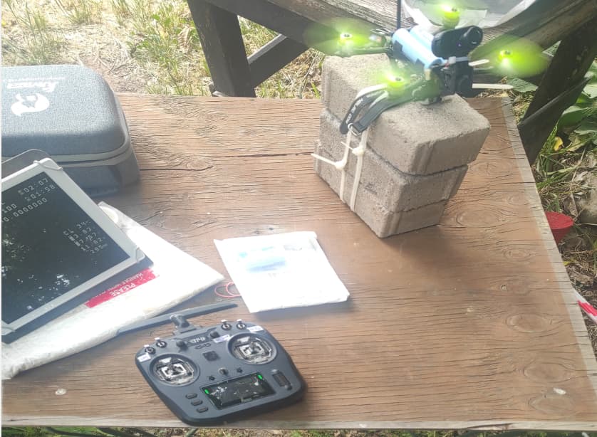

My test “rig”:
From left to right: the tablet where I run the VRX software showing (and recording) the image from the drone’s OSD; the RC transmitter I use to start/stop the drone’s motors and control their speed, and also to receive and record flight telemetry (including battery voltage, current, and accumulated mAh) back from the drone; and finally the drone itself, strapped with two separate thick straps to the stack of three concrete bricks shown right below it (otherwise with 10A going through its motors, it would go up and try to climb to the Moon). The data below was compiled from the recorded OSD data, and confirmed with the transmitter’s recorded telemetry.
