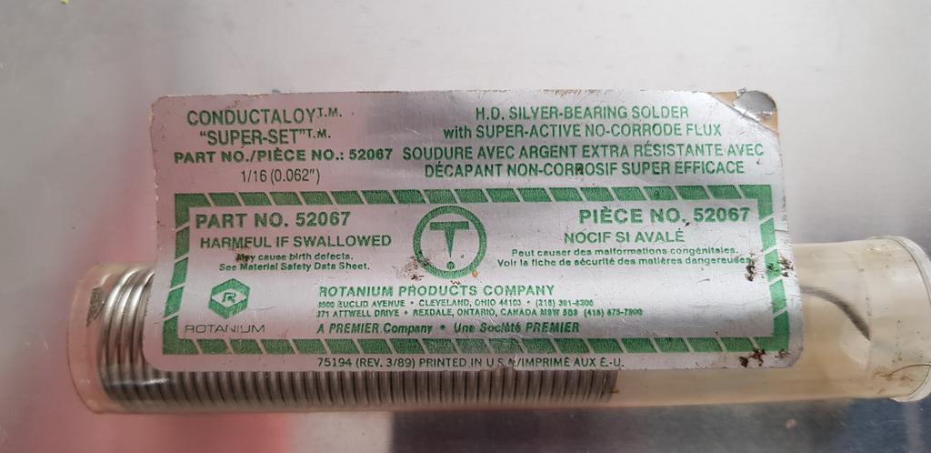

I have 3 rolls of this stuff (my secret stash). When we cleaned out an old workplace i found this solder and i could´t throw it away :innocent: . Have to get more information about the exact composition and the flux they use. It is my first choice when soldering springs and big stuff. It is wetting like crazy. If my usual solder is not working i get this out of the box. To bad it is very thick. Not for soldering fine stuff.
